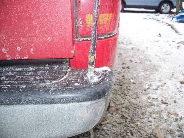

    cb antenna mount without drilling holes? Want to fab a mount to the frame and up between my rear bumper to run a firestick, any ideas??
  14. Dec 25, 2008 at 6:39 PM
    The_Hodge
    The_Hodge Volunteer Moderator
    Apr 27, 2007
    #1432
    31,633
    SC
    15 Lariat Sport 5.0L
    Seeing the third gen section forced me to get a Ford...
    check out toy4life's cb setup on his rear bumper...

    here's how i mounted my "Lil Will" magnetic mount antenna. took off the 3rd brake light assembly housing, using a dremel tool i notched a spot on the backside of the assembly making enough room for the cable to pass through. i also had to make a small notch inside the cab right where the assembly goes but just a small one.
  16. Dec 25, 2008 at 6:43 PM
    #16
    pittim
    pittim mittip backwards
    May 28, 2008
    #6939
    18,778
    Pennsyltucky
    Boujee Prius
    It’sa Lexus, boogie woogie woogie
    I copied his mount. You need to drill through the bumper though.
