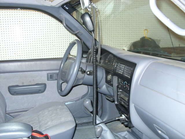

    I know it's not a magnetic, but in the event you decide to change your mind...

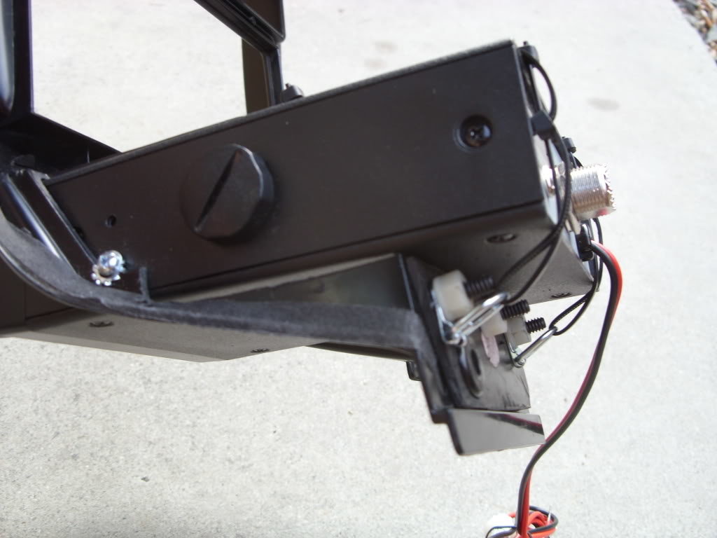

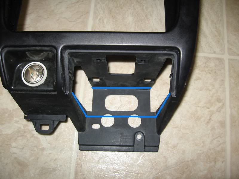

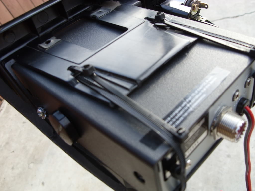

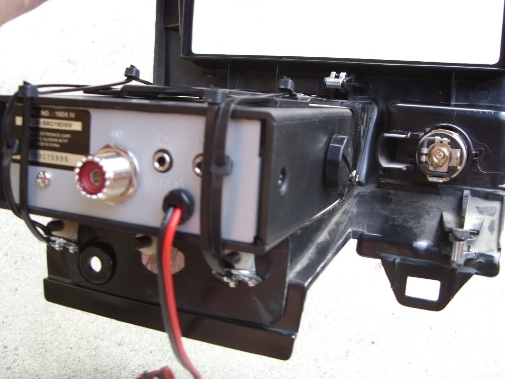

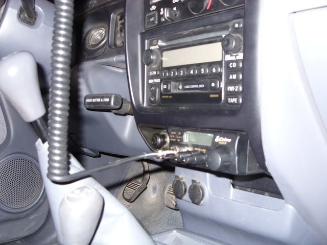

    My Cobra 19 DX IV is mounted in the ashtray location as well.
    Here's some pics detailing what I did...
    In the 2nd picture...
    the plastic material inside the blue lines
    will need be cut away (removed)
    It will be a somewhat permanent deal once done.
    I used plastic zip ties in these pics...
    but have since replaced them with velcro (type) zip ties.
    I also used a heat gun an put an indentation
    in the heater duct.
    Along with doing that... I used a 90* coupler
    at the backside of the cb.
    My antenna cable is routed along the floor (under the carpet/seats)
    and exits out the back of the cab
    at the lower rear passenger side grommet.
    Maintain the total cable length utilizing 3' increments.
    Think I used a 15' cable...
    but had to run it around the cab some to lose the extra length.
    Don't let the cable coil over on itself.
    My Lil' Wil' antenna is mag mounted on the roof.
