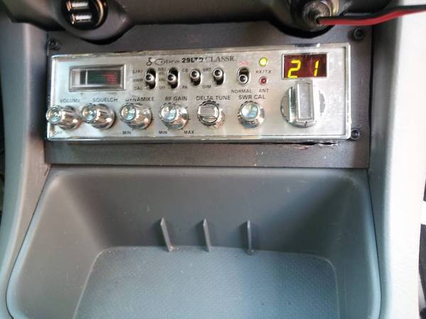

    Thanks man, it was a nightmare and im ecstatic that it worked out! put a shit ton of time into it.
    if you do this good luck, and be patient man!
    Before:
    During:
    After:

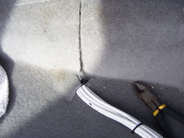

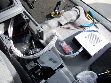

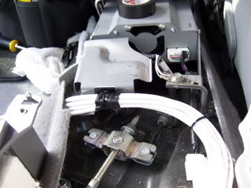

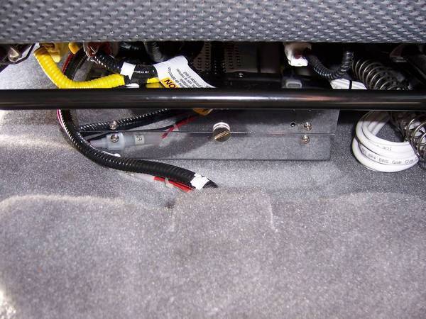

    Nice job! this is what i want to do. Just dont know how you ran the wires to the faceplate through the console
  13. Jun 10, 2012 at 10:15 PM
    #53
    Bengland25
    Bengland25 Never Forget! 343
    Nov 17, 2011
    #67192
    1,937
    Bradley
    Southern California
    09 Tacoma TRD
    MB Chaos 6 17" wheels, BF Goodrich All-Terrain TA/KO LT265-70R17, Anytime Fog Lights, Anytime Backup Camera, Bed Lights, Tailgate Lock, Light bar with 3 Hella 700FF's, Realtree Camo arm-rests, Anytime DTRL (With Switch), Blue Seas Fuse Block and Circuit Breaker, Custom Bed Light-Bar, Cobra 29 LTD Chrome, 4' Firestik, Masterlock Hitch Key Safe, Bed Storage Compartment Locks, Custom Shovel Bracket Mount, Flag Pole Mount (RED SOLO CUP FLAG!), DIY Washable Cabin Filter, URD MAF Cal., Homelink Garage Door Opener, Volant CAI w/ Ram Scoop, AeroTurbine 3030XL, URD Short Throw Shifter, Custom Satoshi, Blitzpro 21S, 2 Blitzpro 6LZ's, Blitzpro 6D, BAMF Sliders
    Check out these pictures and see if they help out. I cut the carpet on the floor board and ran them through the whole center console. PM me if you need more help alright buddy.
    :thumbsup:
    BTW you cannot even tell the carpet is cut once the seat and center console is installed back into the truck!

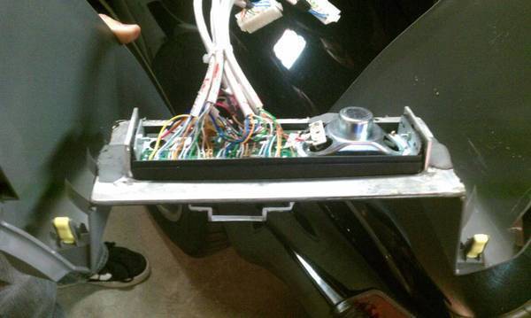

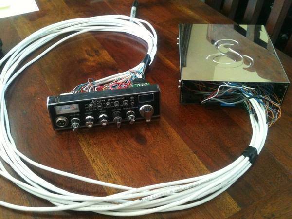

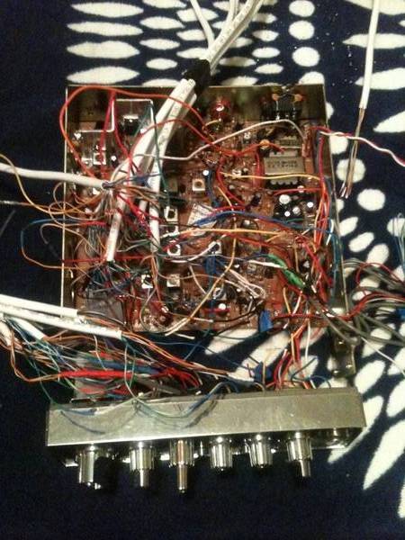

    so in this step did you just cut and re solder?
  17. Jul 28, 2012 at 6:34 PM
    #57
    DDD
    DDD [OP] Shine bright like a hymen
    Mar 6, 2009
    #14416
    2,274
    Derek
    Santa Clarita, CA
    06 DC 4x4 TRD Off-Road
    Yep. Just cut that ribbon. Stripped the wires and soldered in longer wires.

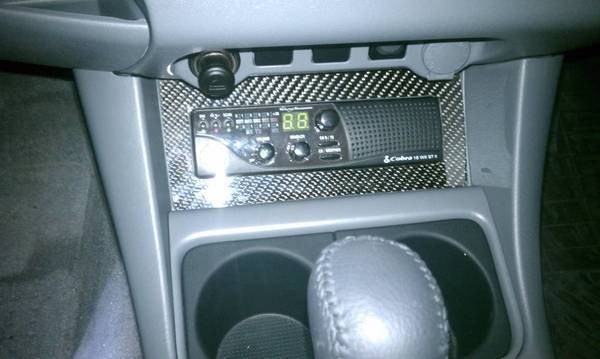

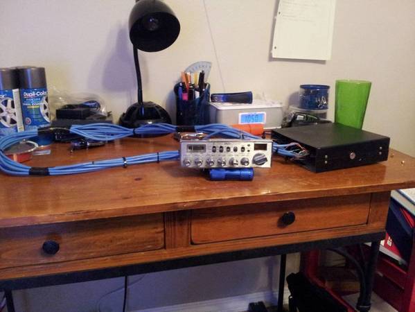

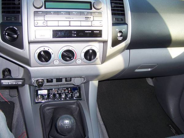

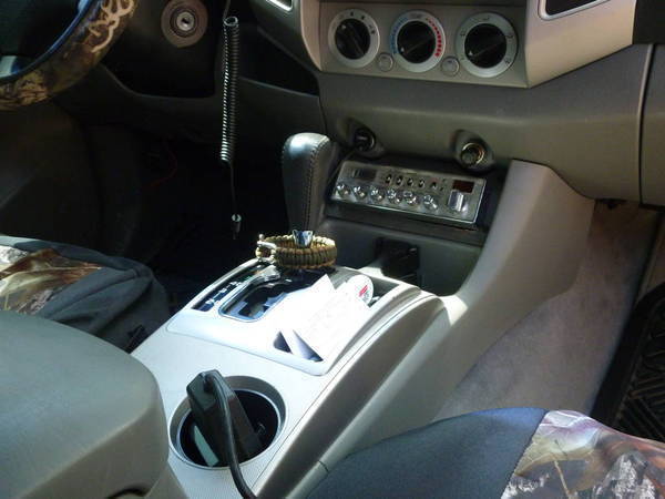

    Here is my take on this awesome idea!
