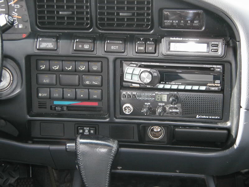

    Not in the pocket, rather in the DIN itself. I'm more concerned with the electrical hookups needed for the rear speakers. Like this FZJ80:

    I dont think the output circuit in your CB would do well driving heavy-magneted stereo speakers. You could remove them and wire in two properly wound and magneted communications speakers which your local Radioshack should still carry for a nominal price:)

    Yeah I know that would be a problem. I just don't know how the CB outputs its audio. I could build a small amplifier for it, that way my degree gets some use. I'm just not very familiar with the audio out of a CB and its inner workings.

    Should be in the specifications under audio output:) then you'll see exactly where you're at. It should be around 2-4 watts @4 or 8ohms. Then you check the minimum input on those speakers -if it exeeds (this is where I came in) what your output is, you'll overload the audio circuit over time. I'm asuming those speakers you have are high output types.:)by the way you could simply connect an amp inline to the external speaker jack-same minimum input rules apply as above>)
