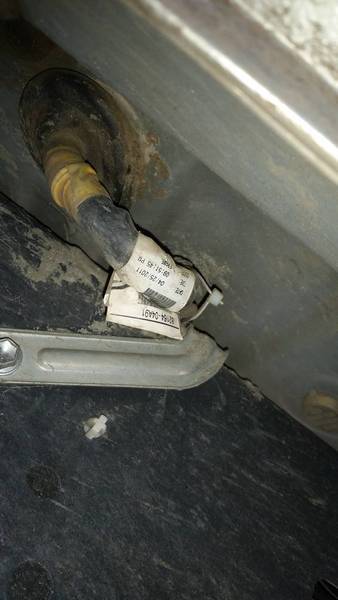

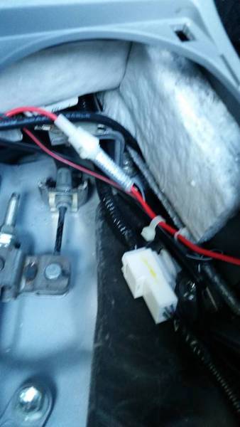

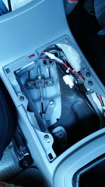

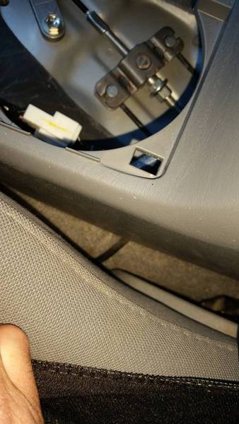

    Ill take some pic when i take lunch. Hopefully they will help. For that question. from the center console I went underneath it went out the side of it and the driver side I went in between the center console in the seat and ran the CB wire underneath the carpet flap, this opens up underneath the seat like we're the air conditioning duct comes out from underneath there I went down to the ground black grommet and pierce through it

    [​IMG][/url][/IMG]
    under truck. Drivers side.
    [​IMG][/url][/IMG]
    under drivers seat.
    [​IMG][/url][/IMG]
    In between the console and drivers seat.
    [​IMG][/url][/IMG]
    [​IMG][/url][/IMG]
    Center console

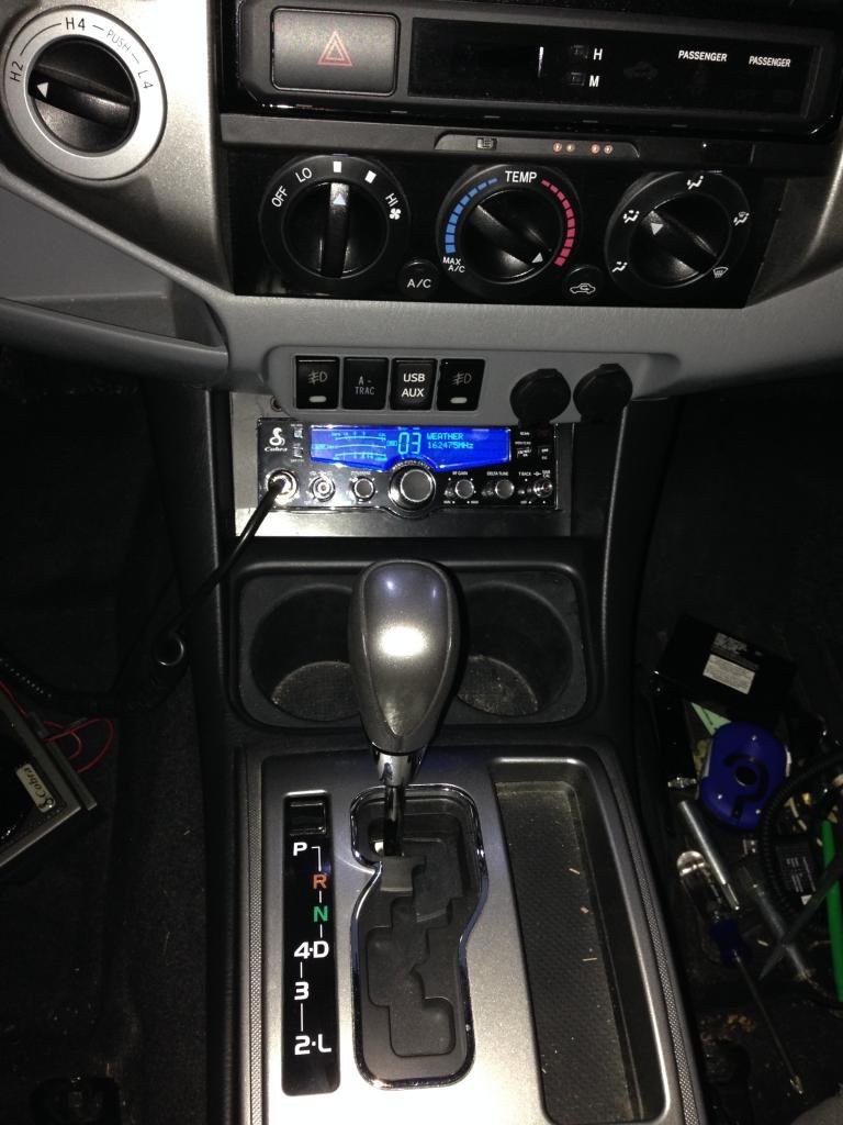

    How adventurous do you want to be with wiring to get the radio in the front pocket?
    This is my setup.
    I followed these two threads:
    Thread 1
    Thread 2
