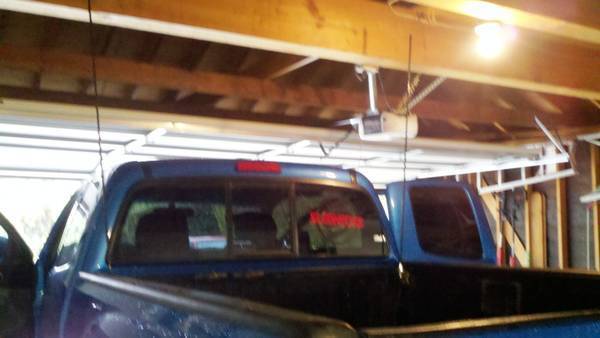

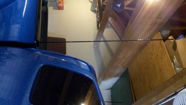

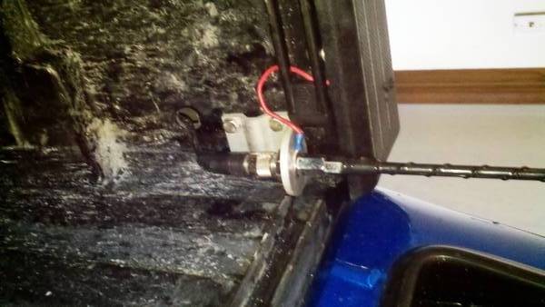

    Here is a pic of how/where I mounted my antenna and the mount I used. I didn't have to drill any holes on the truck at all, just trimmed up the plastic bed cap a little to clear the bracket. It's techniclly ground to the sheet metal of the fender and any metal the fender touches by just screwing the coax to the antenna mount. I didn't need to run a seperate ground wire.
    I did drill a second hole in the bracket so I could use another mounting bolt. That bolt goes through the hole/slot that is already in the top of the rail slider. A 3/8" bolt fits in that slot perfect.
    My SWR's are flat. The bracket I'm using is not as beefy as I would like and I'm going to make my own bracket out of 1/4" steel and a little wider for a more stable/rigid platform.
