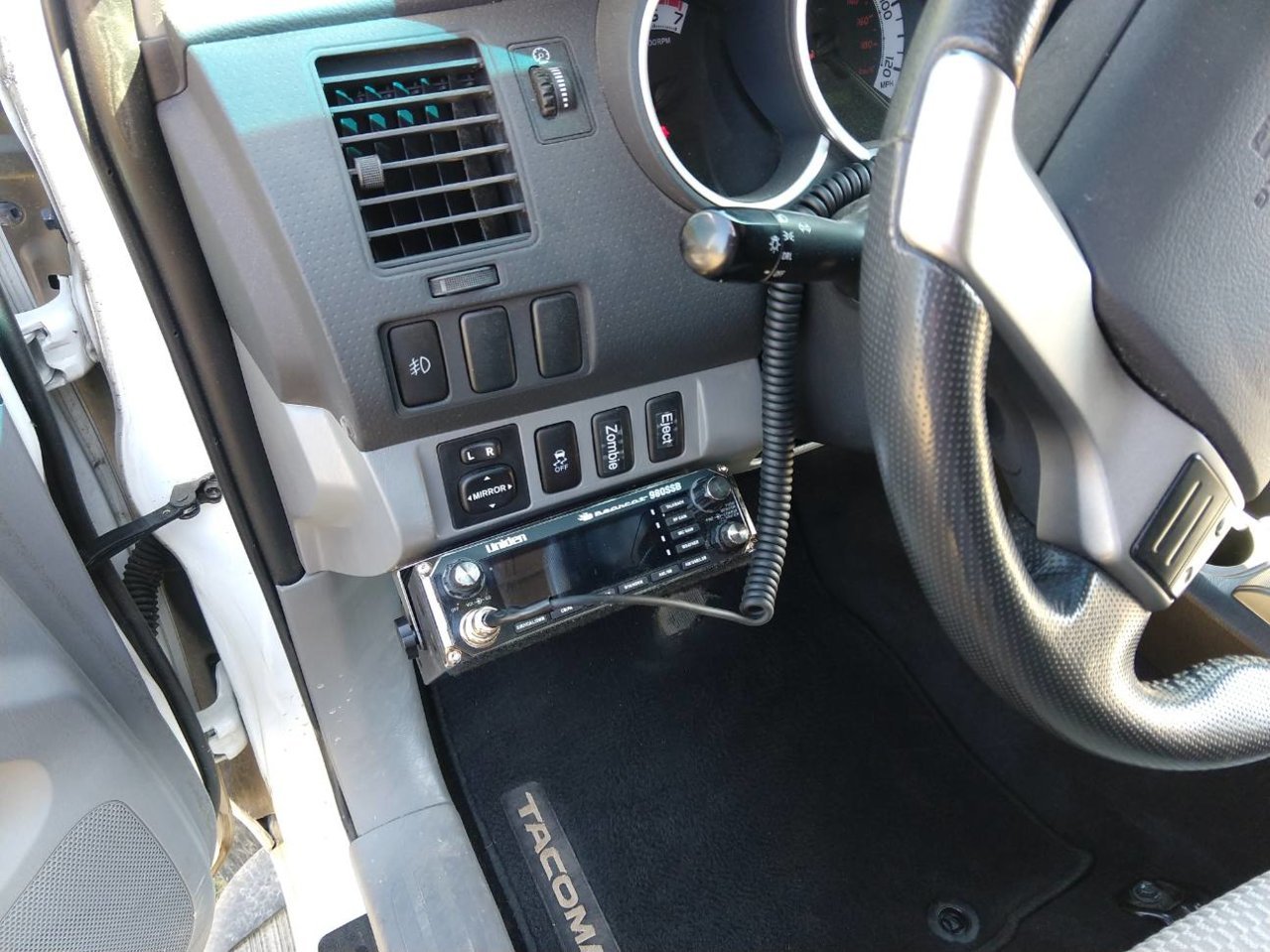

    Amazing work on these installs! I just didn't have the guts to cut or drill, so i decided on a no-cut, no drill option to mount a Bearcat 980 SSB. Cubby tray under the left panel removed (and stored for recovery), cheap nailing strap from Home Depot/Lowes inserted across inside the opening, with CB bracket bolted to it. This allows for up/down and left/right adjustments too. I like it because it is there when you need it but not a 'feature' when you don't.
