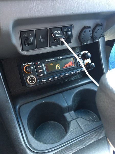

    This is where my radio is mounted. Passenger side. I have some big friends that ride shotgun and they don’t seem to mind the radio being there.
    The red wire is for a different install and the gray one is my wife’s phone charger.

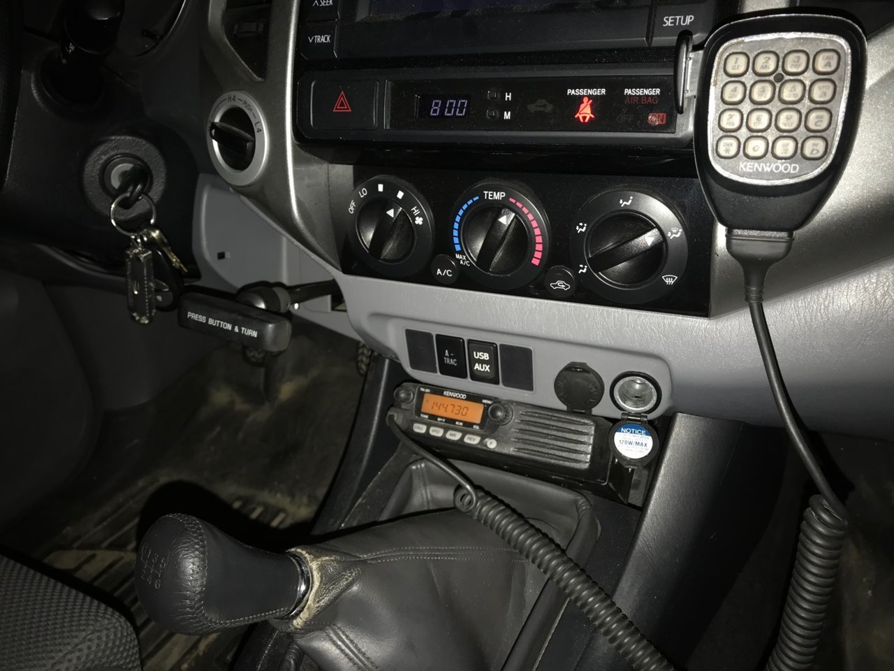

    Search Amazon/eBay for:
    ABS Plastic 12 X 12 X 1/8-Inch
    Buy some then cut to fit. To cut the trapezoid I had bought a switch panel from Izzy and just used it as a template.

    You have to cut the back of the cubby. There are a few I have seen recently that may fit without cutting the back. Search Amazon for President CB and they make some small ones.

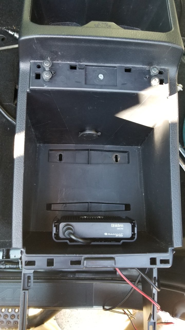

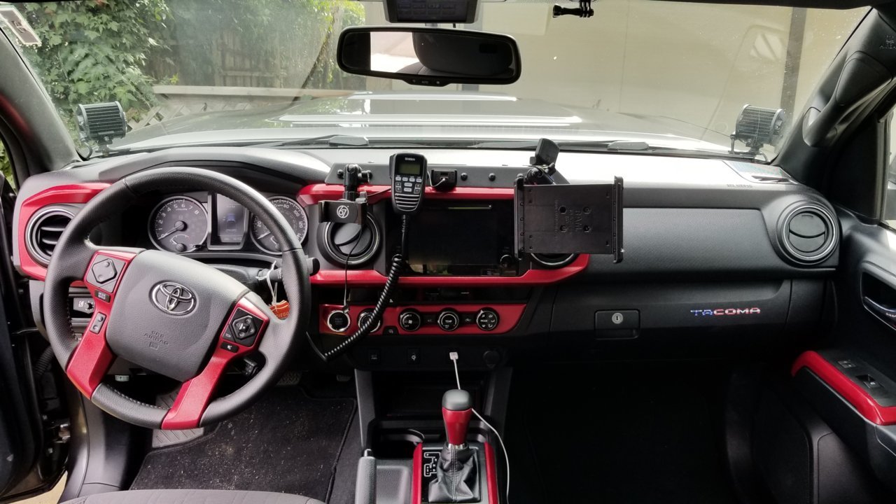

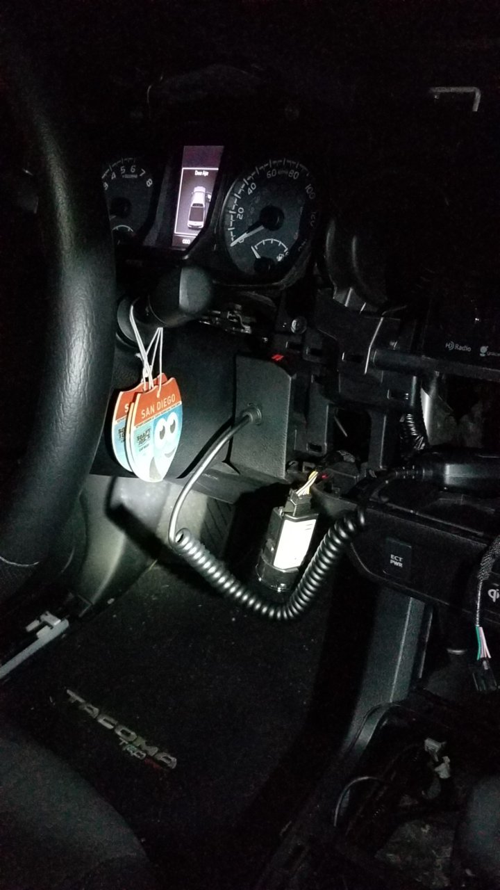

    I just finished my CB install on my 2017 a couple weeks ago. Chose to put the base unit in the console out of the way. Had to relocate the 12vdc outlet to the back of the console and used the existing hole from that for the cables for the CB. I routed the handset cable through the dash near the steering wheel. I think it came out pretty clean. I'm still thinking about adding a grommet or something to the handset cable to keep it put, but that's more of a personal peeve than anything right now.20190130_130703.jpg 20190130_111638.jpg
    Collinmcd99[OP] likes this.
