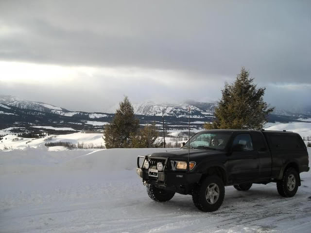

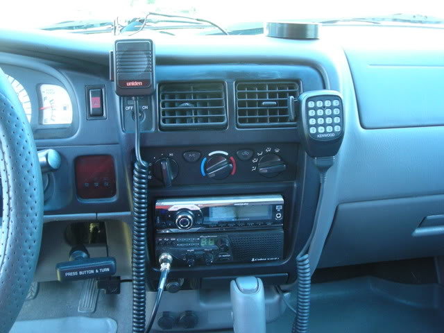

    I was changing out the factory stereo with an aftermarket at the same time I did my CB install, so I went with the DIN sized Cobra 18 with the NOAA weather channels. I installed it directly under the new stereo:
    The CB mic is on the left, the other mic is for HAM.
    I ran the coax to the front bumper, an ARB, where I mounted a Firestik, no springs or anything, just mounted right to the flat part of the bumper behind the headlight hoops:
    The front bumper location seems to work decently though 90% of my radio use on trips are either through HAM or handheld FRS radios. It's also really handy for telling if I'm going to fit under a tree limb or into a parking garage. If you offroad with a club they may or may not allow whip style antennas.

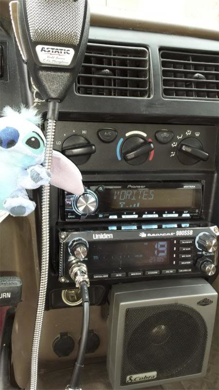

    I just replaced my CB and antenna with a Wilson 1000 magnet mount and a Uniden 980ssb
    This is what I use to have.
    I now have this..
    I have to say, running my Wilson 1000 is way better than my old Wilson Firestik Silver flex-4. The signals are clearer, the SWR is way lower and having the ability to calibrate without using my separate SWR meter is priceless.
    Check my SIG for the write up.

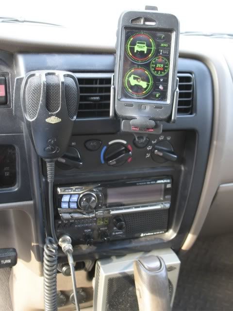

    Here's where TacoDell modded the ashtray spot for the CB:
    http://www.tacomaworld.com/forum/1st-gen-tacomas/254111-cb-radio-location-2.html#post6236944
    You actually don't have to cut all that he shows. Just can cut the back out and jam it in there.

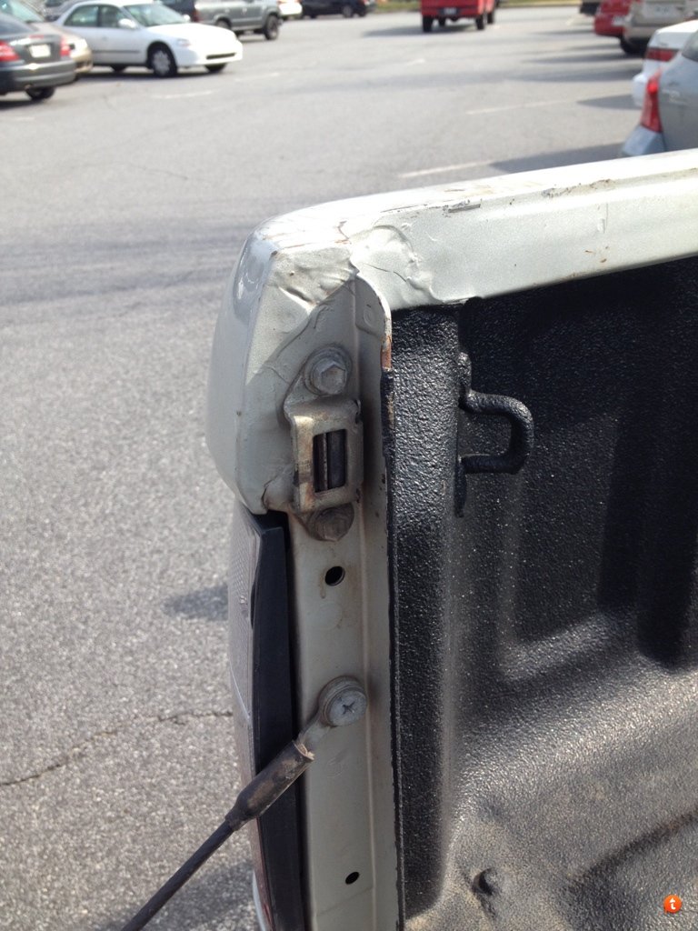

    If I can add, make sure your spring is a heavy duty. Using any lower spring rate will allow your antenna to whip too much
  13. Mar 23, 2014 at 8:39 PM
    BYJOSHCOOK
    BYJOSHCOOK [OP] Mr. Mojo Risin
    Jun 9, 2013
    #105887
    27,928
    Josh
    Woodstock and Alpharetta Ga
    2000 SR5 4WD Lunar Mist
    Check Out My Builds
    Yea it says SS-3H Heavy Duty Stainless Steel
    Just trying to find the best mount now...

    Not sure that'll work on a 1st Gen. the inside of the bed rails don't line up with the tailgate mouth.

    This is what my tailgate looks like, don't really know how it'll fit without drilling and I'd rather not drill into it
