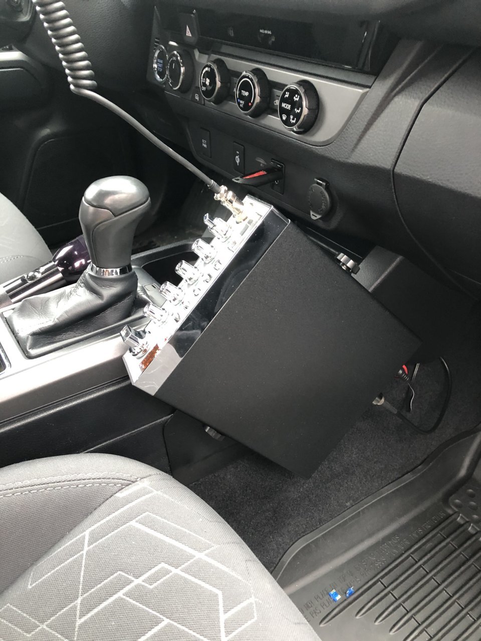

    How’s the leg room for the passenger do they bump into it?

    2018 Cement Off Road V6 Access cab
    Unless your passenger is fat, it's not an issue. My wife has no issues with her left leg being encroached upon by the CB.
    I made a bracket that mounts the CB to the side of the center console. It's a pretty well designed fit, and it keeps the CB tight against the side of the center console.

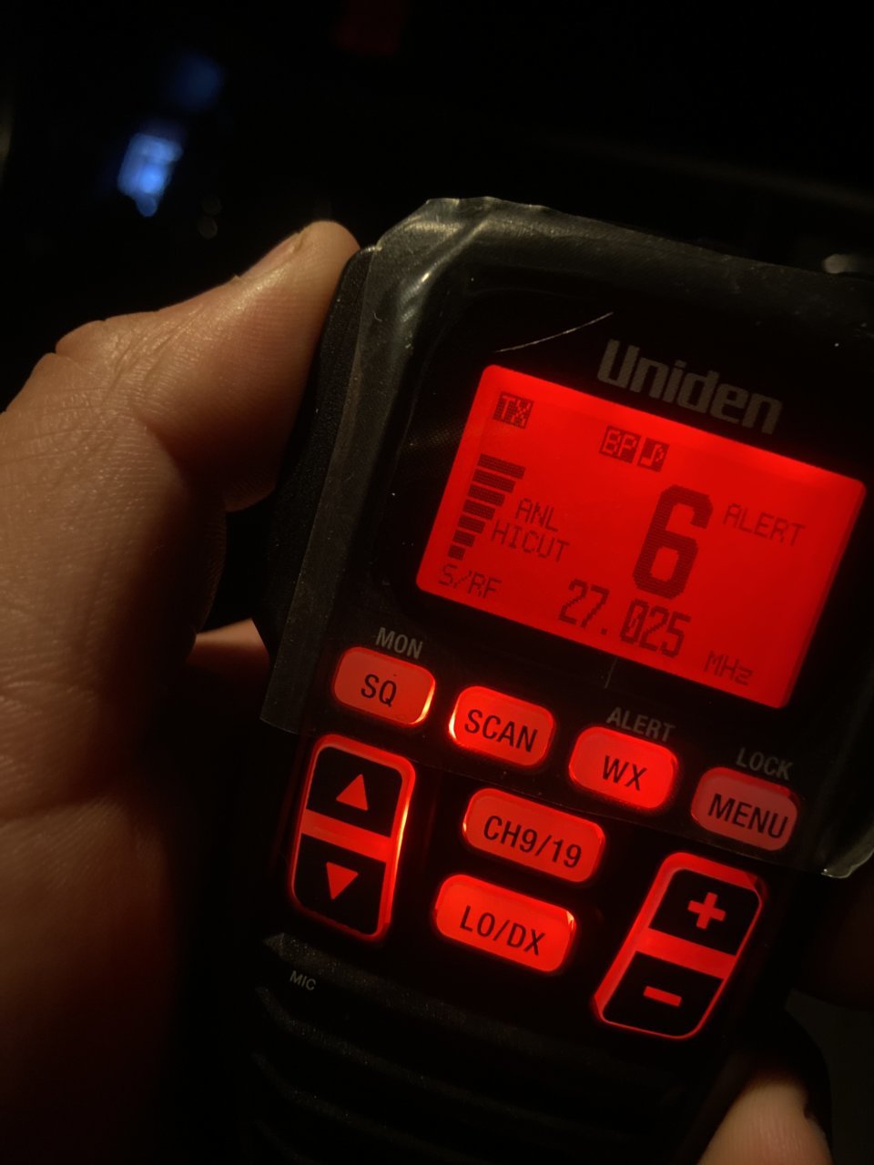

    Ok y’all I have done the most to make the Uniden CMX760 work. And tbh it’s a big headache, bought three different antennas and it seems to only let me speak threw it without a antenna attached to my cb antenna mount. But yet no one can responds to my radio checks. I give up at this point. It’s just a nice decorative piece to my interior to just listen to truckers.

    2019 TACOMA SR V6 SC , 4X4, AUTO, 4.88, 265/75 r16
    Did you adjust the antenna for your swr? If that's out of wack you won't transmit clearly
    west4x4[QUOTED] likes this.
  13. Mar 7, 2023 at 8:24 PM
    #33
    west4x4
