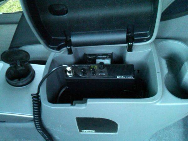

    If you plan on taking any overgrown trails stay far away from any of the roof mounted antennas.... especially a magnet mount. You can't give those things away around my neck of the woods - and I have been trying. Within five minutes into our trails they rip off the roof.
    Do not pinch CB coax...ever.
    Personally I have my CB, aux speaker, and swr meter all installed inside my center consul. It's very clean and no one would ever know it's there if it weren't for my aux speaker being recessed into the consul.
    FWIW I was talking to a guy in New Orleans last weekend and I'm in NJ.
    Proper tuning, peaking, antenna cable length (as short as possible), and antenna (running a 102" whip) are the keys IMO. Even with a crappy cheap radio like I have I can grab plenty of signals.

    I use to have a fire-stick (diesel flex) fiberglass antenna mounted to the bed behind my cab that did pretty good back in the day. I'm currently working on a pneumatically-retractable bed mount antenna for a ham that will fold down, ill try and post when done. When I get the ham i'm gonna mount it in the dash below the CD player. Check out the Scosche single-din dash kit. Some people have been able to fit a CB's in these since they have such a large bay under the CD player. Although the larger Cobra CB's seem to work better that the compact ones, not sure if they would fit.
    This is not a Scosche dash kit, it looks like a metra, but this is the idea:
    http://i1353.photobucket.com/albums/q676/Bruth925/CBRadioComplete_zps70345238.jpg
    The scosche seems to have much more room.

    I was hoping it would fit in the cubby hole below the cigarette adapter plug, if not I might go with what CREEPYTM did and put it in the rear cupholders. I can't do what lusetaco did because i have a custom subbox there and I can't do what you suggested because i have the stock radio/touchscreen.

    As far as mounting the Cb radio, I recently bought a 2nd glovebox with the intention of mounting my cb in the face of the box almost like a stereo in the dash. and run a trailer harness style plug as my power supply so that it could disconnect and switch back to no cb in just a few minutes. I dont know if anybody else has any interest in doing that but I suggested it to a few friends in my hunt club who are gonna take the idea and run with it

    Thats an idea. I guess the only problem is the microphone cord length. but you could possibly extend and run that somewhere else.
    For the op, it should fit in the cubby hole. check out this thread if u had not seen it:
    http://www.tacomaworld.com/forum/2nd-gen-tacomas/236709-cb-install-location.html

    if it doesnt fit in that cubby hole hopefully it will fit in the cc. thanks for that forum Runn0r.

    The Cobra 19 ultra III is 7" Long (or Deep) x 4.5" Wide x 1.75" Tall, I'm not sure if that will fit or not. I need my dad to mail me the CB hopefully it fits in that cubby that would be the ideal spot for me. The CC would be nice to keep it hidden though. I look at the pictures in that forum and I look at my CC and it looks like theres is bigger, hard to tell without the actual CB in my hands though.
