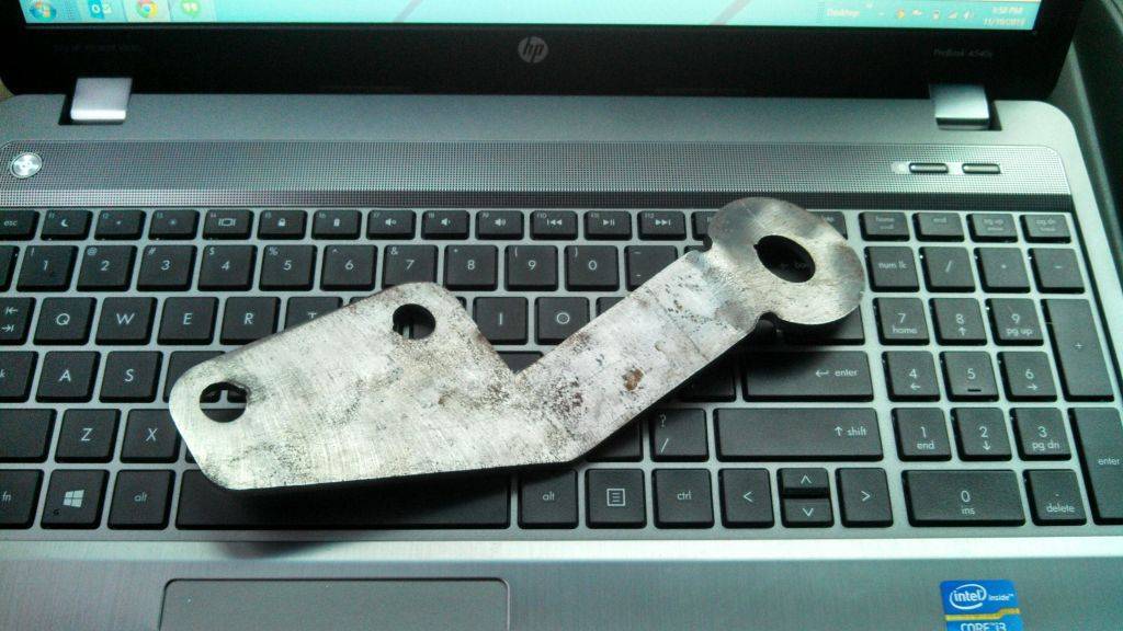

    Relentless NMO mount. Best of both worlds. This guy is gonna be mounted on the pass. side for my SAR radio (hopefully this weekend).

    Yeah, didn't want to drill the roof. The hood should be a decent ground plane, even though it's not 360°. It's the next best option besides a roof mount.
