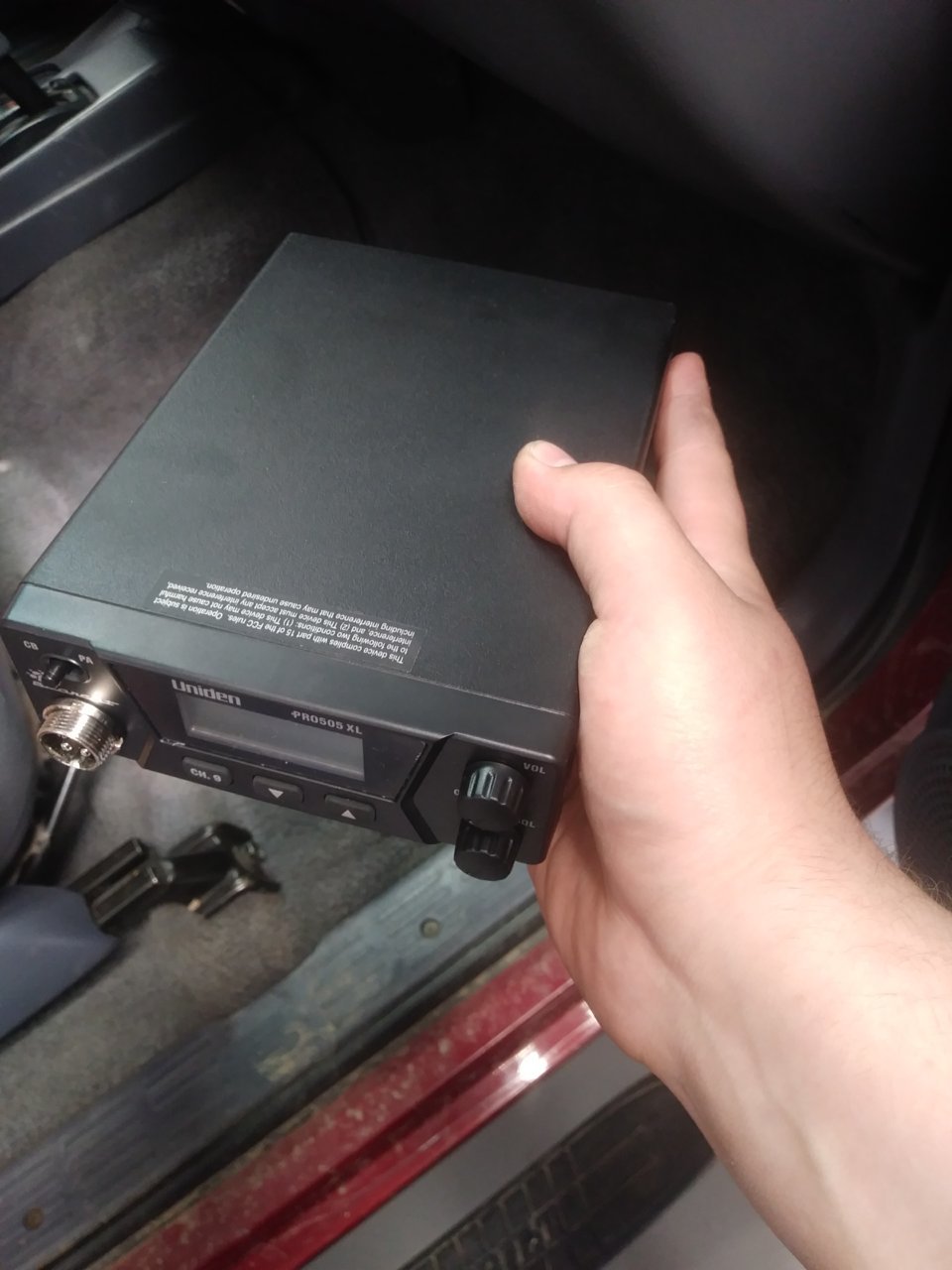

    Just got myself a CB radio with a PA. Trying to see some great ideas of mounting the CB radio inside the cab and antenna locations.

    How big is the cb radio?

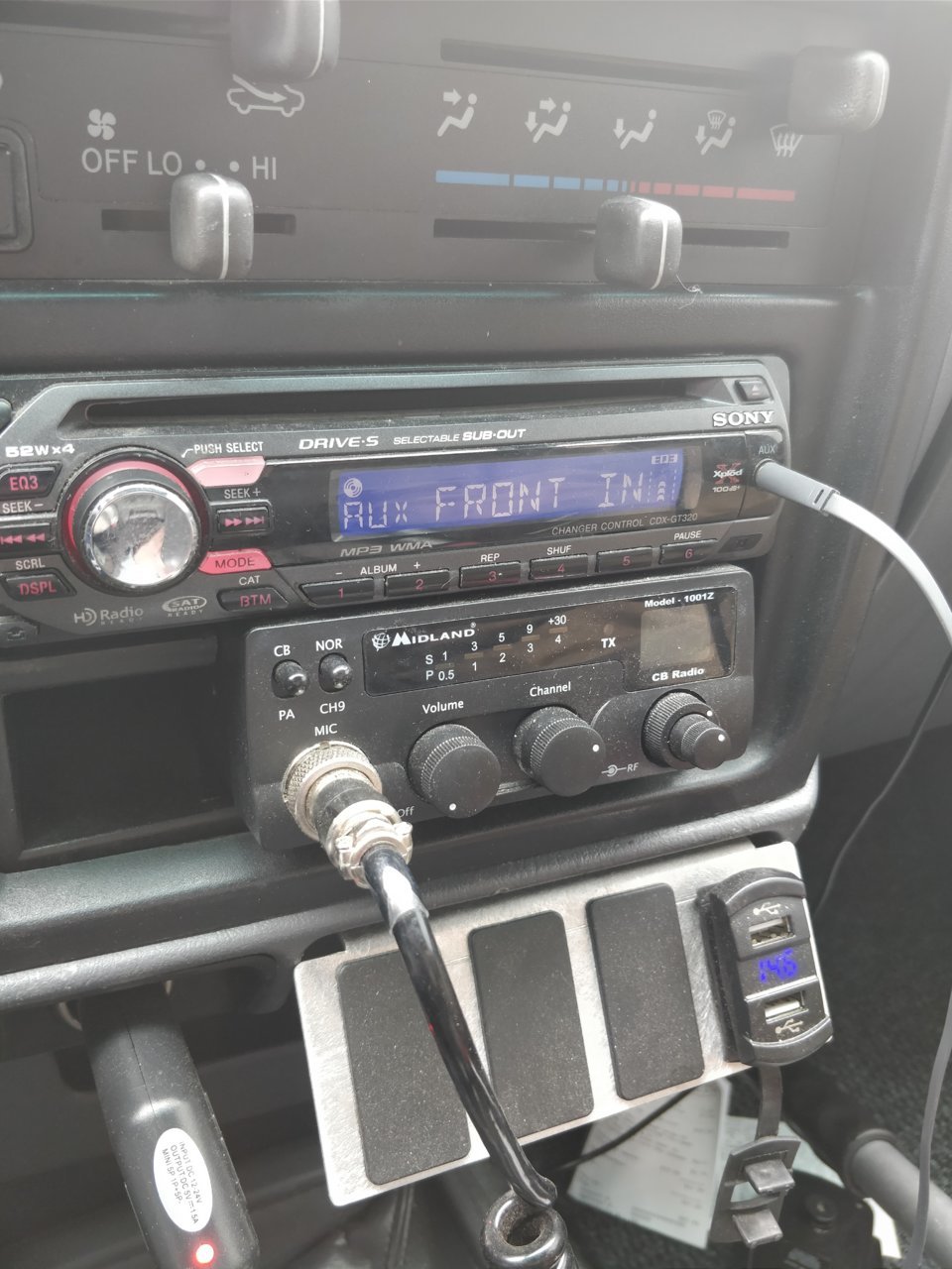

    I put my CB in the pocket below my single DIN radio

    It was able to fit? Mine doesnt fit into the pocket under the radio by like half an inch or even less. Did you cut it to make it fit?

    I cut it. I also needed a 90 deg fitting for the coax because there wasn't room behind it for the standard connector.

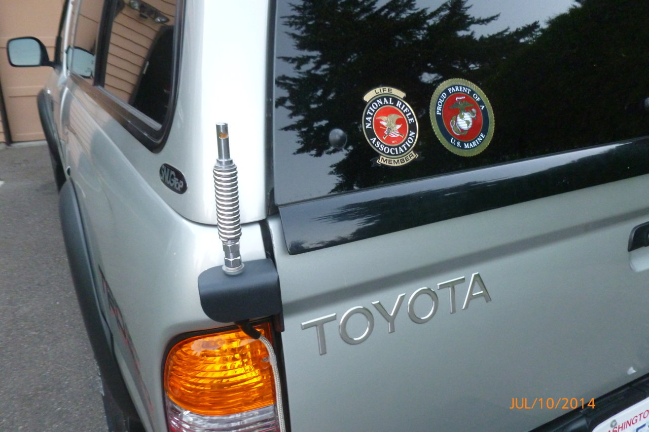

    Pics of mine, a Cobra WX ST II, mounted in single DIN space. Like Wulf mentioned, I also used a 90 degree coax connector plus I used a heat gun to very gentle mold the heat/ac duct inward to clear the coax connector and allow a flush mount.
    I use a Firestik antennae on a BAMF mount at tailgateP1020508.jpg P1020080.jpg .

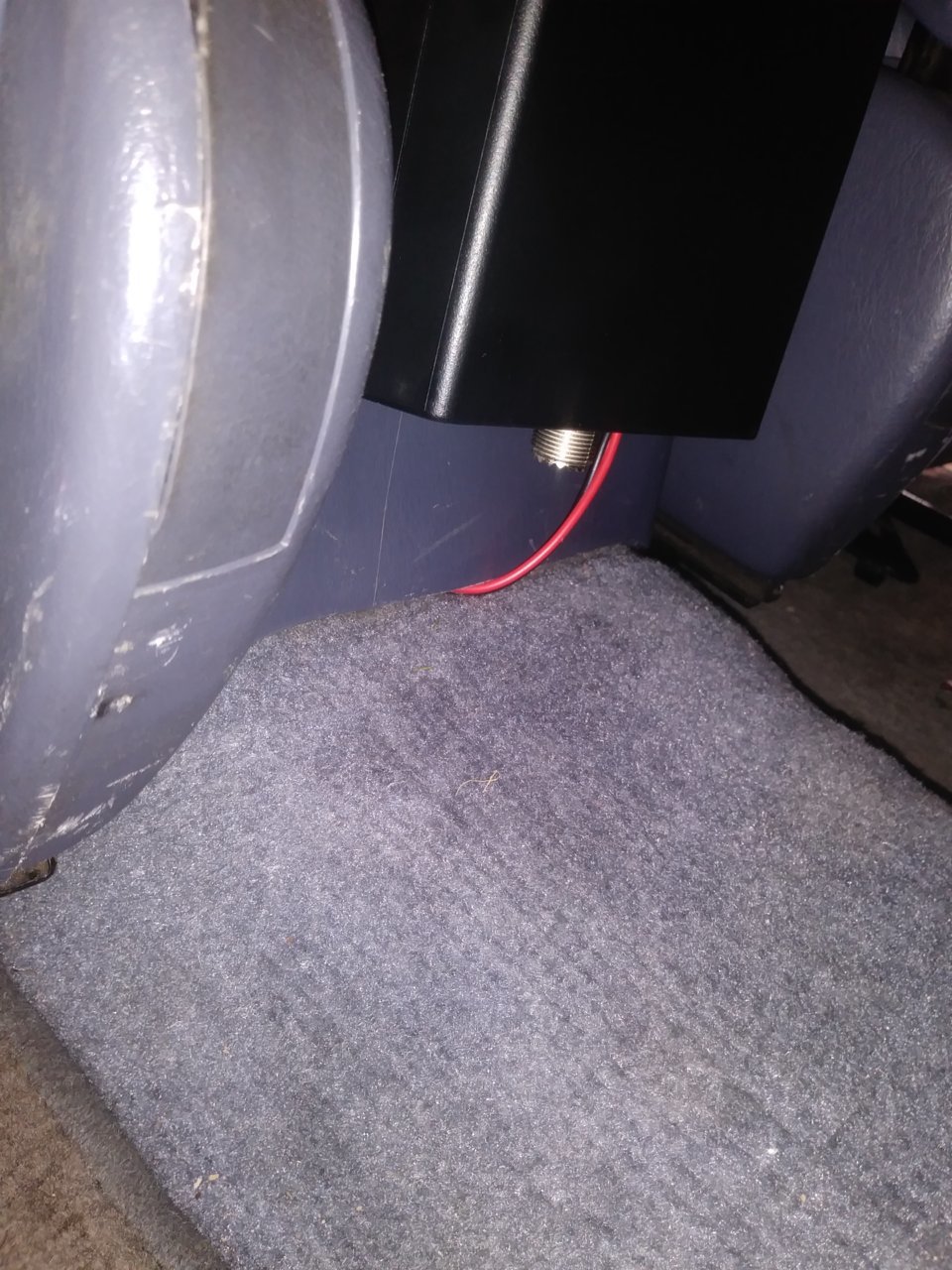

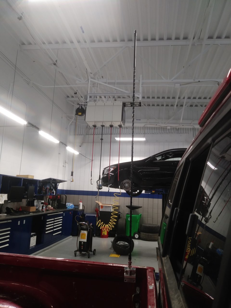

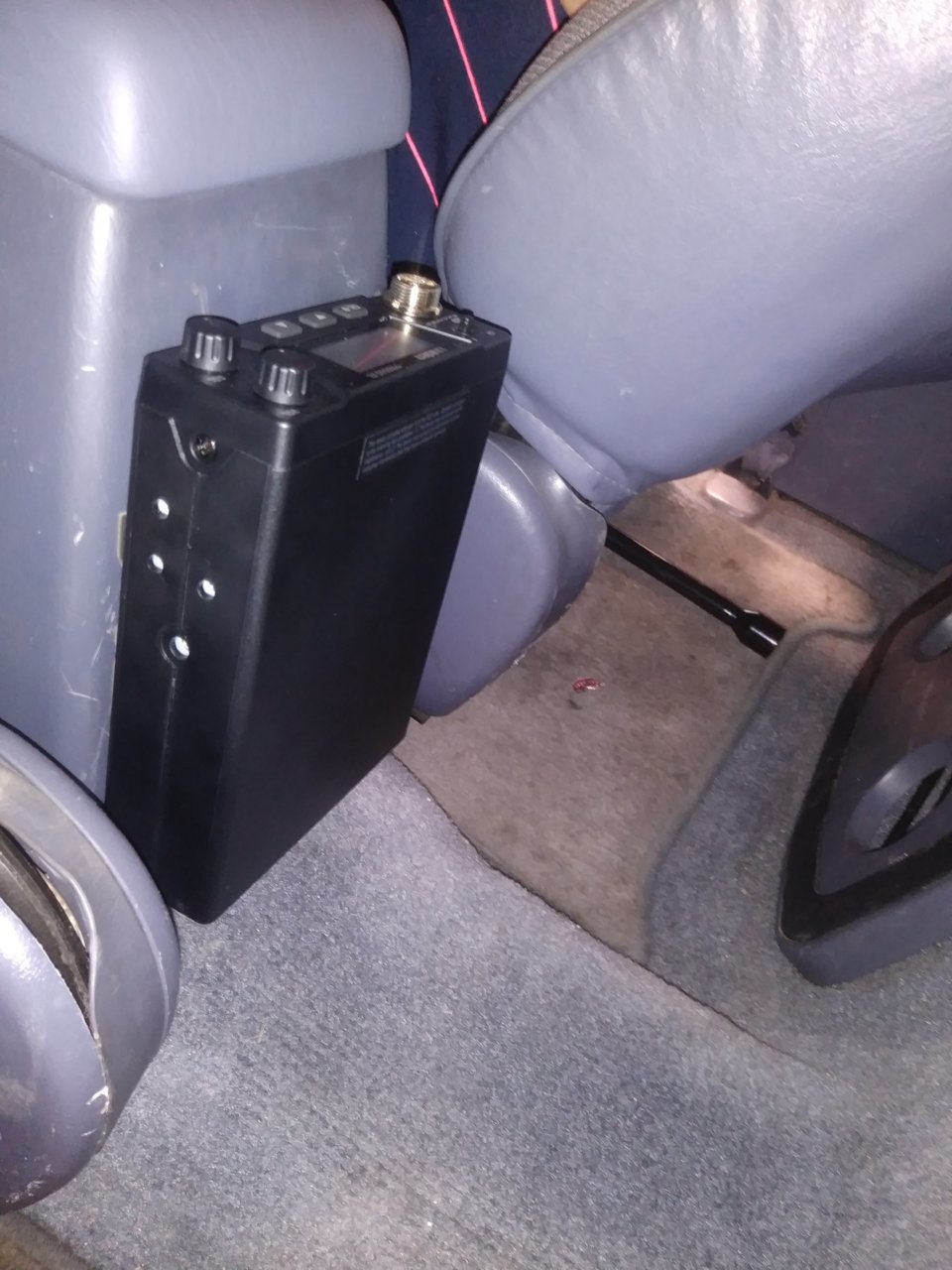

    I decided to mount it behind the center console. Heres the outcome with the antena mount (still gotta drill a hole in bed to run the wire and install a graumet in the hole). Took off the center console and ran the wire through it.

    For my antenna coax, I ran it through an existing hole (with a factory grommet) at the lower driver-side rear of the cab. I slit the grommet, ran the wire through it, then used sealant to make it water tight.

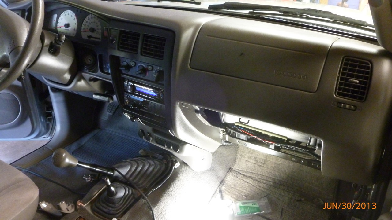

    Heres my cb set up
