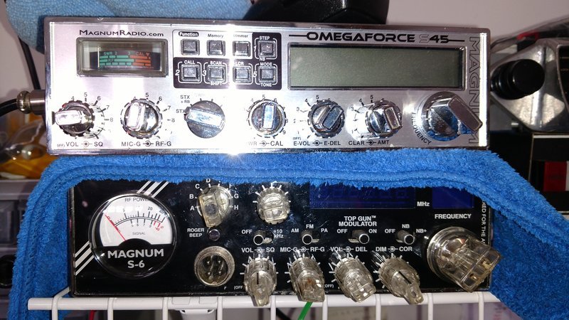

    These two radios shown here are examples of 10 meter radios that are geared towards being converted to work on CB. Both radios will dead key at anywhere from 5 to 15 watts, and will modulate to an easy 40 watts.
    Your typical fcc certified radio dead keys at 3.5 watts and modulates to anywhere from 10 to 12 watts, sometimes up to 13-14.
    The extra watts don't really make that much of a difference on the other end. It's just that these radios are what you light hear called "truck driver radios". There's a common issue with CB shops using shady practices to give our hard working otr drivers the warm fuzzies in thinking that extra half a watt is going to make a night and day difference. But that's another subject for another day.
