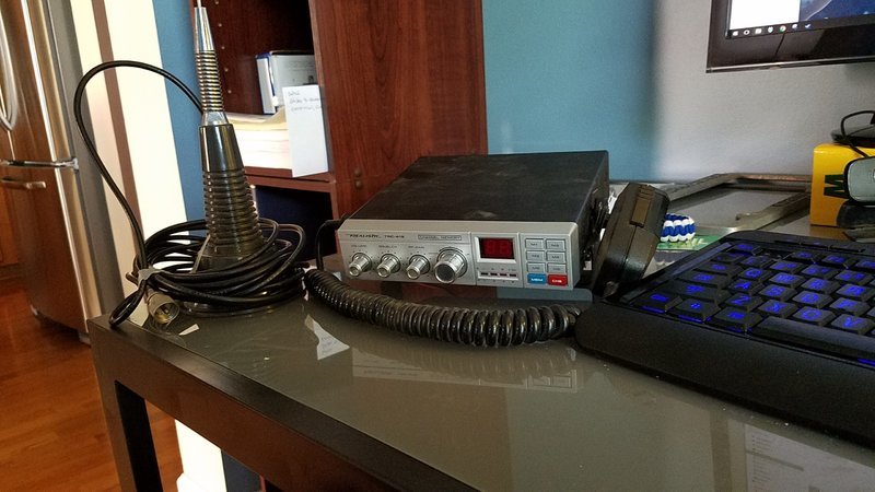

    All - cleaning out grandpas garage the other day and he was throwing this away. Mint condition. Is this worth trying to install, or should I get something new? Looks like it is not really a collectors item.
    Realistic TRC-419

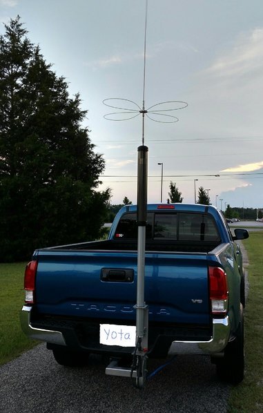

    I don`t talk on the cb anymore, I have been a Ham for the last 12 years but I have an old red 4ft Francis out in the shed that I wouldn't take $100 for, the swr is flat on all 40 channels.:D
    This is my current Ham mobile setup
    You can buy one Francis and the swr is 1.2 on all 40 channels and the next may be a little higher or lower but they are decent antennas for someone that wants to put a quick/easy antenna at a good price on their vehicle.

    I`d hook it up and give it a try, it appears to be brand new.

    Hooked it up and went for a drive. Didn't hear anyone though.

    You got an swr meter ? If so, check it and if it`s 1.5 or lower you are good to go.

    No - I am completely new and just threw the antenna on my roof and drove around for a few miles. I live downtown so I figured I would've maybe heard something.

    You can pick up an swr meter fairly cheap, Amazon has lots of them, even truck stops have them.
    While this may not be a top of the line meter, it will work for what you need it to do.
    https://www.amazon.com/Astatic-PDC1...UTF8&qid=1466872885&sr=8-5&keywords=swr+meter
