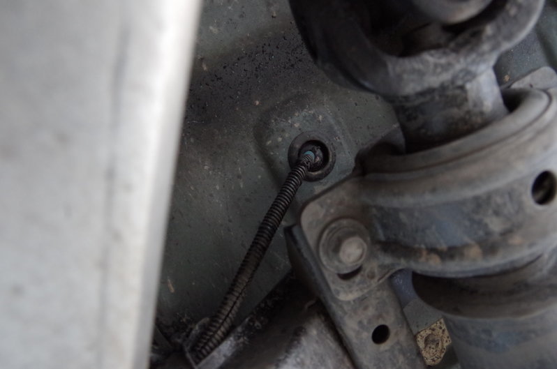

    And try to bring the cable into highest point of the undercarriage.
    This is where I entered in the cab, there was a factory hole with a nice rubber closed grommet that led straight into the center hump right at the center console. I pierced the grommet with the smallest hole possible that allowed the cable to enter the cab. Cable was bare (I soldered the connector after entry in the cab) so intrusion was a very small diameter hole. Then I siliconed the heck out of it. Both below and topside.
    I'm pretty sure that if i didn't do everything that I did, my toes would have been soaking in the muddy waters of Rausch Creek PA inside my truck. LOL.
