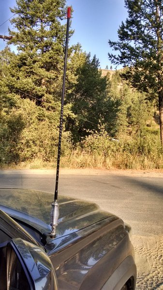

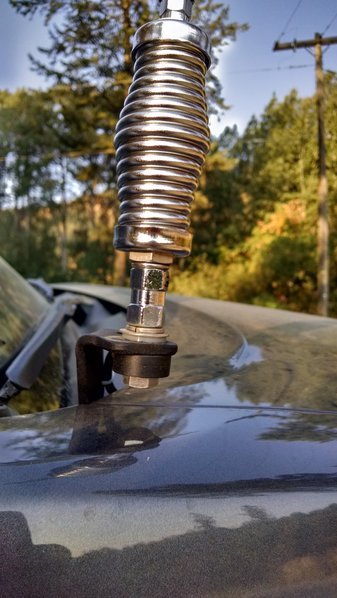

    While the antenna base that is sitting higher up is intended for VHF, the one sitting lower is an Ab-15 which can be used just fine on CB. I have an AB558 that is essentially the same thing, minus the ceramic components of the AB15 and some other housing differences, and it works perfectly for CB. The AB558 is really just a coax+spring within a fiberglass housing that mates to the whip. Plenty of guys run them on CUCVs for CB.
    I've also seen a guy modify the internals on the VHF antenna that is seen in the pic so it could be used on the CB bands. However, the expense sourcing the VHF antenna base, mount, and whip is hardly worth the effort, unless someone is purely after looks and has money to burn.
