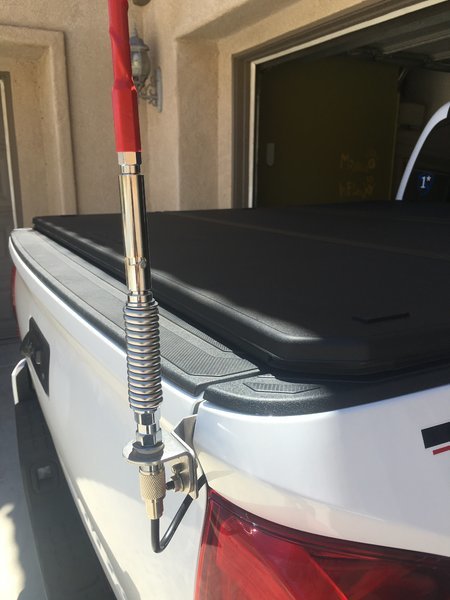

    +1 I went with regular connector
    Fire stick 4"
