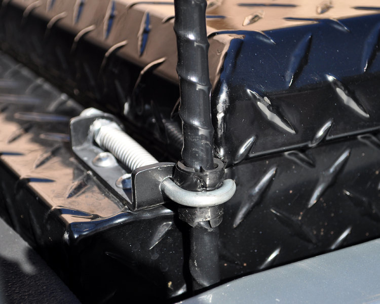

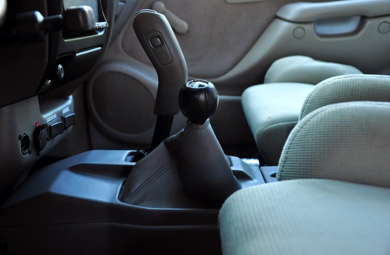

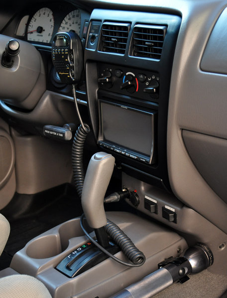

    Ritchie
    Ritchie Well-Known Member
    Dec 24, 2012
    #93649
    1,931
    San Diego (North County)
    RC Step side Pre-runner
    2.7 w/auto, 4WU 3 link, F & R Diamonds, ARB's F/R w/ Yukon 5.29's, Inchworm 4.7 Lefty, Deavers, ARB OBA, Schrockworks up front.
    Works for me. 4' Firestik and Cobra handheld. The switch forward of the console allows me to kill power to the connector.
    Antenna up:
    Antenna down:
    CB plugged in:
    CB unplugged:
