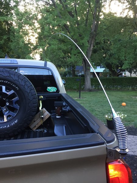

    Cool setup. Here's what I ended up with...

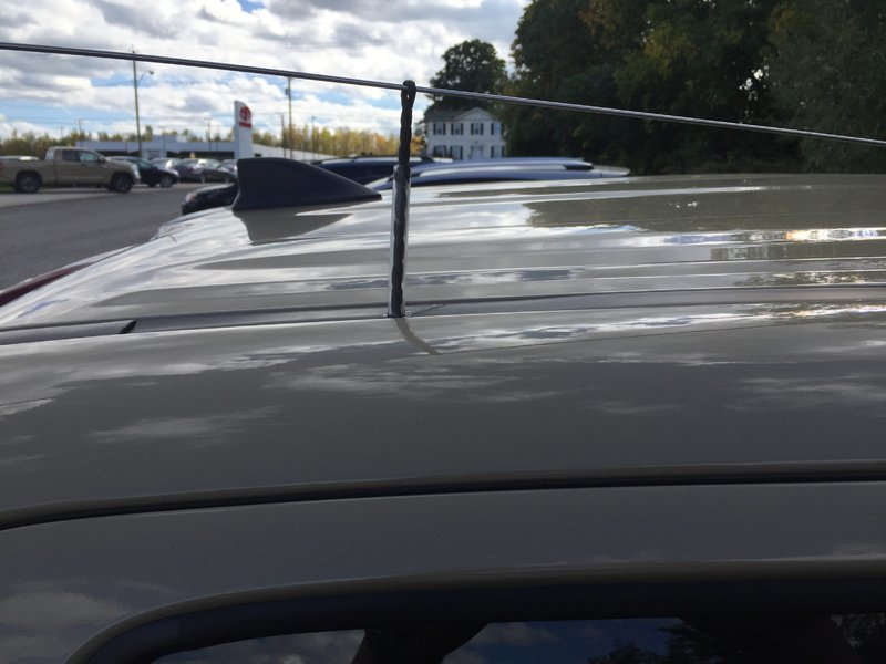

    Thanks.
    That is nice what you've done there. What is the length of the antenna? I had to go to a shorter antenna due to it hitting my car port... still works great on the trails and doesn't hit branches/ trees.

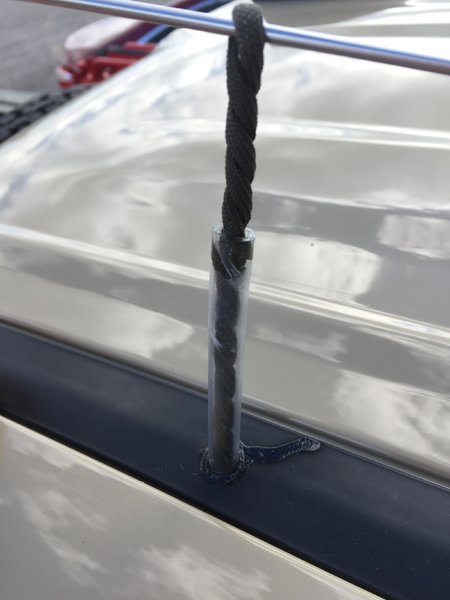

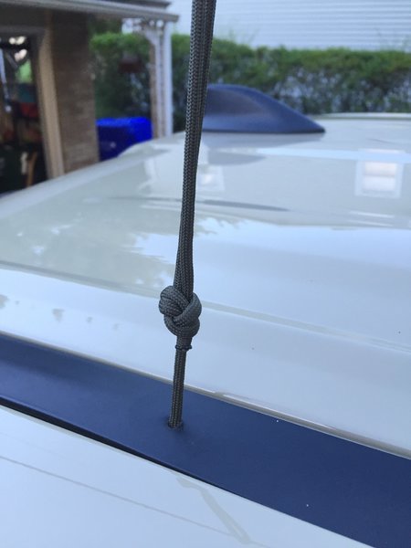

    It's a 102". The front tie down took a few weeks to figure out, but there's very little contact between the antenna end and the roof anymore.

    What did you use for a mounting bracket?

    Steve
    '16 Quicksand DCSB TRD OR
    v.1
    v.2
