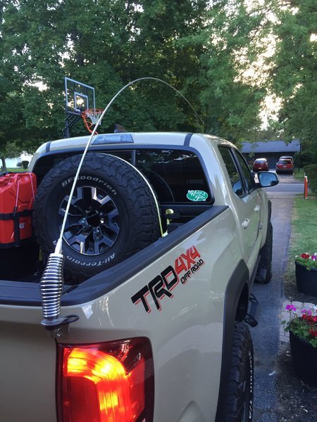

    HalfWayThere
    HalfWayThere Well-Known Member
    Aug 16, 2015
    #161963
    792
    SLO, CA
    2016 DCSB TRDOR 4x4
    Great!
    Wishes:
    1. Sell them for either side. (I want to have an antenna on one side and a dust/rear fog light on the other).
    2. Take into account the overhang from a shell.
    3. An extra little hole or two for cable management zip-ties would help the install look more polished.
    Good luck.

  11. Oct 9, 2016 at 2:41 PM
    #431
    C4 Fabrication
    C4 Fabrication Well-Known Member Vendor
    Apr 30, 2014
    #128867
    1,367
    Caleb
    South Dakota
    07 DCLB Sport
    2" lift, 285/70/17 BFG TA KO2's, baja bumper, bedrack with swing out, CVT RTT, Leather interior, heated seats, JBL, remote start, K&N intake, Hood Scoop LED lightbar mod.
    Thanks for the tips, first thing i am noticing is that there isnt much room between the edge of the tailgate and the truck bed for a bracket to fit between. Didnt have much time to look at it yet, hopefully we can figure something out.
  12. Oct 9, 2016 at 2:53 PM
    #432
    EatSleepTacos
    Mar 24, 2015
    #151688
    59,846
    Randy
    West Valley, AZ
    2017 4Runner
    I'm sure something can be worked out, since this guy was able to fit his bracket through.

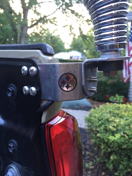

  13. Oct 9, 2016 at 3:31 PM
    #433
    HalfWayThere
    Aug 16, 2015
    #161963
    792
    SLO, CA
    2016 DCSB TRDOR 4x4
    It's definitely a tight fit. It might require thinner and stronger material. Like EatSleepTacos says, since the stainless FireStick bracket fits, we know it is possible.

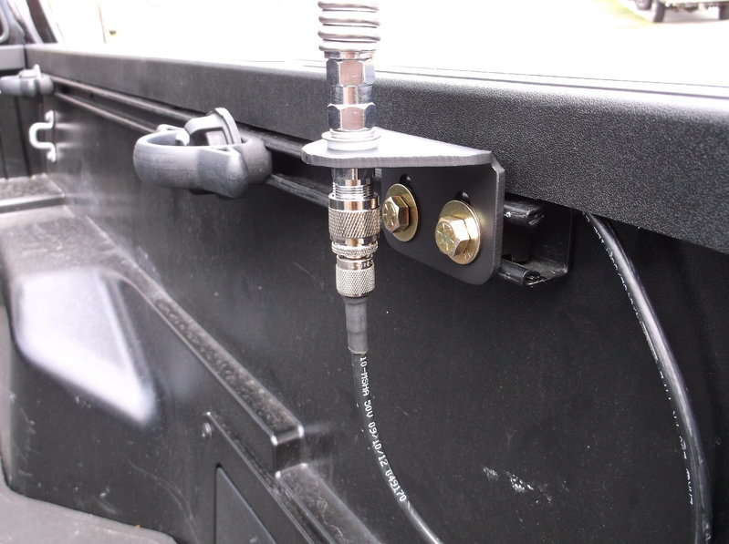

  14. Oct 10, 2016 at 6:42 AM
    #434
    ROCdermody
    ROCdermody Well-Known Member
    Oct 15, 2015
    #166740
    1,037
    Steve
    '16 Quicksand DCSB TRD OR
    Fits like it was meant to be between the bedside body panel load bearing bed structure. No rubbing, even after a reasonable amount of trail running.
  15. Oct 10, 2016 at 6:51 AM
    #435
    C4 Fabrication
    Apr 30, 2014
    #128867
    1,367
    Caleb
    South Dakota
    07 DCLB Sport
    Nice, thanks for the pic!

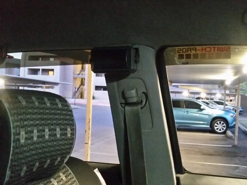

  16. Oct 10, 2016 at 8:05 AM
    #436
    scott96929
    scott96929 IRoniK
    Sep 20, 2014
    #138704
    866
    Scott
    Phoenix, Az
    2007 Tocoma PreRunner (Ironik)
    All Pro Front Plate Bumper, MaxTrac 4" Spindles, Light Racing Upper Control Arms, BOSS Leaf Springs, Toytec Adjustable Coilovers, Fox 2.0 Rear shocks, 17" Raceline Assault Wheels, Toyo RT 285 70R17, AFE Stg II Cold Air Intake, Prinsu Cabrack, Prinsu Bedrack, 10K Kensun HID Headlights, Avec 20" Optic LED Light Bar, Avec LED Fog Lights, Heretic 30" Combo LED Light Bar, Viper Max 12000 Winch, Quick Fist, Tepui Kukeman Ruggerized RTT, Smittybilt Awning, Relentless Fab Tailgate Reinforcement, Anti-Dark Hood Lighting Kit, Fog Lights Anytime Mod, Rear Differential Breather Mod, P&L Tailgate Lock, KMFAB Rock Sliders, KMFAB Rock Light Kit, KMFAB Bed Light Kit, KMFAB RTT Light Kit, KMFAB 12 VDC Outlet Kit,Optima Dual Battery, SSCS Kit, Switch Pro 8100 Kit, Cali Raised Ditch Light Kit
    Installed my external cb speaker.
