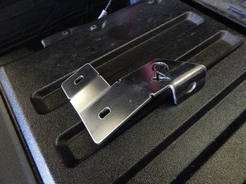

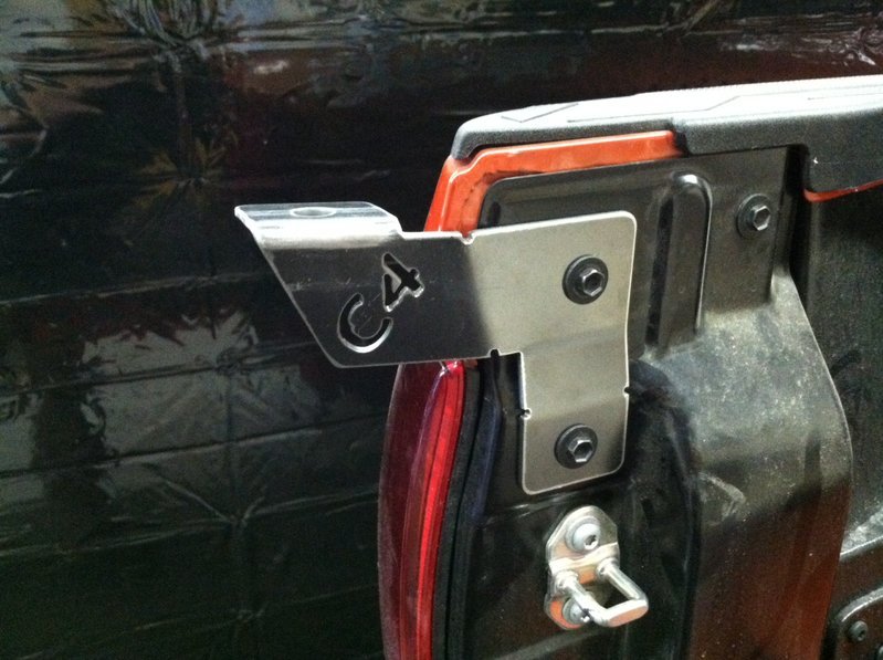

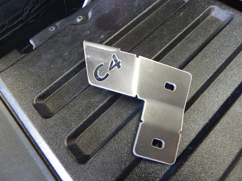

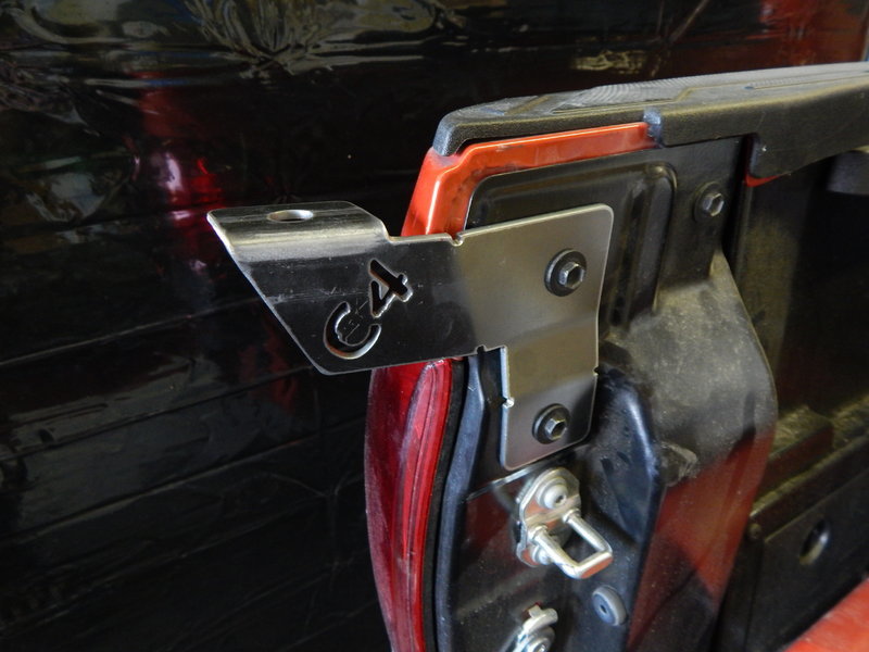

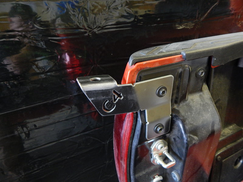

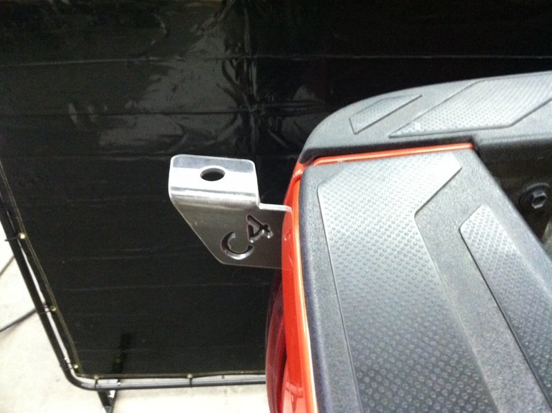

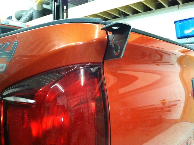

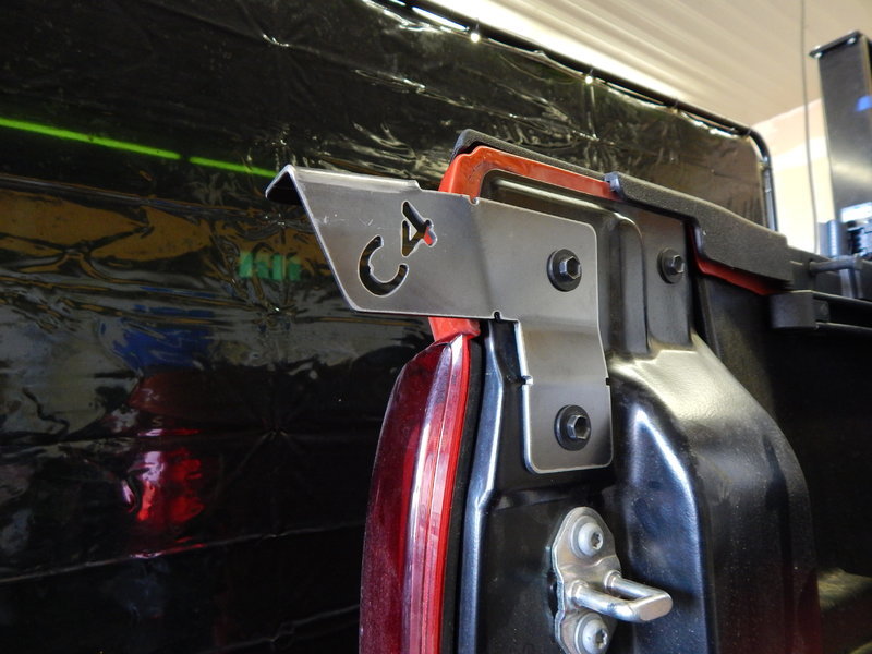

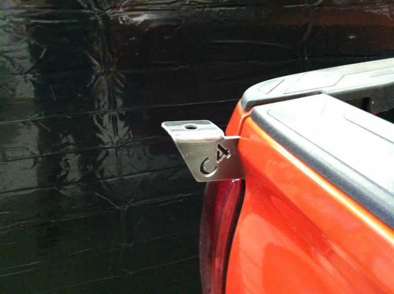

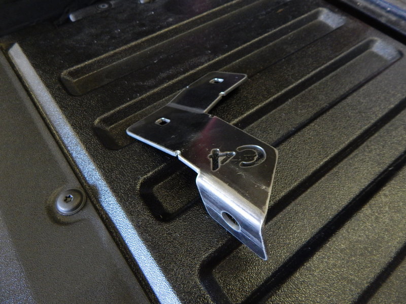

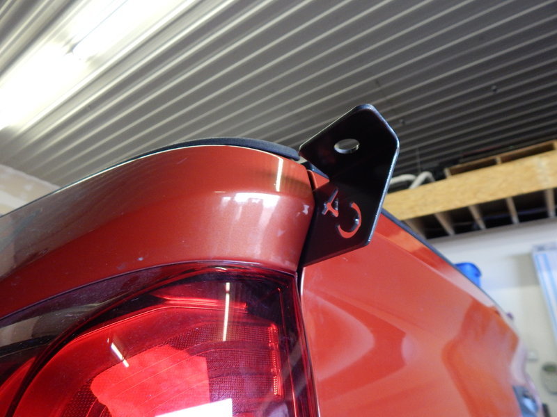

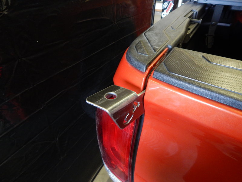

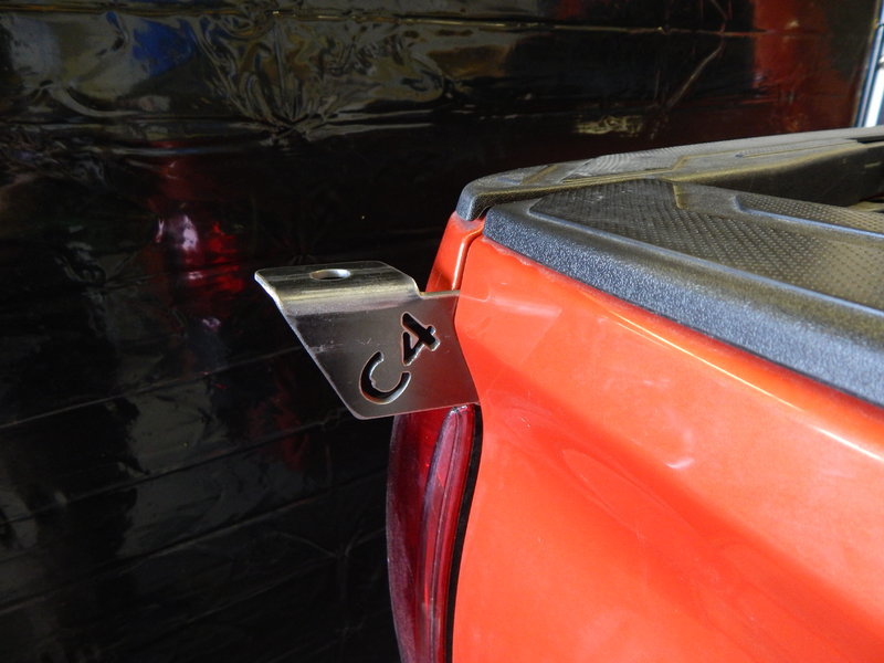

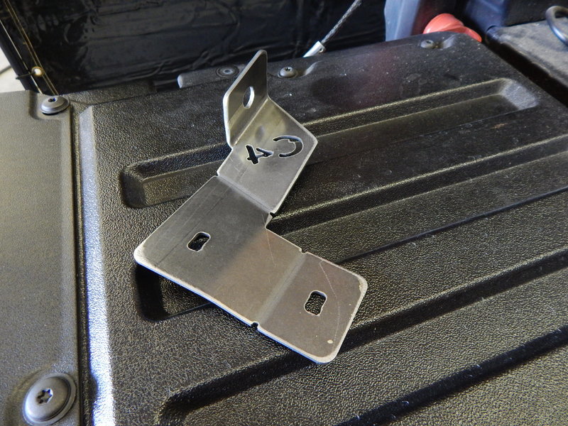

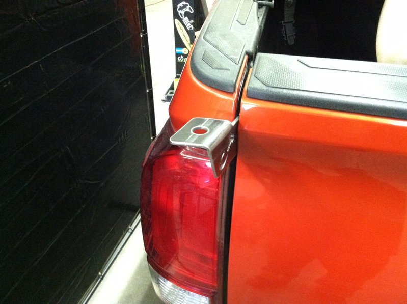

    Alright guys, got some time to focus on this today. Here is what I have come up with:
    -Made from 12 gauge steel
    -CNC plasma cut
    -Press brake bent
    -Has slotted holes for adjusting the slope of the bracket
    -Available in left or right side configuration
    -Can be ordered with 1/2" hole for CB or 3/4" hole for HAM
    -Direct bolt on using original hardware on the truck
    -C4 logo can also be used as a cable tie slot to hold the cable in place
    They will be available on our website really soon.
    Let me know what you guys think- good, bad, improvements, and suggestions are all welcome!

    I'd love to get one of those!

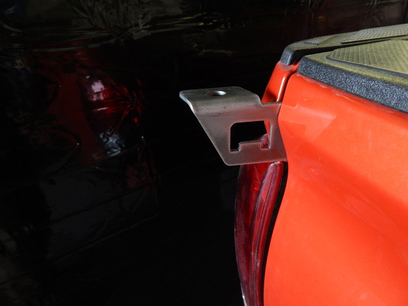

    Here are some better quality pics
    DSCN3910.jpg DSCN3911.jpg DSCN3905.jpg DSCN3906.jpg DSCN3913.jpg DSCN3908.jpg DSCN3915.jpg DSCN3912.jpg DSCN3917.jpg DSCN3916.jpg DSCN3907.jpg DSCN3914.jpg

    Looks awesome. Will you have them available for powder coat?

    That looks great! I like that it uses existing bolts to mount it. Are they stainless steel? Any idea on price? I need a left and right one drilled for Ham and one drilled for CB. :thumbsup:

    Thanks!
    We will most likely have a run of them powder coated so we have some in stock to see how they sell.
    These are not stainless, just mild steel. We could eventually make stainless if there is enough demand. price hasn't been finalized, but thinking somewhere around 30.00 each.

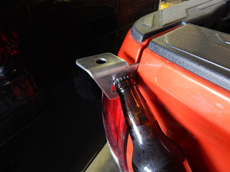

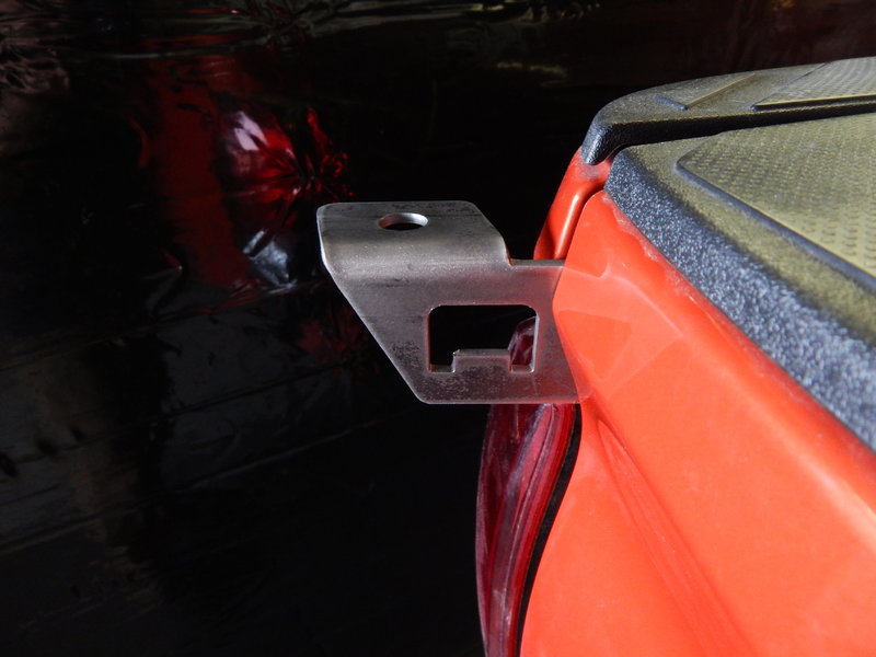

    Added some extra cool factor. You will be able to order them with an integrated bottle opener instead of the C4 logo if desired!
