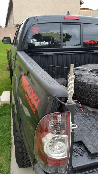

    I've got a similar issue since I've got a soft-topper, but plenty of fab shops make a mount bracket to put the antenna on just above the tail-light at the edge of the tailgate. Lots of the guys at Rock Therapy had these kinds of mounts.
    here's the link to BAMF's version, which is just the first one I found on google (not reccomending for or against it in particular, they've got a great rep but I've never used any of their stuff personally):
    http://www.bayareametalfab.com/2nd-Gen-CB-Mount_p_16.html
    One other trick I did on my install was to wire a good sized capacitor (220 microFarad, I think) between the power/ground wires into the radio (past the switch I have which shuts off the radio power altogether so that it can't get accidentally turned on when my antenna isn't on the mount). It's intended to clean up the power into the radio to reduce interference from other stuff on the truck - I'm not sure if it really helps, but it doesn't hurt anything.
