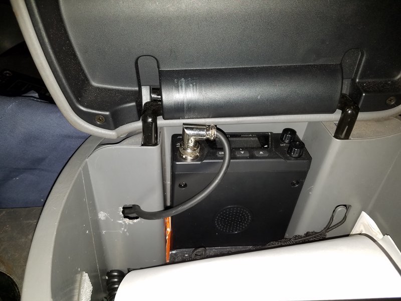

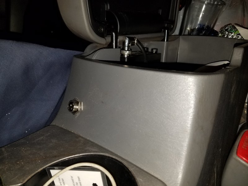

    It's a uniden 520 with 90° adapter, drill two holes and your done. Also have to drill the bottom of the console for coax, ext speaker, and PA wires, check my build

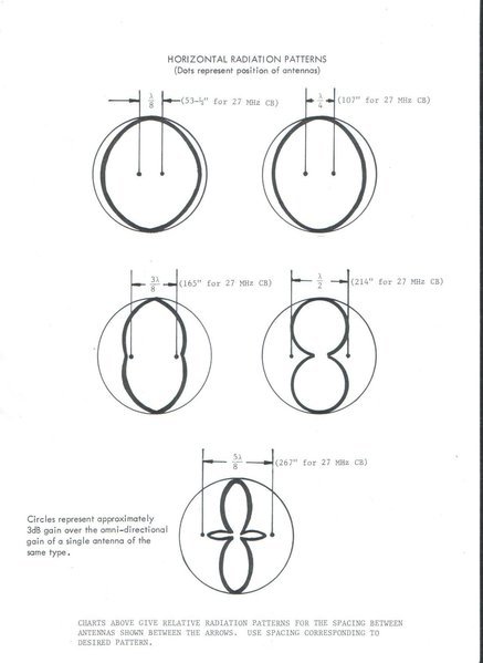

    Hmmmm, you "co-phased" your CB setup? That helps "extend" range front/back and "squeezes in on the sides" depending on antenna orientation. How you have it, your front/back RF radiation envelope will extend outward, but your side RF radiation will come back some (i.e. less range reach, if you will). From what I remember about co-phasing? For example, refer to the pic and the link.
    Finally, I don't have any experience with co-phasing, but I do know that you need "co-phase cable" and a T-adapter. Is the T-adapter anything special or ??? Or, is it just the cable itself that just needs to be co-phasing cable??? I believe, other than that, it isn't all that hard to setup that type of setup. I wouldn't mind learning, that's for sure. And that could be part of the problem. You, most likely, have better reach than @Subway4X4 Lloyd in certain situations?! However, Lloyd did say that the antenna setups are the same trying to reach that same person at the same distance???
    https://www.rightchannelradios.com/blogs/selection-guides/18542135-the-dual-cb-antenna-guide

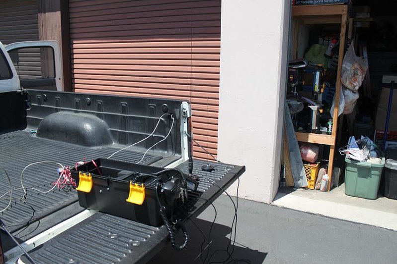

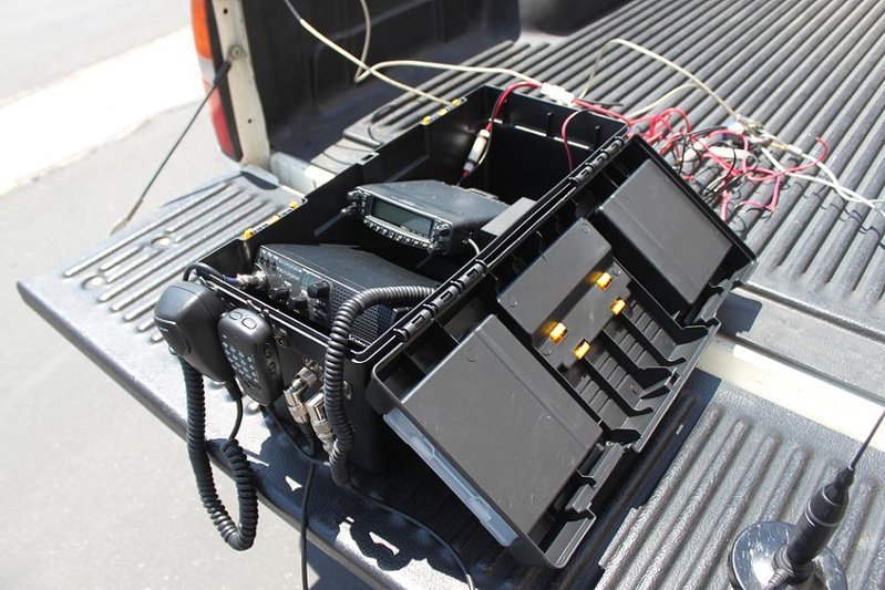

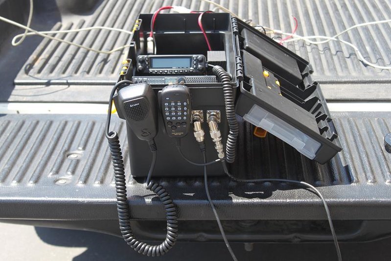

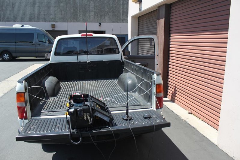

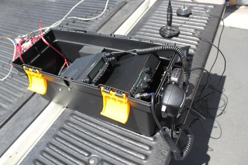

    Question, where did you get that 90* adapter and do you know the part number for it as well as the part number for the male connector at the other end? I have a project that I've been working on and that gave me some ideas that just might work for me. See the pics below for my project.
    It's basically my portable (well, sorta portable) emergency communications box that can be setup within a matter of minutes. It has a 4-band Yaesu 8900R and a Cobra 18WXSTii CB. So, it is a 5-band radio box. NOT everyone has CB and NOT everyone has HAM!!! I plan on, may be, switching out that CB for a CB model that has SSB as well. So, hopefully, may be, a 5-band HAM/CB radio box with CB SSB capability??? I don't know yet about that one. But anyways, that box is still under construction. I still need to buy 2x 12V Sealed Lead Acid batteries, charger, various misc parts, etc to complete it.
    NOTE: btw, pay NO attention to the 2ft CB whip, I only have that there just so that there is an antenna there. I get HORRIBLE SWR because of how most of the antenna is behind the cab structure. When out on a trail, I will, usually, switch it out to my 4ft CB whip. Other than that, I have the 2ft there due to my dumba$$ car port, LOL!!! I could get the quick disconnect, but that would mean to have to disconnect every time still and one day, I may forget... AGAIN... LOL!!! My mind is starting to "drift" a bit as I get older, LMAO!!! LOL!!! So, having that 2ft there, gives me piece of mind that I don't have to worry about TESTING ceiling height, LOL!!! I don't get to trail as much as I would like for various reasons.

    https://www.google.com/search?q=90+...&ved=0ahUKEwiqy7-Hn6vQAhWj7IMKHafvBxAQgTYIwgQ

    Actually I think I got it on Amazon but similar product. I had to resolder bc a wire broke from being moved around. That's why I mounted it so it doesn't move now
