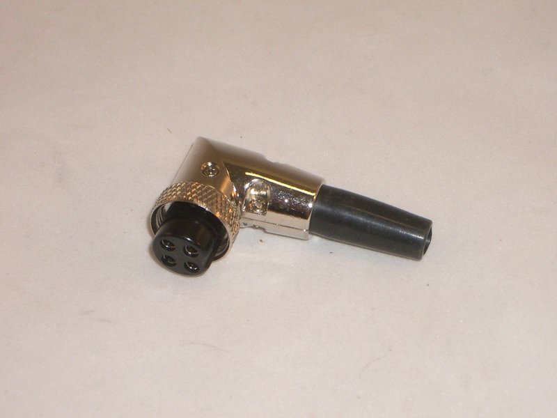

    Ryan, thank you for the help and idea. Here is what we were able to do today. There is an electronics store just a few miles away from me that has the EXACT parts shown in the pics and the other pics are the end result. The microphone attaches in the center console of Bryan's truck and you still have use of the 3 cup holders. Came out pretty SWEET! :thumbsup: Thanks again Ryan. :thumbsup::fistbump::cheers::bowdown:
    Happy Wheel'n man!!! :mudding:
    Btw, this was done on a 2nd Gen Taco.
    @ODNAREM Ron, this is what Bryan and I worked on for his truck this afternoon!!! Came out pretty SWEET!!!

    ^^Thought that first pic was a fancy "pipe".
    TXpro4X4 and WileECoyote like this.
  7. Nov 18, 2016 at 9:27 PM
    #627
    HalfWayThere
    HalfWayThere Well-Known Member
    Aug 16, 2015
    #161963
    792
    SLO, CA
    2016 DCSB TRDOR 4x4
    Ceci n'est pas une pipe
