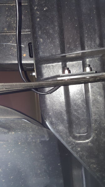

    remgu2000 Keepin' on keepin' on.
    Aug 29, 2016
    #195912
    1,568
    Ray
    Roswell, GA
    Used to have a 2017 Barcelona Red TRD Off-Road DCSB 4x4

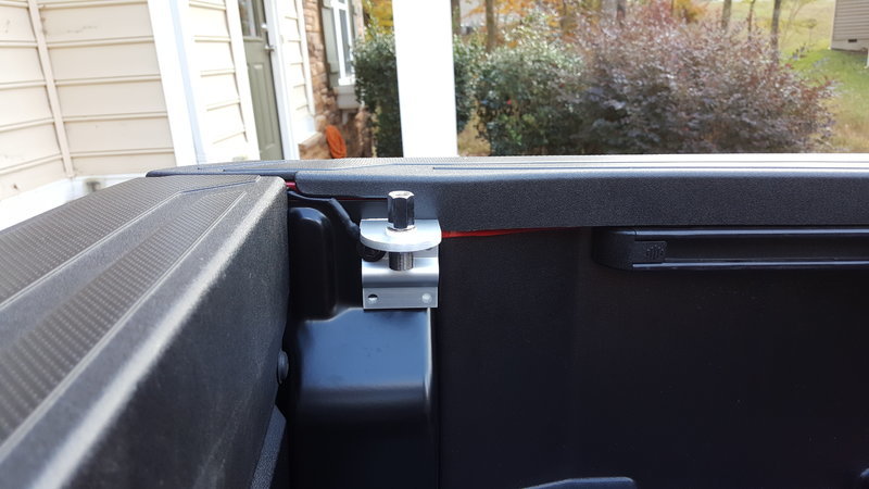

    UPDATE DEC 1ST 2106: DON'T DO THIS MOUNTING SOLUTION. IT DOES NOT WORK.
    Installed the antenna mount and grounded it to the frame.
    Snaked the wire through the light assembly area.
    This quarter panel attachment point actually has contact with the frame....per my ohm meter. I just need to get a cable cover for the exposed 10 gauge ground wire.

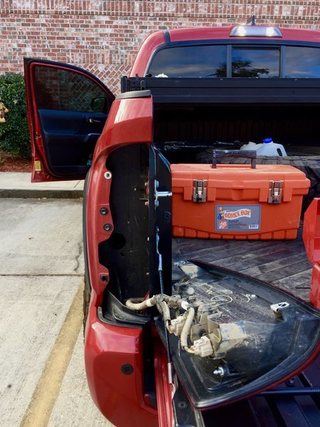

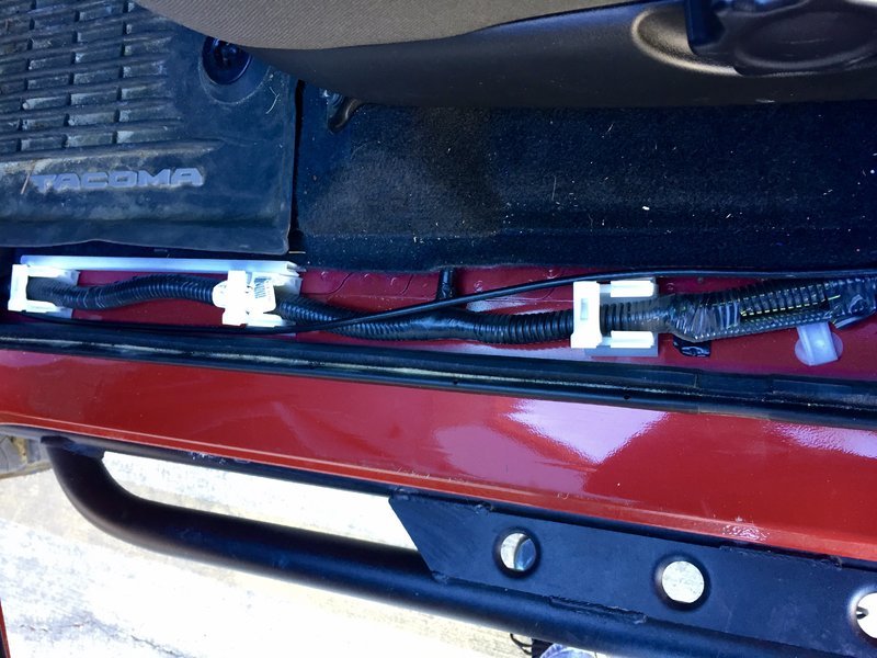

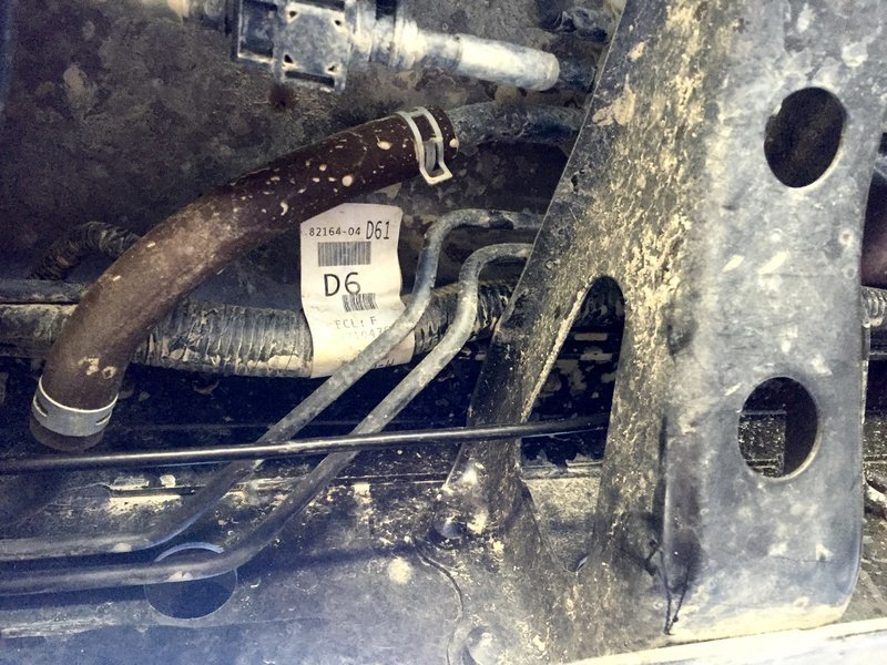

  6. Nov 19, 2016 at 11:22 AM
    #646
    LadyRed
    LadyRed Making all the right wrong turns
    Mar 30, 2016
    #182803
    1,692
    Leah
    Florida/Mississippi
    2016 4x4 TRD OR DCSB
    OME Lift Total Chaos UCA SCS Ray 10s

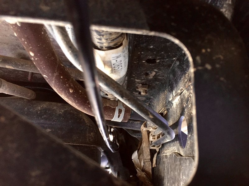

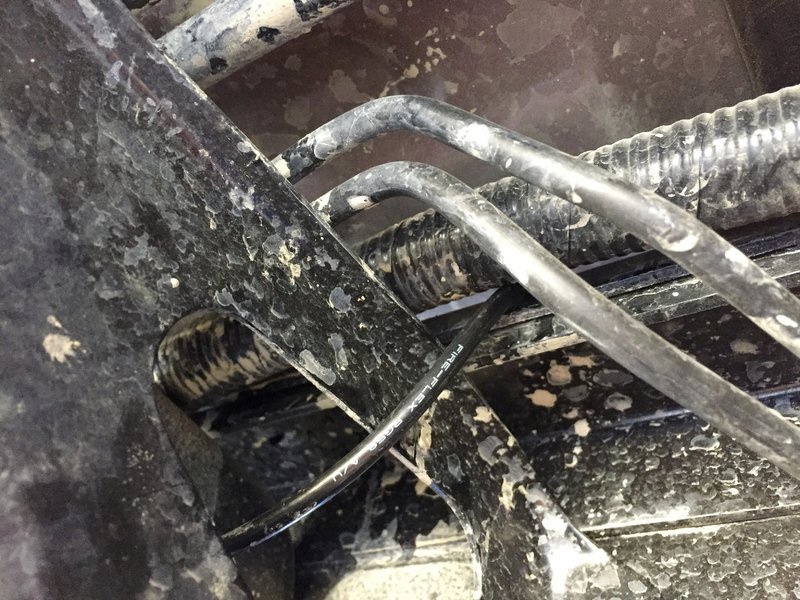

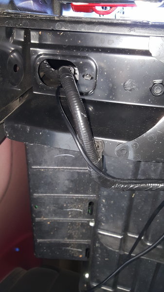

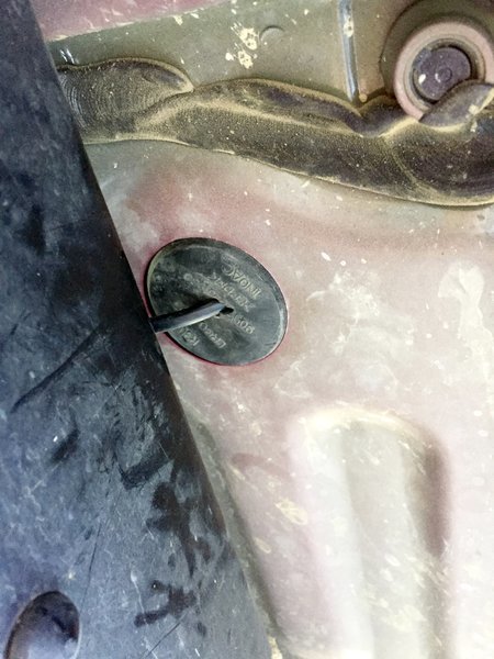

    Okay, here are some pictures of the install this morning. I stopped once I had the cable in the cab because my new radio hasn't come in yet and I don't want to route the cable under all the carpet until I know where exactly I will be placing it.
    Please excuse how dirty the bottom of my truck is.
    Step one - Remove tail light (Holy Smokes dust gets everywhere!!!)
    Step Two - Route cable along frame.
    Step 3 - Route cable over frame, cut hole in grommet, route cable through to behind driver's side seat.
    Step 4 - Route cable under door sill covers
    remgu2000, Pnwoutdoors and TXpro4X4 like this.

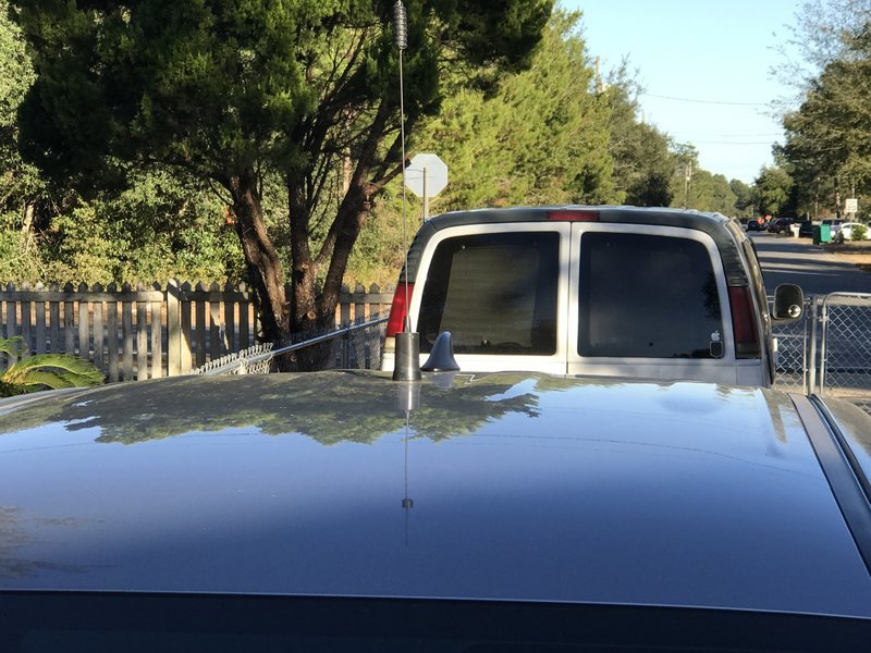

    Drilled a hole in the Taco roof and mounted a Larsen NMO antenna mount for my Yaesu radio.
