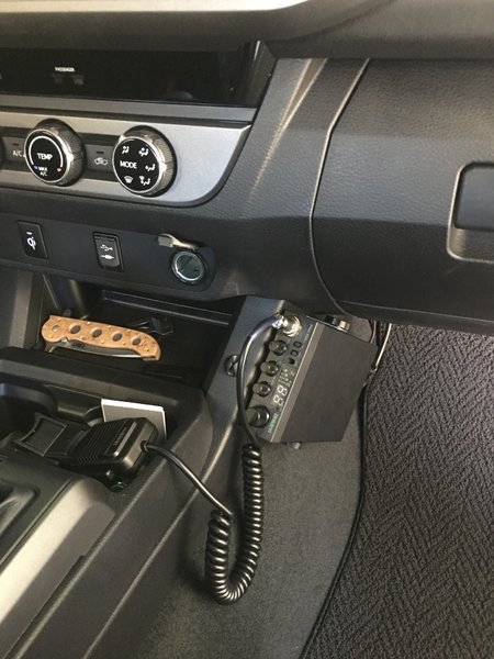

    You know what's funny is I don't have a pic of any of this and have had it in the counsel for a little while now.:facepalm:

    You cut out some of the bottom of the console and there was another 1.5+ inches? Hmmmm. That might be an idea if I can get the bearcat in their widthwise. It was too tall by about a half inch i think.

    Oh yhea. Mine would of stuck out for sure if not for the extra room down there. i also removed the counsel and measured the difference

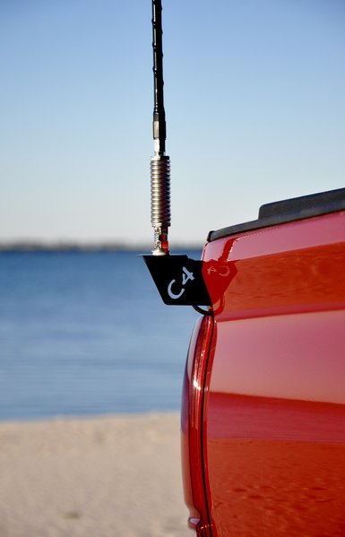

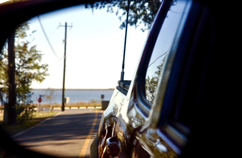

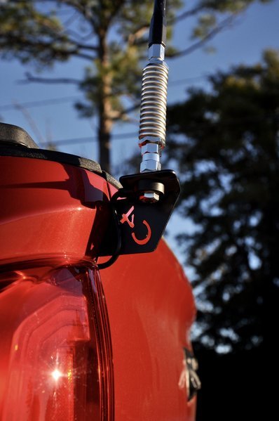

    Some cleaner shots of the finished look! Really liking the location of this mount. Great job @C4 Fabrication!DSC_0225.jpgDSC_0281.jpgDSC_0318.jpgDSC_0377.jpg

    Thanks for posting up the great quality pictures! they look awesome!

    Any possibility to make one that mounts to the bed rail?

    Lolll I asked the same question a few days ago... they said they were going to work on it.

    Yes we can make a bed rail version, but don't know how soon it will be available.

    Any chance you have photos of how you did the wiring for that mount location? I'm looking to put a 520XL in that same spot!

    Do you guys have the stainless steel version yet? Didn't see it on the site.

    Would be nice to have SS for the price, but I went ahead with purchasing the PO steel mount anyways. You can just hit it with an acid etch primer and then clear coat. Then, if you're really concerned for the bracket rusting, hit it with a light coating of fluid film (it is non conductive) applied with a paper towel or cloth. I plan on applying a light coat to my antenna adapter anyways just to help ward off any corrosion from the NE road salt. If there's anything I learned from years of sailing on salty bodies of water is the salt will always win, even if you use stainless everything!

    No we have not yet been able to make a stainless version.
