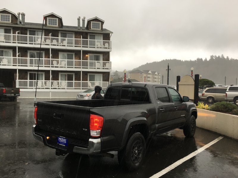

    At the coast today, so the pictures suck as bad as the weather.

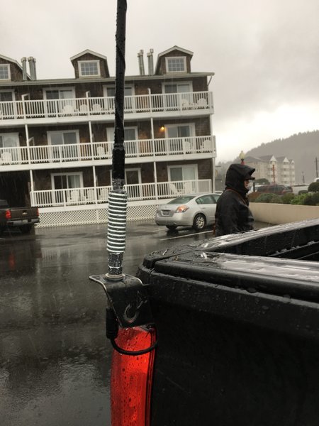

    Here's the @C4 Fabrication mount:
    Full antenna view. Canopy is due in a week or so. I'll get a better picture of it with a Leer when it comes:

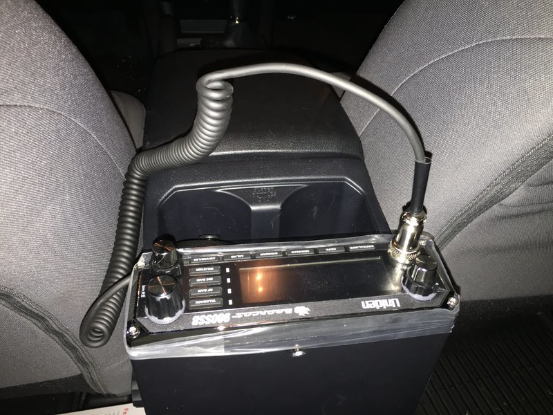

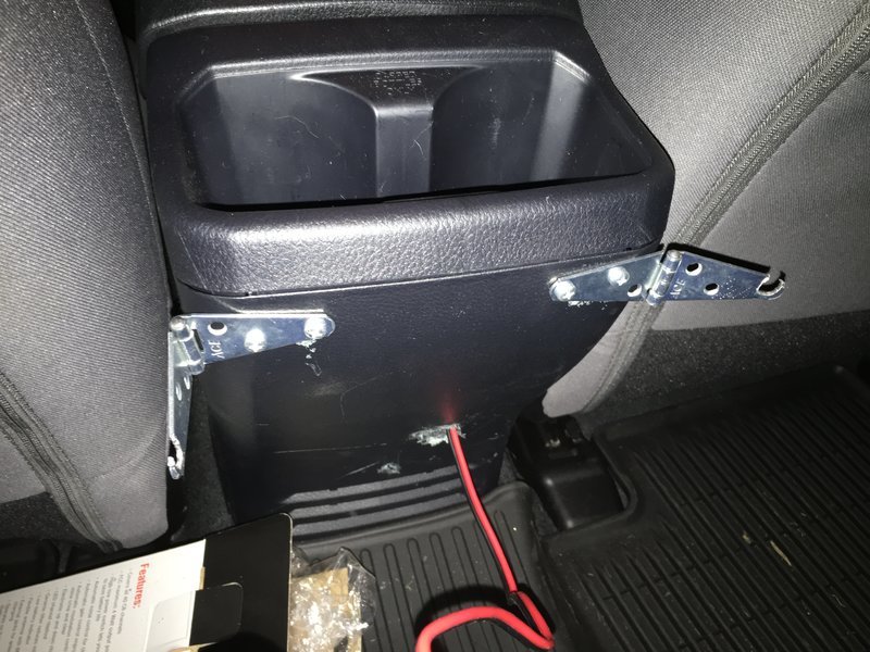

    Mounting the radio at the back of the console got in the way of folding the back seats, so I replaced the factory mount with a couple of hinges and drilled the top of the hole out so I could drop the radio in without totally removing the mounting screws. Easy in and out and fold the hinges to make room for the seat.
    With radio mounted:

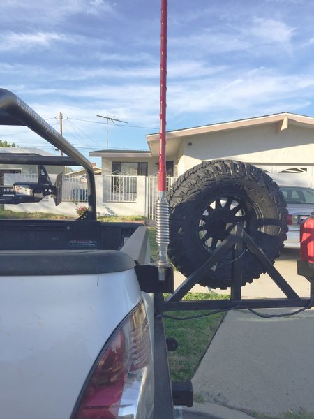

    I'm limited to where I can install my antenna. I want to install it at the driver's back corner of the truck using this mount:
    I have a cap, so I'm wondering what length antenna I should go with, a 3' or 4' Firestick ?
    ... and as to what strength spring, medium or heavy?
    ... and what brand is a good quality co-ax?
    I've seen Road Pro stuff on amabomb, but... ???
    TXpro4X4 and WileECoyote like this.

    You want the antenna to be "above" any "structure" as much as possible!!! I forget the %, but I believe a half or more of the full length of the antenna above a "structure". From the picture, I would do a 4ft antenna.
    Regarding the spring, it all depends on the length of the antenna? For a 4ft, I would, my humble opinion, go with a heavy duty! GET STAINLESS!!! TRUST ON THAT!!! If you go medium, your whip will be swinging a bit too much, in my humble opinion. Some people like that look though?! :notsure:
    Hope this helps a little? :thumbsup::fistbump:
