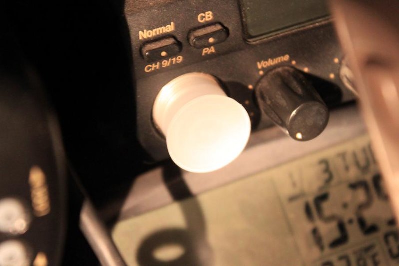

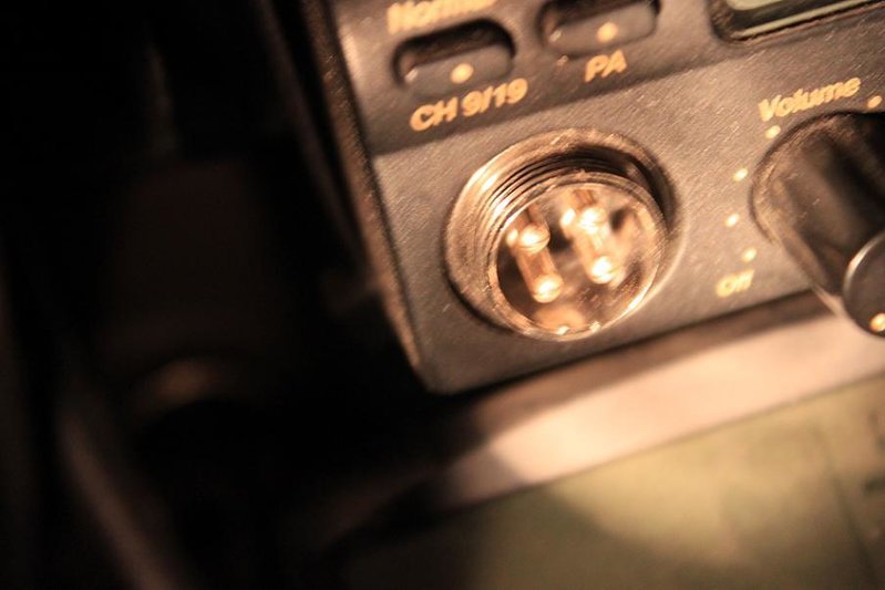

    btw, I think I found a cap for you that might actually work if you haven't already found one?! It fits over the actual threads of the "male end" of the CB MIC!!! I have 2x of these caps and don't know what they're from, LMAO!!! I'm a natural "hoarder" bro, LMFAO!!! If it works, then see, I KNEW it would come in handy one day, LOL!!! ROFL!!! see the pics
    TXpro4X4[QUOTED] likes this.

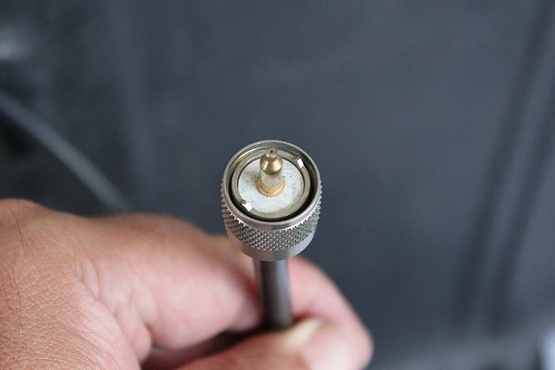

    LOL, my dumba$$ did the opposite, LMAO!!! That thought never even occurred to me???!!!But, the type of heat shrink tubing that I have has a "glue", if you will, on the inside, so it is protected quite well. You can sorta see the heat shrink tubing just under the re-crimped connector in the second pic below.
    I MOST DEFINITELY AGREE with the soldering comment!!! :thumbsup: I had to solder some RG8x cable to a connector for a project I'm working on and man was it a MAJOR PITA!!! LOL!!! So, yeah, if you have to solder it, it is NOT the easiest to work with as far as soldering goes, at least for my 20+ yrs worth of soldering experiences!!! LOL!!! I've had harder soldering jobs, but didn't expect this one to take as long as it did... I was like, W...T...F... DUDE!!! LMAO!!!
    LOL!!! SMART MAN!!! ROFL!!! :thumbsup::fistbump::bowdown:
    ANOTHER SMART MAN!!! LOL!!! :thumbsup::fistbump::bowdown: I hope all works out for you!!! :thumbsup::fistbump:
    Here's my recrimped connector. I have the tools to do such a job, but most people would use it only once or twice so it wouldn't be too good of an investment for most people. But yeah, been that way for 4yrs now maybe and no issues... but again, I have the tools/resources as most people really don't. Plus, to start, as always, the tools tend to be a bit on the pricey side of things, LOL!!!

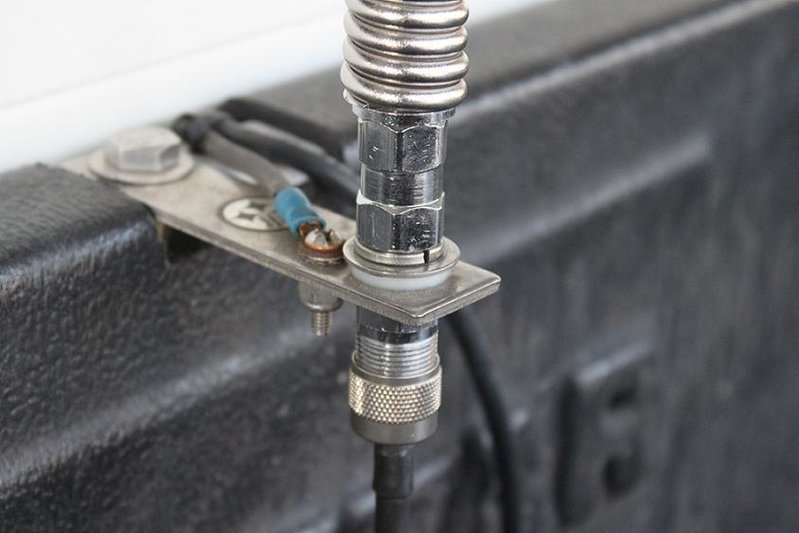

    @WileECoyote
    Is it better to have a co-ax with the ground wire? I thought that the bracket bolted to the metal bedsides is the ground.
    ... and if you hit it with a blast of Rust Check or Krown rust proofing spray it won't ever rust. ;)

    You're correct about that, but I wanted to ensure a GOOD SOLID GND connection. I've done ohm readings and got the same results, so, to answer your question a bit more direct, no you really don't have to do it... "I" just wanted to have it that way is all. :thumbsup:
    Again though, just make sure that 1/2 or more of your actual antenna is above any "structure". If it is a tunable antenna, which most are these days (i.e. with the tunable "lug bolt" that is built within the antenna itself), then you can correct your SWR readings to accommodate for that. BUT, you do NOT want a good majority of your antenna being "blocked" because even a tunable isn't going to help out all that much, if at all!!! Your SWR readings are going to be quite HIGH whether it is a tunable or not!!! So, I can't express that importance enough!!! :thumbsup::fistbump:
