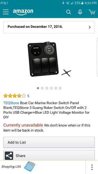

    I put a cheese switch.
    Ill look for a pic to what im going to go with for all my shit.
    Just have to find a spot

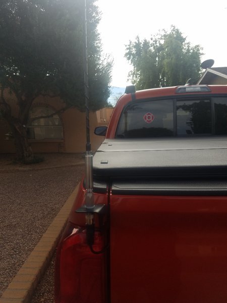

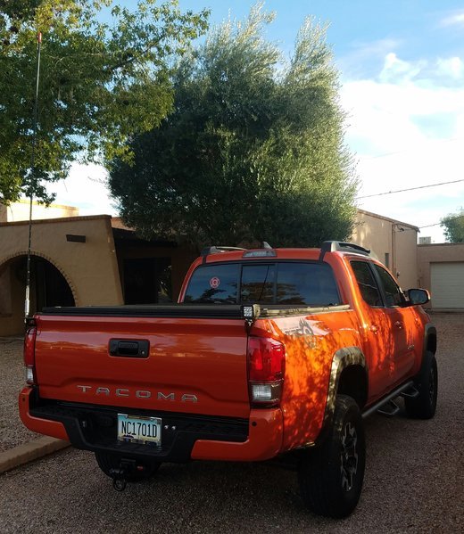

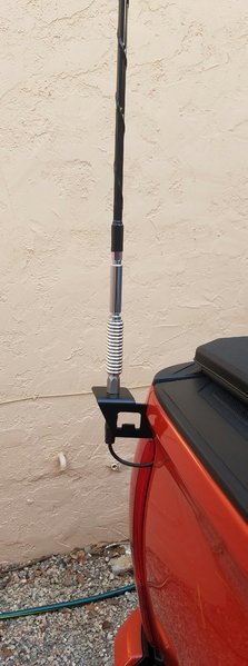

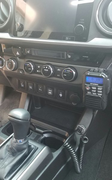

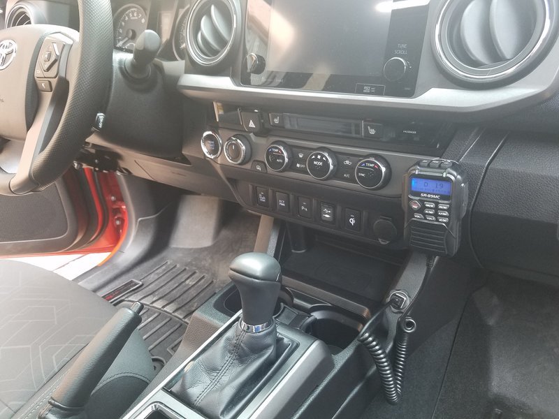

    Well I changed my mind again and just decided to head out to Big Rig Radios this morning after work. I ended up with a 4' flexible firestik firefly antenna. Zeke at BRR recommended this setup since it doesn't use a spring which he said can act as a load coil and hurt performance. He tuned the system up and got my SWR down to 1.05! I'll keep the exact distance to myself but transmit and recieve distances are outstanding for 11 band considering the antenna and questionable ground plane with a tailgate mount. Super Happy with the setup now!!!
    One more pic since I'm pretty proud of this install:D

    I installed the same mount with a 4 foot firestick, and noticed that the mount slightly flexes into the tailgate at highway speeds. I thought it looked tight, so I put making tape on either side, and sure enough, there was some rubbed off powder coating on the masking tape on the tailgate side. Are you having this problem?

    I haven't noticed any yet. I ordered the bare version and painted it on the truck. I'll let you know if I notice any wear.
