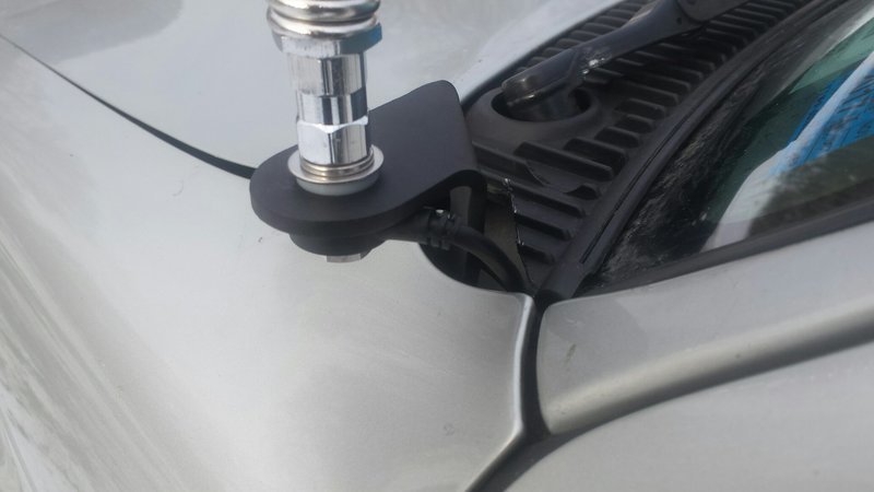

    I got a firestik and had to solder the end on that they sent. First time for everything and it WORKED,:yes:. Mounted to the CBI mount on the hood

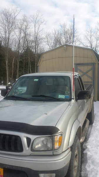

    1.6 across the board

    Need a shorter antenna thou. LOL 4' is a bit much.

    I wouldn't go any shorter than a 3' antenna! Your SWR is gonna start to go to shi*, even with a tunable. You're still fairly close to the cab (i.e. an interfering structure) for your RF.

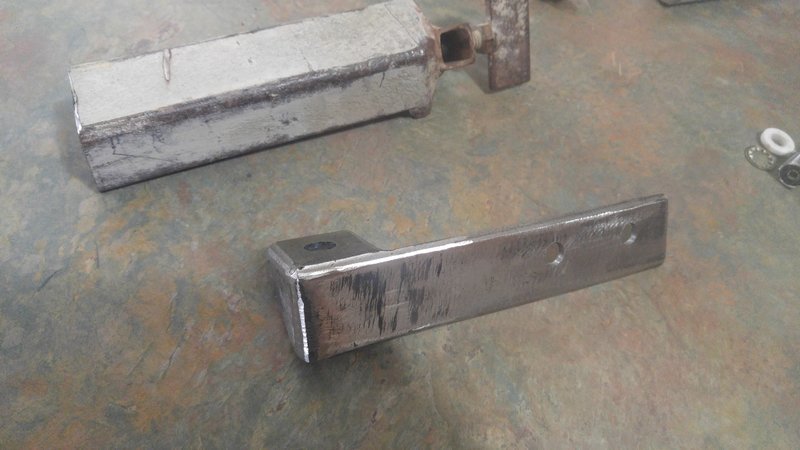

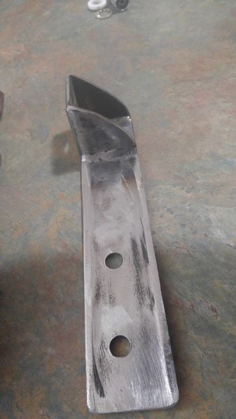

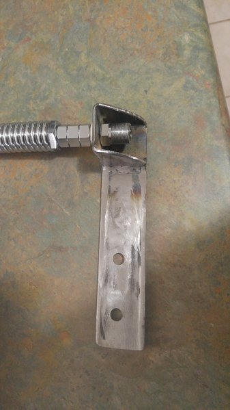

    Still gotta run it over the belt sander and paint but the bulk of the work on my mount is done
    The top is what I started with.... 1 1/2 " square rusty steel tube

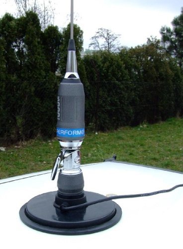

    I was gonna do a Galaxy 98VHP with the Wilson 1000. But instead put that in my work van with SWR 1.3.

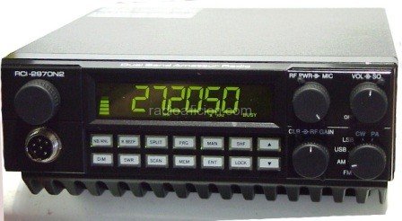

    But talked to Fine tune CB and was talked into the Ranger Rci2970N4. Having him tune it. Then matching it with the Sirio mag mount with the Sirio 5000 performer. He's changing the standard wire that comes with it to LMR240UF. Then using a external speaker behind the wireless Qi. Hope to get it high enough to hear it. Have no clue where I'm mounting the radio but I figure something out.
