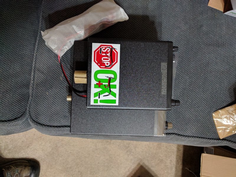

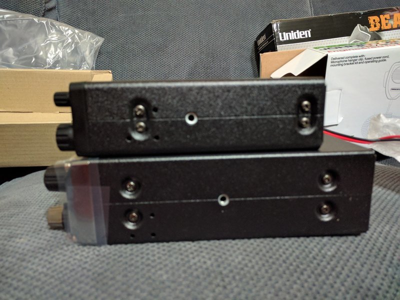

    Don't know what everyone was talking about....my 980 bearcat fits fine... :D
    Also purchased the wireless mic for $40 cad
    tgriff likes this.

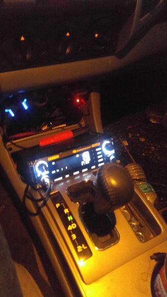

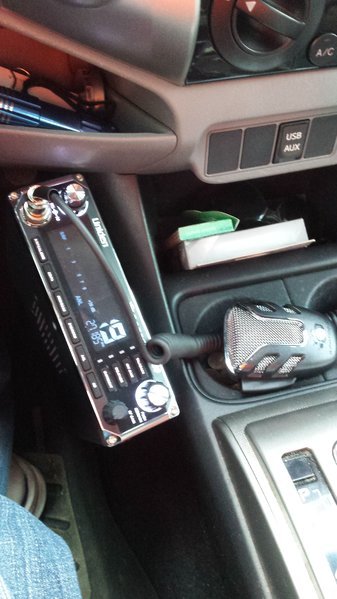

    Haha looks fine to me :rolleyes: I put my 880 on the center console near my right leg

    On or in the center console?

    Maybe center console was the wrong words lol, here's a pic from the drivers seat looking down. It works out nice too beacuse the mic holder mounts on the radio right near the channel knob

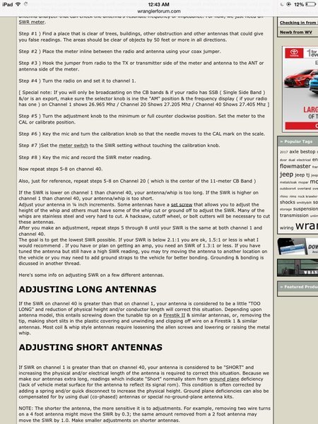

    Step #1 ) Find a place that is clear of trees, buildings, other obstruction and other antennas that could give you false readings. The areas should be clear of objects by 50 feet or more in all directions.
    Step #2 ) Place the meter inline between the radio and antenna using your coax jumper.
    Step #3 ) Hook the jumper from radio to the TX or transmitter side of the meter and antenna to the ANT or antenna side of the meter.
    Step #4 ) Turn the radio on and set it to channel 1.
    [ Special note: If you will only be broadcasting on the CB bands & if your radio has SSB ( Single Side Band ) &/or is an export, make sure the selector knob is ine the "AM" position & the frequency display ( if your radio has one ) on Channel 1 shows 26.965 Mhz / Channel 20 Shows 27.205 Mhz / Channel 40 Shows 27.405 Mhz ]
    Step #5 ) Turn the adjustment knob to the minimum or full counter clockwise position. Set the meter to the CAL or calibrate position.
    Step #6 ) Key the mic and turn the calibration knob so that the needle moves to the CAL mark on the scale.
    Step #7 )Set the meter switch to the SWR setting without touching the calibration knob.
    Step #8 ) Key the mic and record the SWR meter reading.
    Now repeat steps 5-8 on channel 40.
    Also, just for reference, repeat steps 5-8 on Channel 20 ( which is the center of the 11-meter CB Band )
    If the SWR is lower on channel 1 than channel 40, your antenna/whip is too long. If the SWR is higher on channel 1 than channel 40, your antenna/whip is too short.
    Adjust your antenna in ¼ inch increments. Some antennas have a set screw that allows you to adjust the height of the whip and others must have some of the whip cut or ground off to adjust the SWR. Many of the whips are stainless steel and very hard to cut. A hacksaw, cutoff wheel, or bolt cutters will be necessary to cut these antennas.
    After you make an adjustment, repeat steps 5 through 8 until your SWR is the same at both channel 1 and channel 40.
    The goal is to get the lowest SWR possible. If your SWR is below 2.1:1 you are ok, 1.5:1 or less is what I would recommend . If you have or plan on getting an amp, you need an SWR of 1.3:1 or less. If you have tuned the antenna but still have a high SWR reading, you may try moving the antenna to another location on the vehicle or you may need to add ground straps to the vehicle for better bonding. Grounding & bonding is dicussed in another thread.
    ADJUSTING SHORT ANTENNAS
    If SWR on channel 1 is greater than that on channel 40, your antenna is considered to be "SHORT" and increasing the physical and/or electrical length of the antenna is required to correct this situation. Because we make our antennas extra long, readings which indicate "Short" normally stem from ground plane deficiency (lack of vehicle metal surface for the antenna to reflect its signal rom). This condition is often corrected by adding a spring and/or quick disconnect to increase the physical height. Ground plane deficiencies can also be compensated for by using dual (co-phased) antennas or special no-ground-plane antenna kits.
    NOTE: The shorter the antenna, the more sensitive it is to adjustments. For example, removing two wire turns on a 4 foot antenna might move the SWR by 0.3; the same amount removed from a 2 foot antenna may move the SWR by 1.0. Make smaller adjustments on shorter antennas.
