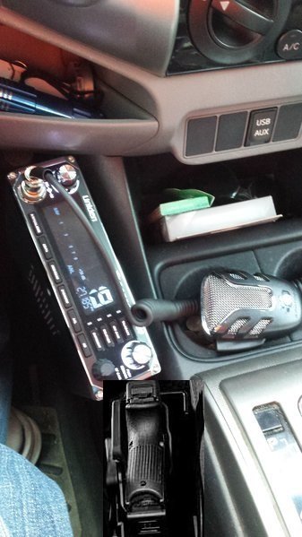

    Directly to the battery is best to avoid any RF interference and to make sure you have adequate power for transmiting. As long as your not constantly changing channels mounting to the back of the center console might work well with a radio that size. You could run your power wire though the console to the drivers footwell and out the firewall. Your coax could pass through the gromet under the passenger seat.

    I had mine mounted there, but I hated resting my leg against it. So I ended up getting a Midland 75 that lives in the center console when I'm not using it.
