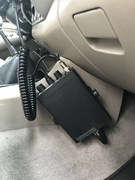

    I still think this place I mounted mine is the best. It's easy to see, and not in the way of the passenger. Could even be mounted with some double sided tape to avoid holes.
