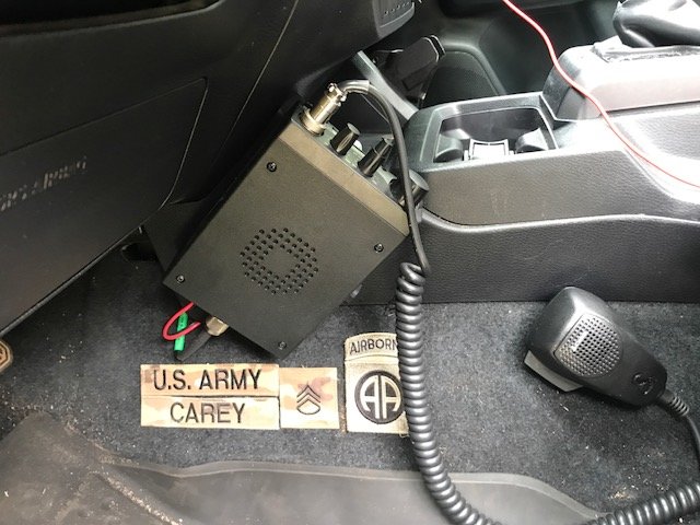

    @EatSleepTacos One last bit, do CBs have built in speakers or do you need an external speaker to hear audio output?

    They have built in speakers. Some are weak though, so read up on your specific one. Adding an external one is really easy and cheap, but for mine personally it's fine without it.

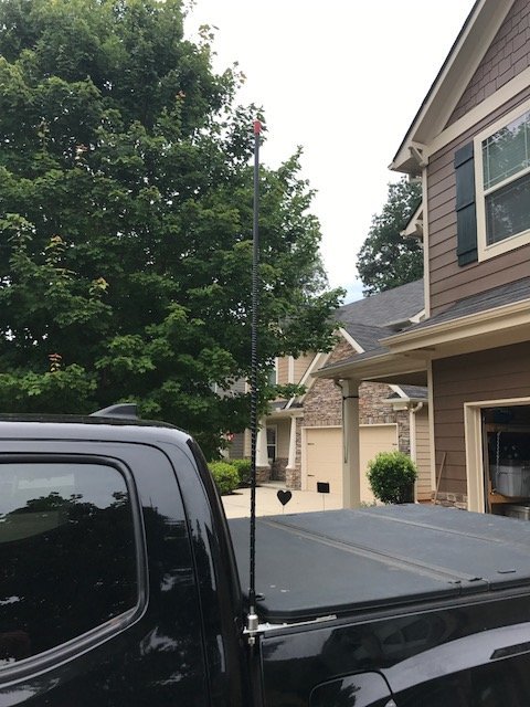

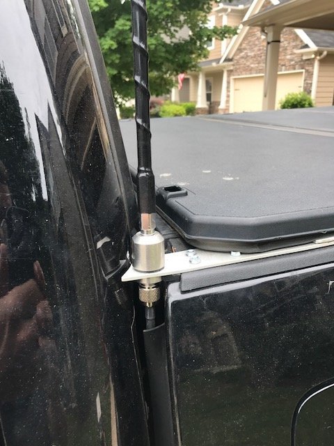

    This is my set up. I made my bracket out of flat aluminum and mounted it to the bed rail to behind the cab. Not much room. I still have to trim some and ground it. If the end result is good I'll paint the bracket. I can get some better photos if anyone wants them.

    Looks good but I'd be worried about it rubbing the cab with the bed flexs over a bumpy road. May want to put some sort of protection in there.

    Thanks man. I have tested it over some small hill and it does hit in a small spot. I have a bit more I can shave off the mount. I also have a spring for it so there are is another worrie it coming back and smaking the cab. I'll work through it and make some tie downs if needed. Work in progress
