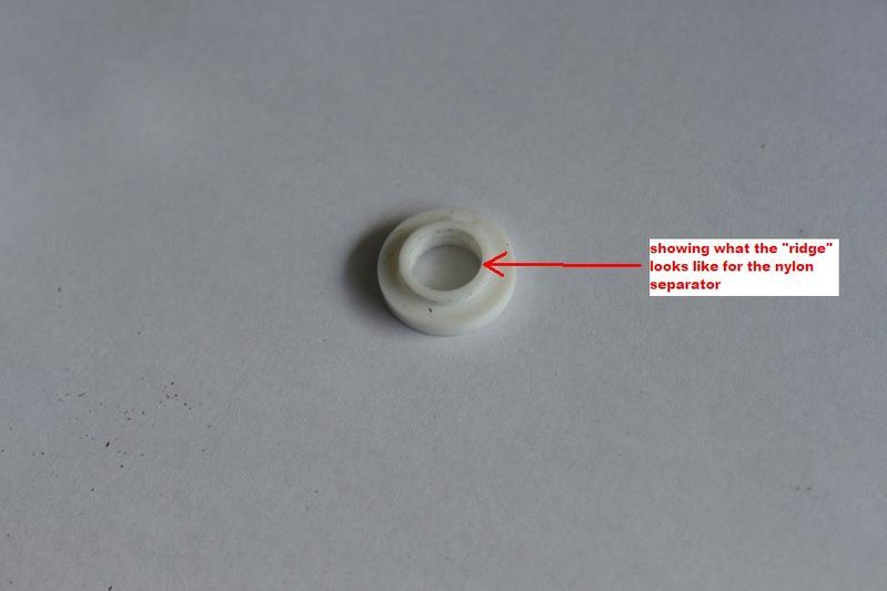

    Hey all so a few weeks back I took my truck to the exhaust shop and had to take off my antenna. Now I don't believe I lost any washers or anything but now I'm getting all kinds of interference like when I use the power windows or turn on AUX lighting. I have my antenna mounted to a BAMF tailgate mount........ PLEASE HELP

    Not sure good? ? I'll have to check tomorrow during day light. Do I need some sort of plastic washer between the antenna and antenna mount because right now it's metal to metal kind of but I feel like it's always been like that and it worked perfectly before I took off the antenna?

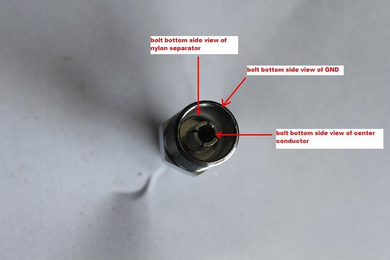

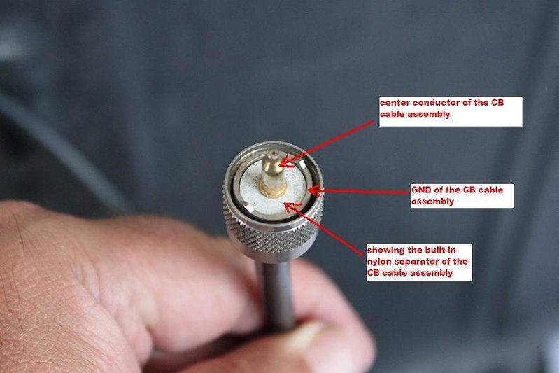

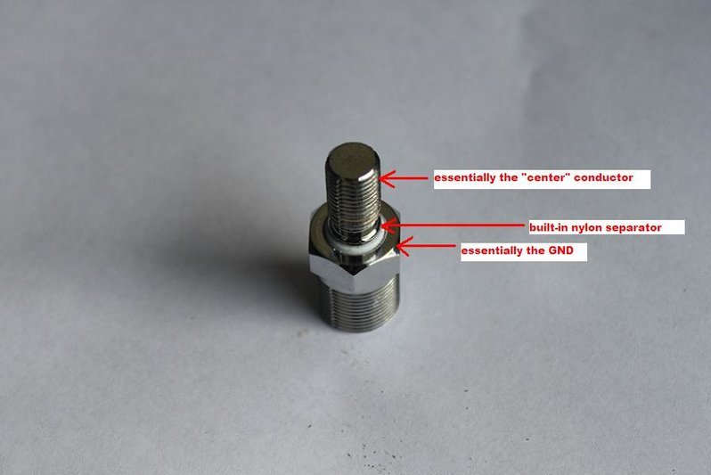

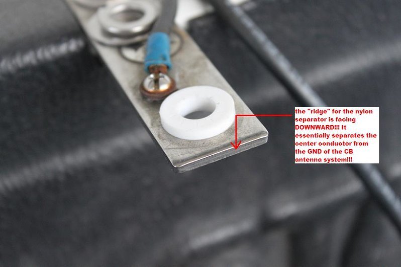

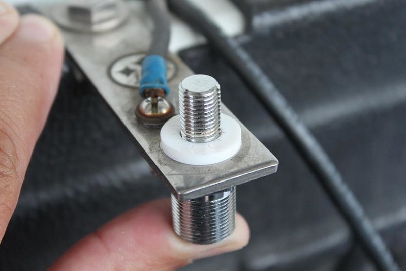

    Yeah the antenna stud should have a nylon washer. It insulates the center transmitting part of the antenna from the mount. It also goes on top as shown. I see it flipped quite a bit and it doesnt work like that :eek:.
    My theory is your truck was placed on a lift to work on your exhaust. The antenna was too tall so they temporarily removed the antenna while on the lift and forgot to replace the washer? Or.....its melted. Good luck:fingerscrossed:

    Yupp exactly it went on a lift so I took off antenna.. I thought I heard something hit the ground but wasn't sure hahaha guess I did hear something fall Thanks guys much appreciated I'm 90% sure this is my issue.
