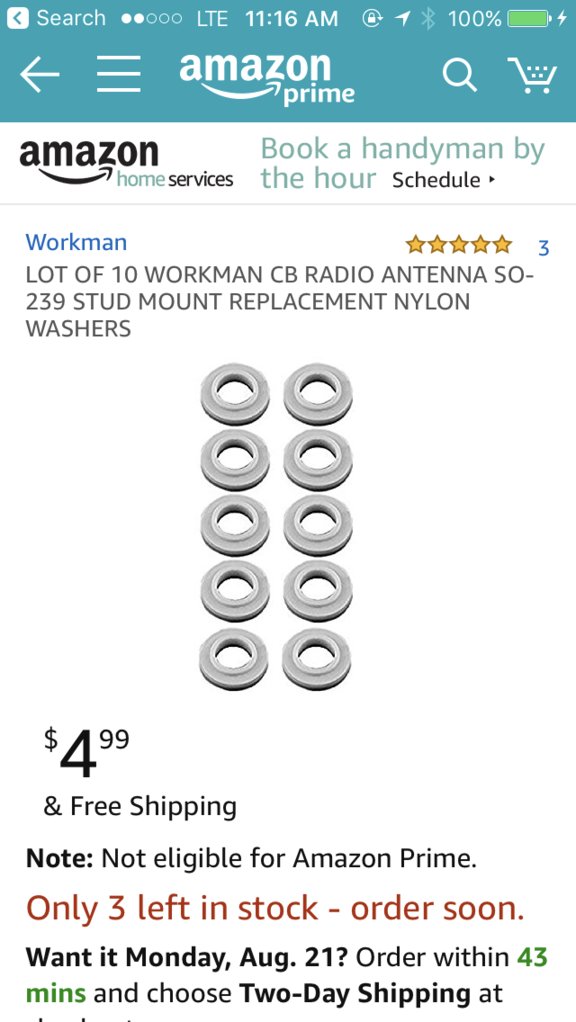

    Ya I appreciate it I'm not sure who but someone gave me the answer I was looking for, I'm definitely missing that plastic washer for the antenna that's where all my issues are steming from

    Yeah, I read that as well. Not having that nylon washer will short the center conductor of the antenna to GND!!!
    My guess is that when keying the MIC, the burst is outputting a very WIDE freq spectrum burst?! Just as if you were to scrape across batt terms with a file or even just a straight wire as it will output actual "RF noise"!!! But, at the same time, burn out your finals if you key your radio for too long. What's happening when you key your MIC is that whatever freq/ch you are on, the radio is essentially "vibrating" your antenna at that freq. When that freq is not efficiently transmitted it gets reflected back TO the radios output and eventually burns-up the RF amp circuit (i.e. the output finals) in the radio!!! That RF power wattage heat has to go somewhere if/when reflected back???!!!
    But, with that said, I too think it is unrelated, just weird you experienced it in the first place!!!

    Anyone know where to buy that plastic washer for the antenna?? Because I bought a new fire stick hoping it would come with it but of course it didn't. Or is it something I can make myself possibly? ??

    Thanks yous guys are wicked awesome.

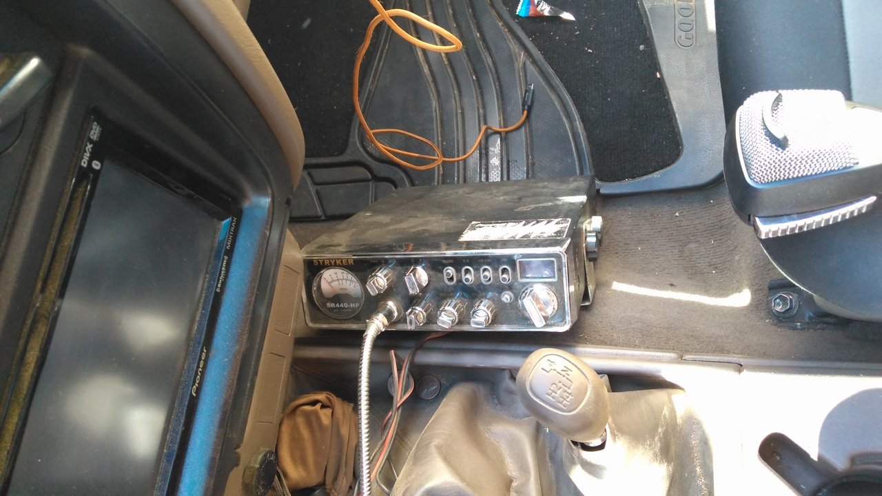

    I use a Stryker 440hp it's a 10 meter ham that is converted to 11 meter to talk on CB Channels. Also using Wilson 2000 Tucker antenna mounted on drivers front fender for hight issues. The radio is 60 Watts stock out of the box and has mosfet finals in it. It has the best modulation of any radio out there. This radio is not made any more but any new Stryker is bad ass.
