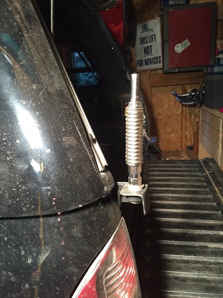

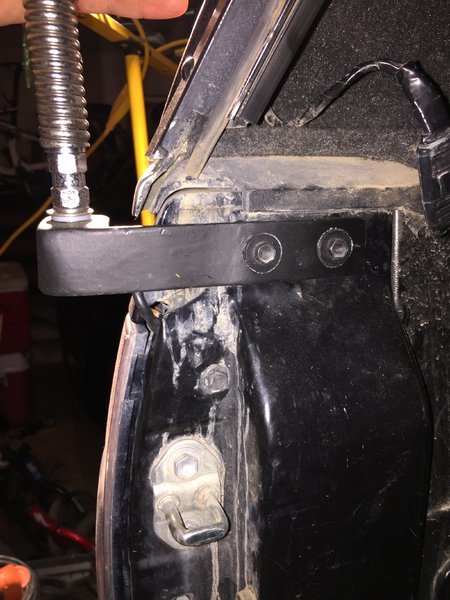

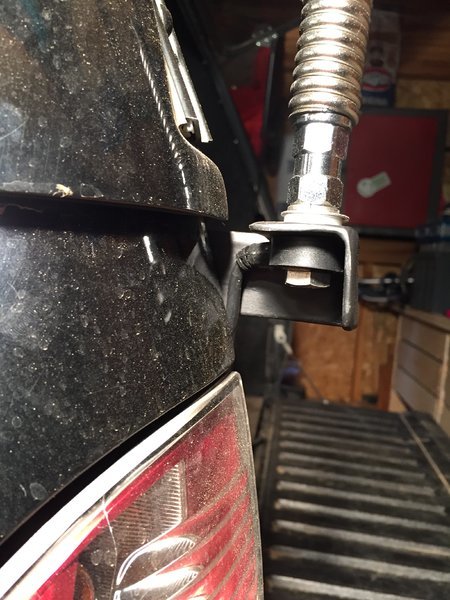

    I just installed a Cobra 75 wx st this past week with a 4' firestik. I was kinda nervous doing the install due to not being the most electrically gifted, but super straight forward. I went with the cobra 75 due to its size. I ended up making my own tailgate mounting brackets out of the half square bar that you can buy from Home Depot. Figured if it turned out like crap I would order one from BAMF, but pretty pleased. Just used my grinder to cut the top off on of the two sides for about 8 inches and then bent the remaining 2" end back on its self. image.jpg
    image.jpg Ran the coax into the tail light and followed the wires back to the drivers side door whe. I came up and mounted the small box to the bottom of the drivers seat. Then mounted the CB to the center console about where my knee is.
    image.jpg Then ran the electrical straight to the battery. Took about two hours start to install. Very clean and virtually out of sight which was a big part of my choosing the Cobra 75. I can also post more pictures of how I made the mounting bracket. Love it so far and im excited to really get to test it out on a trip up the Lost Coast next week!
  13. Jun 13, 2016 at 7:46 PM
    #113

    THAT looks pretty fricken SWEET man!!! :thumbsup::fistbump: Just AWESOME!!!
    You had me ROFL, LMAO with your comment!!! LOL!!! I got a HUGE LAUGH man!!! You can sure pass off as a fabricator though!!! VERY NICE indeed!!! Just AWESOME work!!! :thumbsup::fistbump::cheers:
    @kyle11863 Kyle, here is a possible solution for your antenna bracket. Zach just did an AWESOME JOB INDEED!!! I already have some of this angle iron that I can give some to you whenever we meet again? I'll definitely remember about it because I'm OCD like that, LOL, LMAO, ROFL!!!
