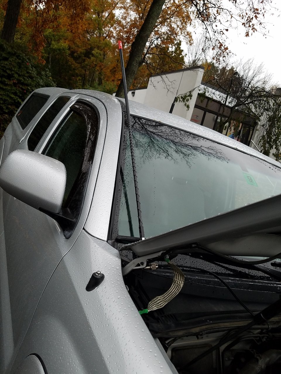

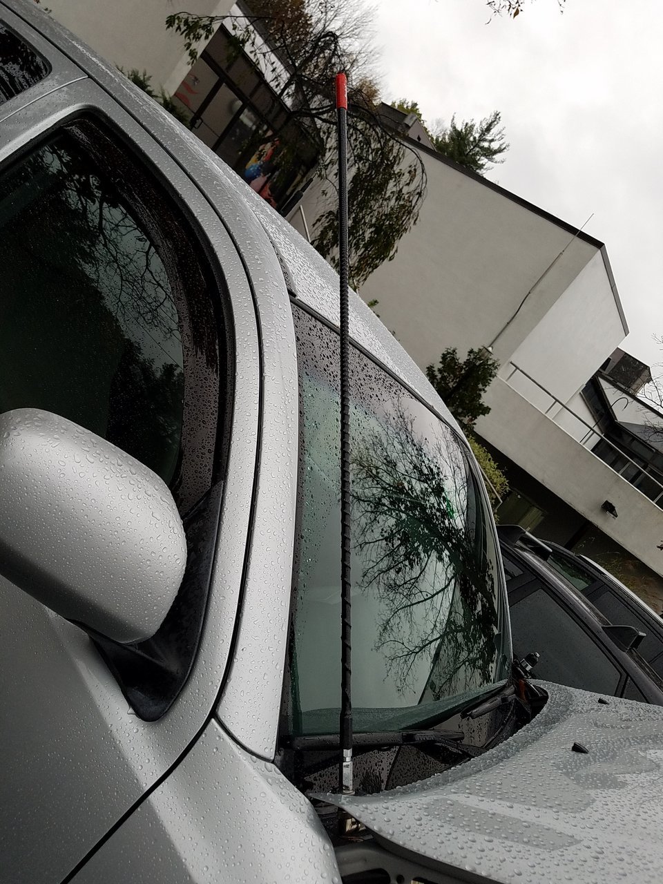

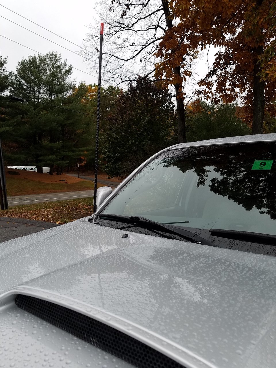

    3' 5/8 wave Firestick II mounted on a Relentless mount. (Nice Stuff, fits Excellent !) 20171029_164321.jpg 20171029_164255.jpg 20171029_164248.jpg
    I ordered my mount powder coated and of course then had NO ground. Had to scrape away some powder and some hood paint to make a good ground and also added a strap. I still can hear the wipers and some acceleration whine in the radio. :(

    Ok, you're absolutely right! Not arguing otherwise, even placing mag mount close to center of whatever.... point is, extension on (grounded) ditch bracket works fine with 3 ft cb antenna. Not too sure if it would work as well on 2m ham antenna, at least according to what I read.
    I tried mock up a bracket to fit behind the cab, but over rolled up tonneau cover. It was 6" high over the bed, even though I grounded it to the frame (12 ga wire) I couldn't get reasonable SWR readings. That was before I read up "ground plane"... but, we're talking 6" over soft tonneau and 5' of ground wire, not 2" (or so) over metal hood.

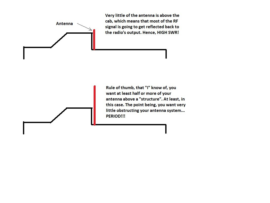

    So your CB antenna was, more or less, "next to a structure"? Sorry for the shi**y drawing, but I think you get the point:
    As an example, for the 1st picture, most of your RF signal is going to get reflected back to your radio's output. It doesn't matter WHO manuf your antenna, it is the environment, in this case the cab of the vehicle, causing the issue of a HIGH SWR!!! I know this for a fact as I have a small antenna because of the stupid car port. I know they make quick disconnects, but I just didn't want to have to deal with it day in and day out. I just wanted to have an antenna there for whatever reason. The best I could get for a "good SWR" was around 2.8-2.9!!! But, given the location and how much the antenna is being blocked due to the cab of the truck, I expected a HIGH SWR. I mainly just monitored the CB and only transmitted if anyone was in need of some sort of help, which actually happened. I was on my way to my sisters place and a trucker came on air asking if anyone could hear him? I replied back that he came in loud and clear and he then told me that he had the CB on for quite some time and no one was talking? He was wondering if something happened to his CB? When he gave me his location, he was roughly 2-3mi away. The point being, it still worked very well, but I kept my transmissions short because I didn't feel very comfortable with such a high SWR. Again, I just had it there just to have something there for the time being for parking purposes.
    Anyways, for the 2nd picture, this is my normal off-roading setup. I like my 4ft Francis antenna. :thumbsup: My SWR reading is well within reason, around 1.7ish, and I don't have to worry about ruining my radio.
    I hope this helps a little?! :thumbsup::fistbump:
