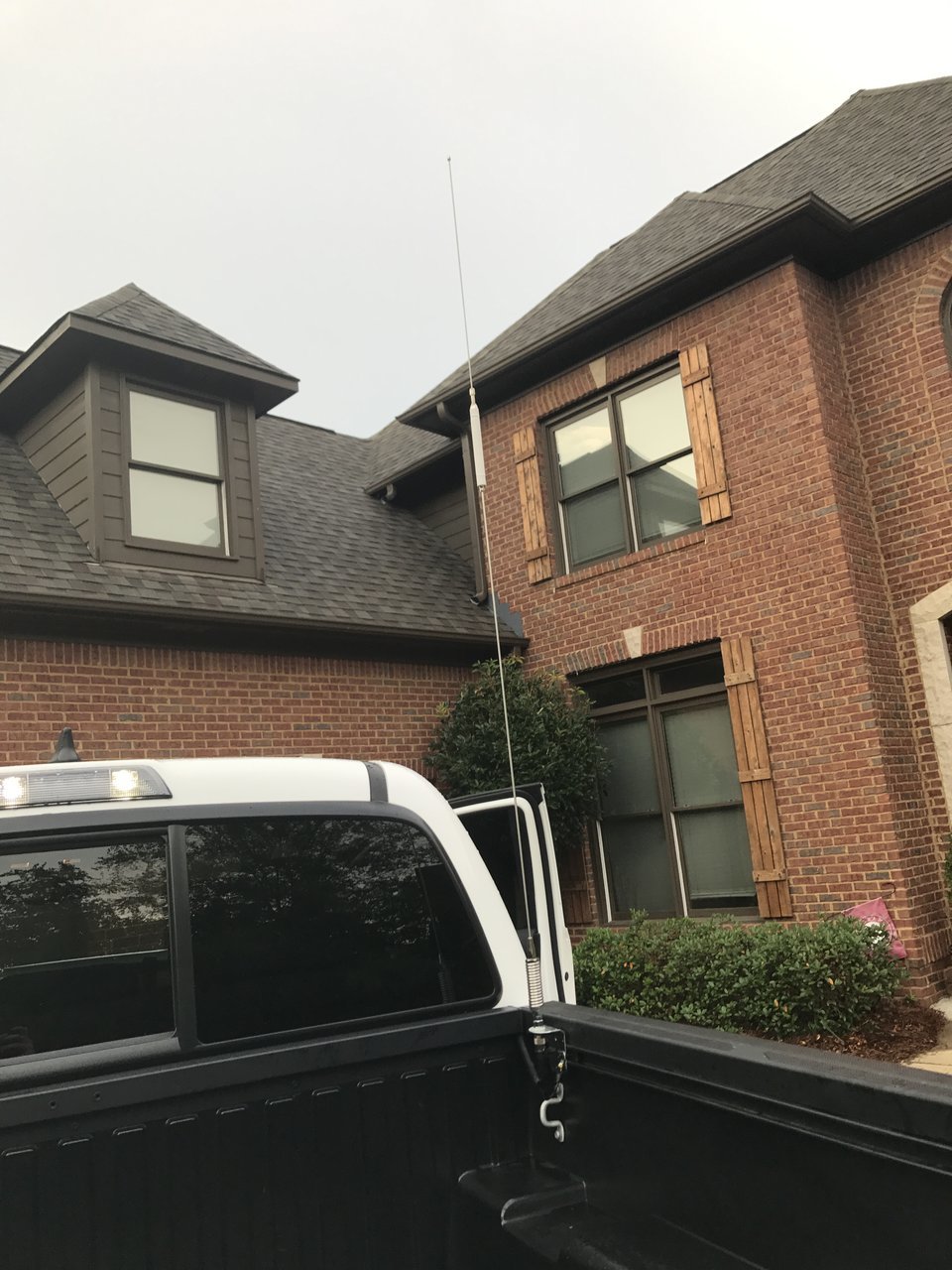

  1. Nov 2, 2017 at 10:28 PM
    #1201
    chrisrocks300
    chrisrocks300 War Eagle
    Mar 11, 2017
    #212994
    7,419
    Brandon, MS
    2016 4x4 Tacoma DCSB Trd Off-road Superwhite
    Total Chaos UCA's, Raceline Raptor wheels (16x8) 4.5 BS, 285/75/16 Cooper S/T Maxx tires, Icon Stage 2 Lift Kit, Sos sliders w/ fill plates, exhaust reroute, mobtown offroad skid plates (ifs, transmission, transfer case), and diff breather mod
    I have my antenna mounted like this, and when I had my 3’ firestik I had a range of 2-4 miles. I have a 4.5’ stainless steel centerload now and get 15-20 miles out
    WileECoyote[QUOTED] likes this.

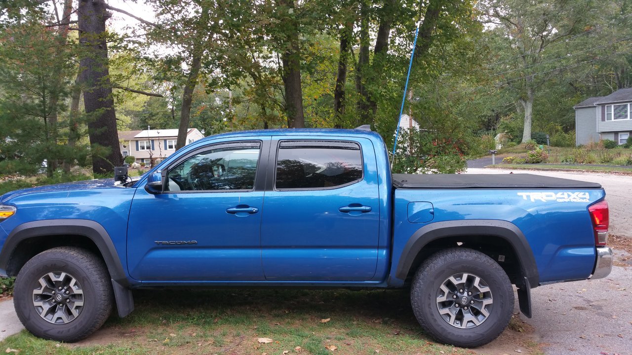

  4. Nov 3, 2017 at 6:30 AM
    #1204
    br636
    br636 Active Member
    Jul 27, 2016
    #193074
    26
    Brian
    2016 Black Tacoma TRD OR
    What kind of antenna mount are you using? Any pictures?

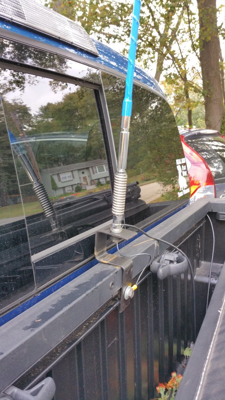

  6. Nov 3, 2017 at 7:00 AM
    #1206
    Bastek
    Bastek Average Member
    Jun 6, 2017
    #220876
    4,304
    Seb
    SI NY
    '17 OR dcsb
    KDMaxP10, plastidip
    The bracket was raised 6" and curved/angled back a few inches (to accommodate bed tent curvature) so it wasn't that close. Plus I used 3' Firestik, so I'd say 1/2 of it was sticking out over the cab. Yes, it is possible I had some signal bounce back. Also possibly didn't scrape enough paint to get better ground (I checked continuity between bracket and door lock strike, it checked out). After a while I gave up in frustration, and used 4" magnet. Tuned it below 1.5.

  7. Nov 3, 2017 at 7:03 AM
    #1207
    House Forsaken
    House Forsaken Well-Known Member
    Jan 22, 2016
    #175702
    777
    Paul
    2015 Tacoma TRD Off Road (Traded) 2017 TRD Off-Road (Traded) 2018 TRD Off-Road
    Homemade...

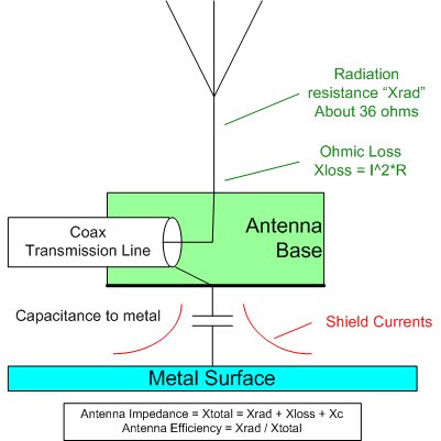

  8. Nov 3, 2017 at 7:36 AM
    #1208
    DaveInDenver
    DaveInDenver Not Actually in Denver
    May 18, 2013
    #104390
    3,619
    David
    Grand Junction
    2008 Super White TRDOR AC 6MT
    Unexceptional
    It's capacitively coupling the antenna to the vehicle, but your point is correct about the vehicle counterpoise. The magnet holds some sort of conductive surface parallel to the car sheet metal separated by fixed thickness of plastic. It's a very large capacitor. One of the reasons a mag mount stops functioning is the electrical insulation, usually a vinyl sticker, gets cut and shorts the intrinsic capacitor.
    http://www.cosjwt.com/index.php?a=3

  20. Nov 4, 2017 at 5:44 AM
    #1220
    DaveInDenver
    May 18, 2013
    #104390
    3,619
    David
    Grand Junction
    Unexceptional
    I believe the one in your photo is a Hustler HQ-27.
