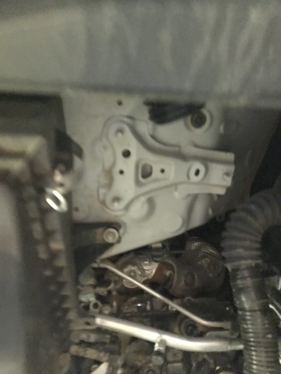

    I tried that and it stood out badly when looking at the grill

    That's too bad. Any way to mount it under the truck to the frame rails?

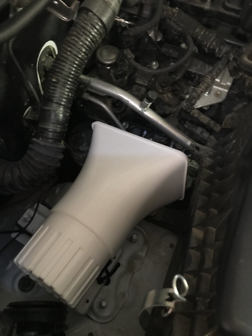

    I have too much armor, I’m thinking here behind the air box

    That looks like it'll work really well!

    It’s mounted like this now, much more stable

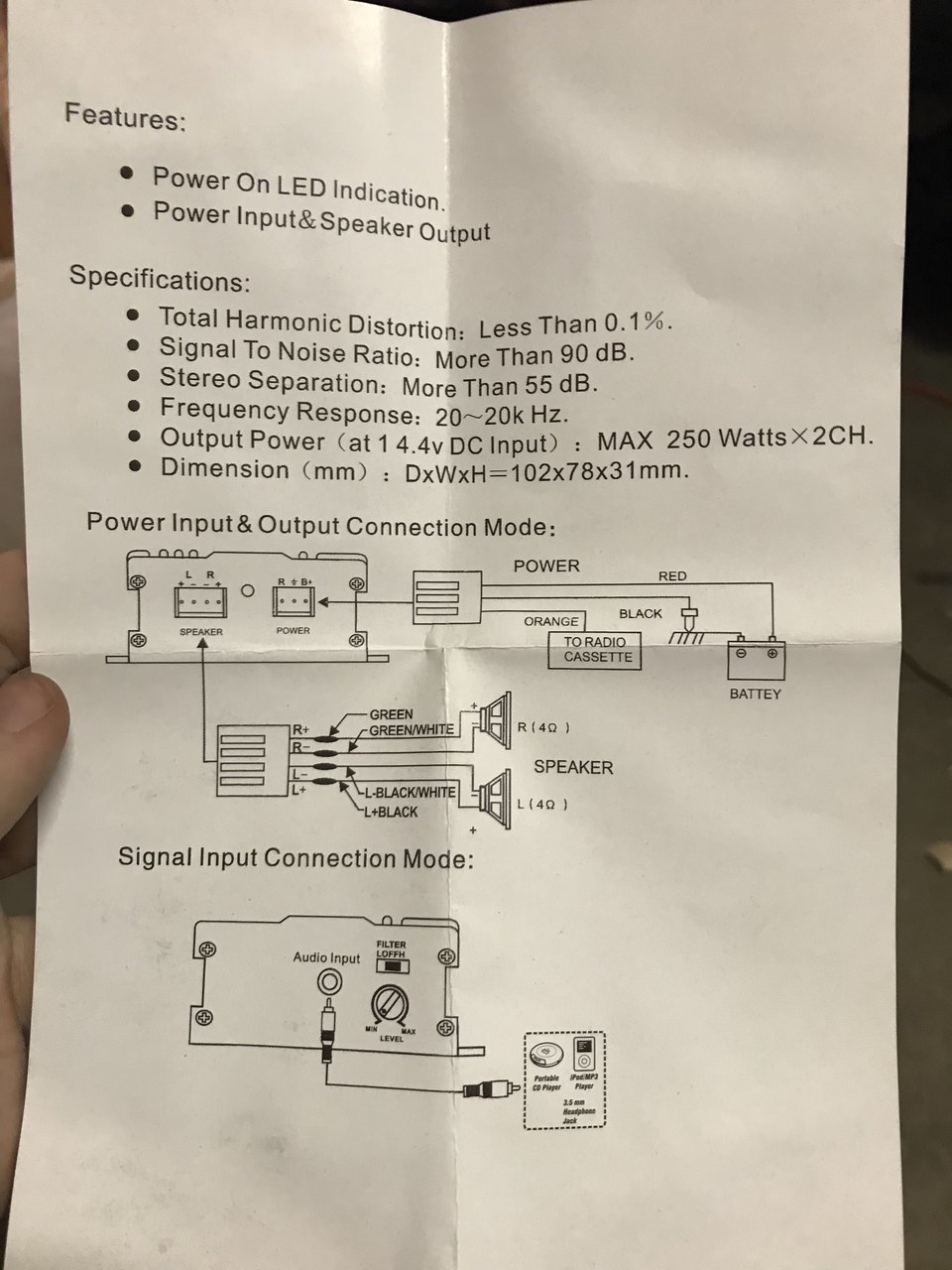

    This is time sensitive, someone please respond quickly. I have a power wire that is diagramed to have power run to the radio cassette as well as one just to the battery... could that be run to the battery with a 12v in-line fuse?

    Wtf, radio cassette? My guess is that wire is asking for a switched 12v, meaning a wire that only gets power when the truck is on. An add a circuit into the ACC fuse will accomplish that.

    Red wire to the battery?
    If so, YES by all means. You should install an in line fuse close to the battery connection!
    chrisrocks300[QUOTED] likes this.

    Whatever @EatSleepTacos said! Switched power. Do not connect it to the battery

    Ive got the exact same amp setup ready to install with my PA Speaker. I got a little different loud speaker though. I got this one https://www.amazon.com/SPECO-10-Wat...=UTF8&qid=1509846193&sr=8-2&keywords=speco+6"
    We have them on our work trucks and they are very loud. I thought about adding a bracket to my bed cage where I can take it on or off when I do or dont need it. I'm going to just add a simple switch to turn on the amp and PA speaker.

    No, but in my experience most, it not all amps are the same. They have a power line straight to the battery, a ground, and a "remote" which is a switched 12v that tells the amp when to turn on (I.e. when the car turns on).

    OH. It only needs a minuscule amount of power, similar to triggering a relay. A 1A fuse should be sufficient.

    Just wire it through a switch and put the orange and red together. Fuse the red on the battery side of the switch and your fine.
