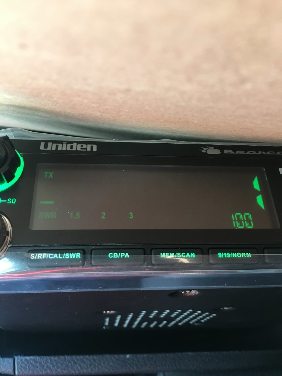

    Just a quick update... I plugged in my other CB and played with the tip of the antenna and I managed to get these readings. Pretty happy with them, but not sure how accurate they are. I do have an actual meter coming Tuesday so I'll verify the accuracy of the CB reading. Bottom right of the CB screen in the pictures shows the exact SWR reading.

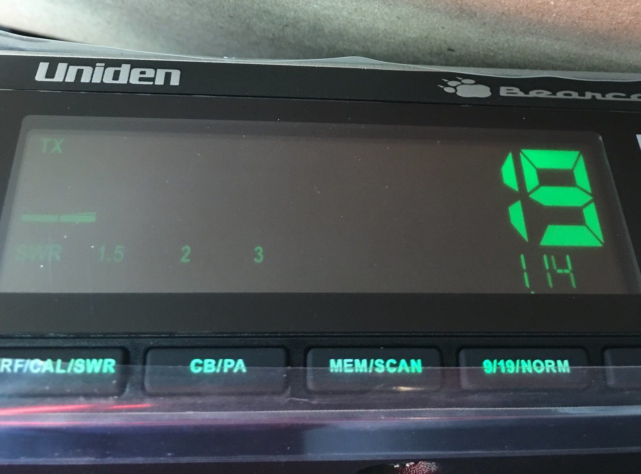

    Readings in my previous post are pretty accurate.
    Tested with a meter today and here's what I got, to compare to my last post.
    channel 1 = 1swr
    channel 19 = 1.3swr
    channel 40 = 1.9swr
    As you can see, the CB SWR meter was actually pretty damn accurate. Still glad I got a meter to have on hand for friends and if I need to re-tune/test ever.

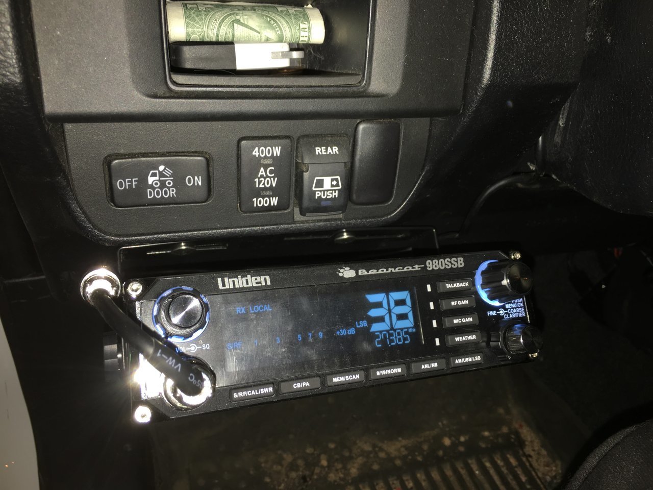

    Hey guys! Would the powder coated Relentless Fab Hood Mount sabotage the integrity of the ground?
    I running with a Uniden Bearcat 980 SSB, 3' Firestik Firefly, Firestik K-4A Stud, a 90 degree adapter and RG-58 Cable.
    So far, the best SWR reading I could get on CH20 was 1.6. CH1 and CH40 are both around 2.0-2.36. I also used a braided ground from the frame to the mount under the hood.
    Tomorrow I plan on stripping the powder coat. Hopefully to improve the ground of the mount???
    Any advice is greatly appreciated! I'm still reading through this 67 page forum for ideas.

    That's an interesting spot to mount the CB. Doesn't your leg hit it while getting in and out of the truck?
    Have you tried to adjust your antenna tip for a better reading? That's what I had to do to mine to get a lower SWR.

    Yes, powder coat will interfere with the grounding. Remove some from where the braided ground will attach to and I'm sure you'll see better results.

    It's actually quite nice. Most times I don't hit the radio with my legs (and I have huge legs). I used to have it near the E-brake. That was terrible and annoyed the crap out of me when I drove. Moved it to where I have it now and I am very content. There's an airbag near there. The radio slightly cover some of it. Hopefully I never get in a wreck and end up with a CB hitting my balls. Where did you place your radio?
    As for the SWR, I was only getting reading above 2.4 on the end bands (CH1 & CH40) with a 1.6 on CH20. I swapped out my 18' RG-58 coax with a 5' RG-8x coax, completely stripped the powder coating off the mount and my SWR went down to 2.0 on CH1 and CH40 and 1.42 on CH20. I used my dad's antenna analyzer rather than the radio to get these readings. I honestly think that's the best that I'm going to get. I'm unsure if I truly want to buy a 4' FireFly because this seems like a comfortable height for my offroading.
    This morning I received some skips on 38 LSB. I had two CB'ers acknowledge my callsign (732 Colorado). So, I guess my SWR isn't too bad with the right conditions.

    Thanks man! I actually removed all of it. Brought the SWR down more. Not as much as I wanted. SWR on CH1 & CH40 dead on 2.0. CH20 at 1.4. I used my dad's RigExpert AA-54 Antenna Analyzer to get a better reading on the antenna. With that all said, I received some DX this morning and two guys acknowledged my call sign. Pretty stoked about that. Should I buy the 4' Firestik? I'm thinking about keeping what I got and adding a HAM radio to my rig.
    By the way, what antenna are you using to get your SWR readings?

    Honestly, you should be getting pretty good readings (yours look good enough for me) if you have a solid ground and antenna over 2ft, which it looks like you have a 3'. I have a Firestik 3' and get pretty good readings. Did you play with the screw on the end of the antenna at all?

    I've got the antenna dialed in pretty well. Yes, I used the tuning screw. All done in an open field. I've grounded the mount the the frame of the truck with a braided grounding strap. I checked all continuity and everything seems to check out.
