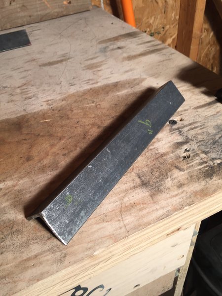

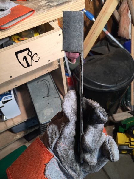

    Here's a few photos of how I made the mount. This one was for the passenger side to run a dune flag.
    I cut the half square to 9", defiantly will end up trimming but not knowing what I was really doing I figured is leave a good inch to play with

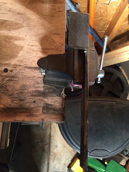

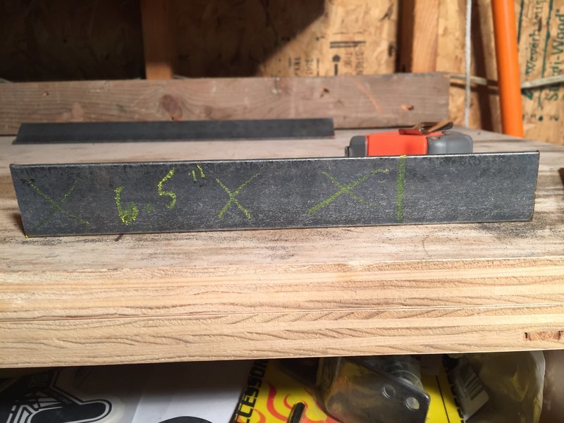

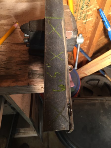

    I then measured 6.5 " from the end to cut off the top of the square bar
    From there cut off the 6.5"

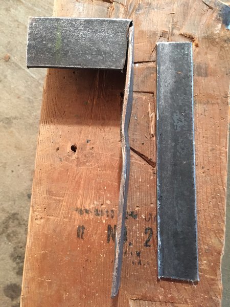

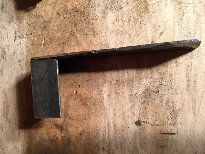

    After cutting then6.5" off should look like this. For drivers side, obviously would need to cut the other side to get it to face the proper way. Next is bending. I have a 6x6 post that I use as my "anvil" basically hammer the half square end back onto the straight single side. Takes a little bit of rearranging how you pound it but hit it hard!image.jpg
    Then if you notice there is a bit of an indent to there the bracket mounts to the truck. You'll need to offset the bracket in order to get the tailgate to close without hitting it. If you put the bracket in place you'll see where you should make the offset. Mark it and then I used he piece that I cut off as a base to pound. You can kind of see it in this picture. image.jpg
    The. The only thing to do is to drill your holes. For the two mounting holes
    I made 2, 1/4" and then a 1/2" for the antenna/flag. There is a slight gap/space between the mounting surface and arm of the bracket. Thought about soldering it sit to not having welding equipment, but seems very sturdy and didn't have supplies to do that. Only other thing was to prime and paint. Hope this helps and let me know if you need any more help or ideas!

    Oh and the only other thing I did was trim the length of where the antenna mounts by about 1/2-3/4" as to not stick out farther then needed and round all the edges

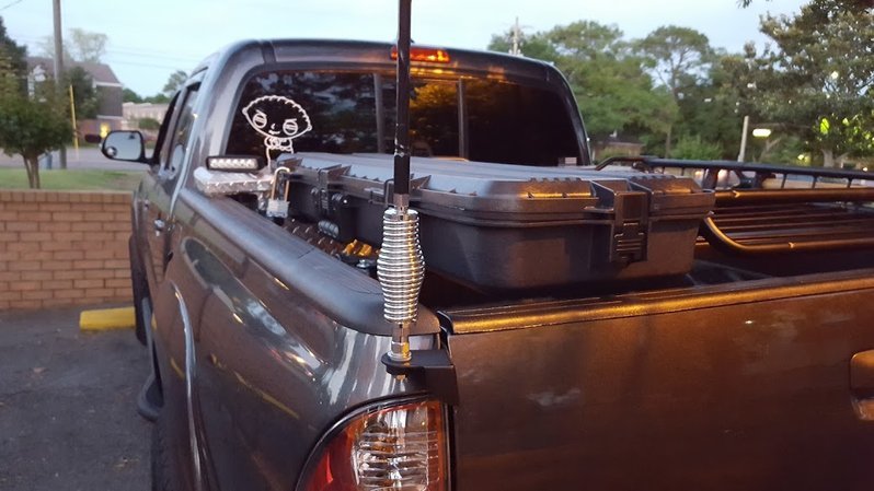

    I finally got my fire ring in today! I have started install/plumbing of electricals. I'm hoping it goes well! Y'all have helped a ton
