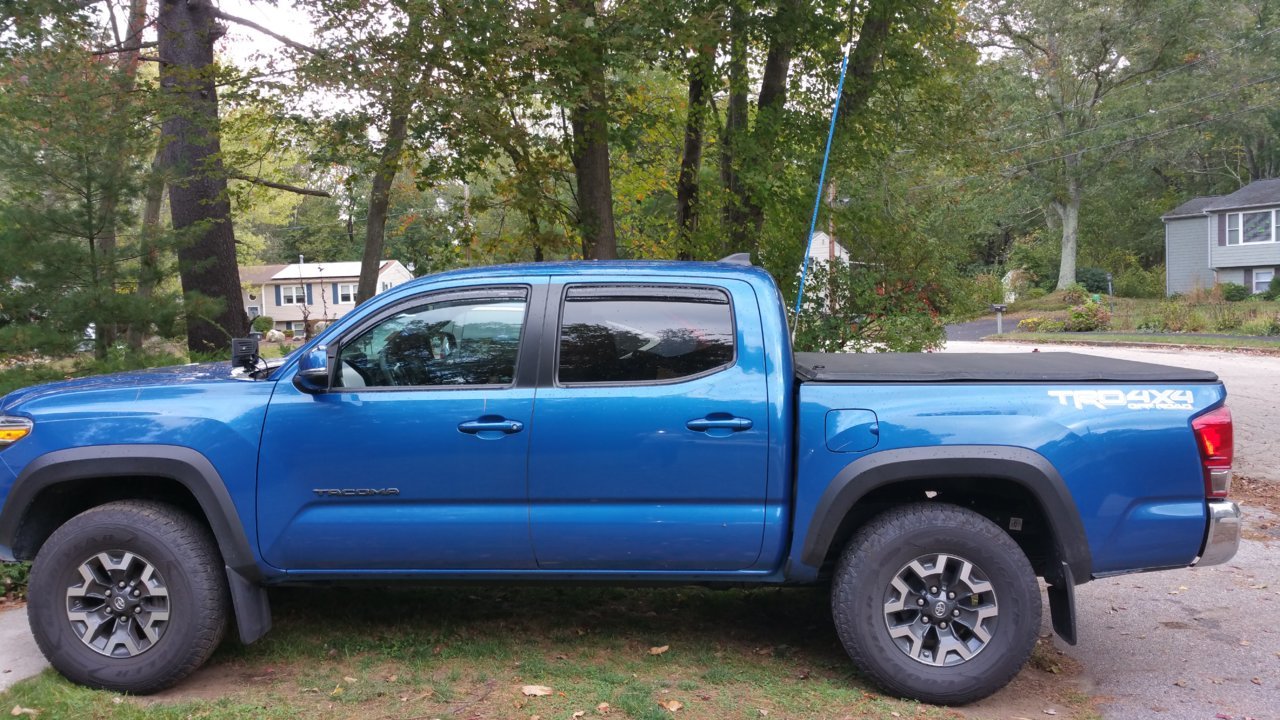

    Do you happen to have pictures of the 2 sizes? I'm slowly piecing together the components I need and I keep going back & forth on a 3' or 4' antenna. Any noticeable difference between the 2?

    3’ is pretty darn tall above my truck i definintly dont see me ever going to 4’

    I have a photo of the 4', I'll take one of the 3' and post them when I get home. For my purposes, there's no discernible difference other than range.

    Yup...the 4' is tall especially where I mounted it and on a heavy duty spring.
