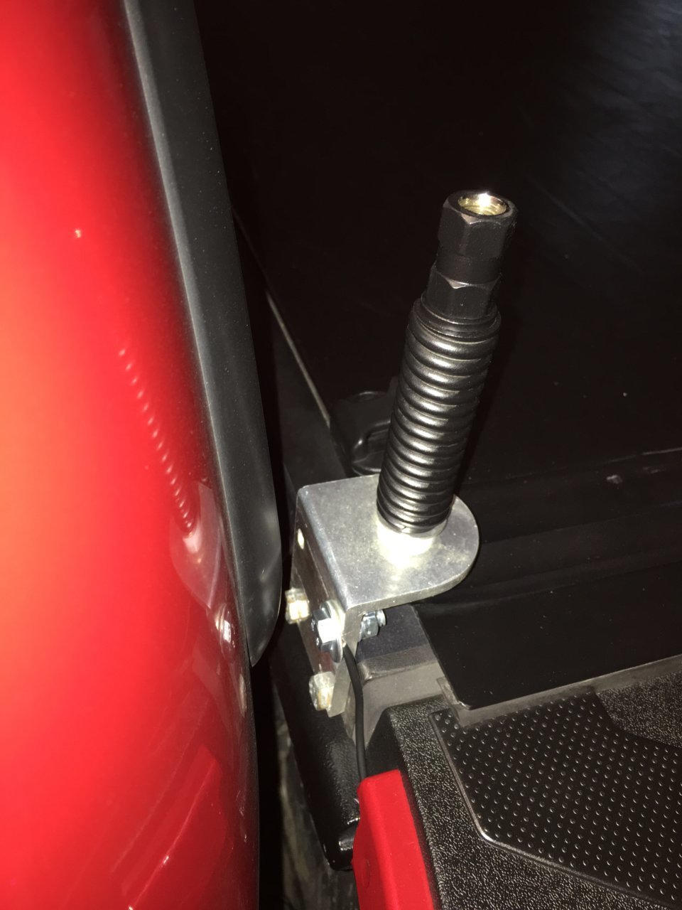

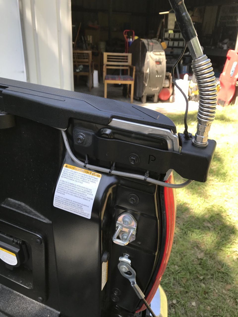

    I'm planning on at least running the antenna cable today and was wondering if I have the Caliraised Tailgate mount where & how would be the best way to run a ground? Everything I've read says the ground strap should be as short as possible. Would it work to run the ground with the antenna and attach it to some metal behind the taillight? I think I have most of the other stuff figured out it's just trying to make sure it's done right.

    Heres an idea that a customer has done
    micwillia[QUOTED] likes this.

    Thanks for the pic :thumbsup: I'm really hoping that the mount isn't going to rub the side of the tailgate Did a dry fit yesterday without actually attaching it, just holding it in the right spot but above the bolts and it looks really close. :fingerscrossed: Putting it on tonight & praying for the best especially since I already drilled the 1/4" hole to 3/8" :frusty:
