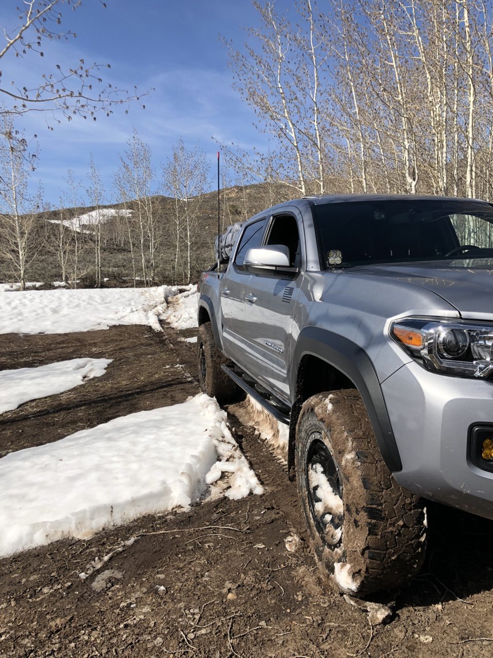

    Looks good. Do you have a picture with the antenna on?

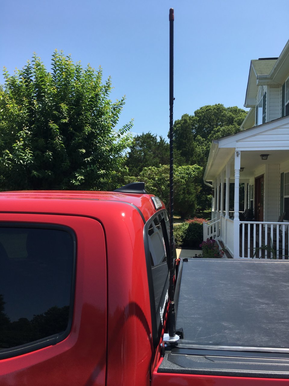

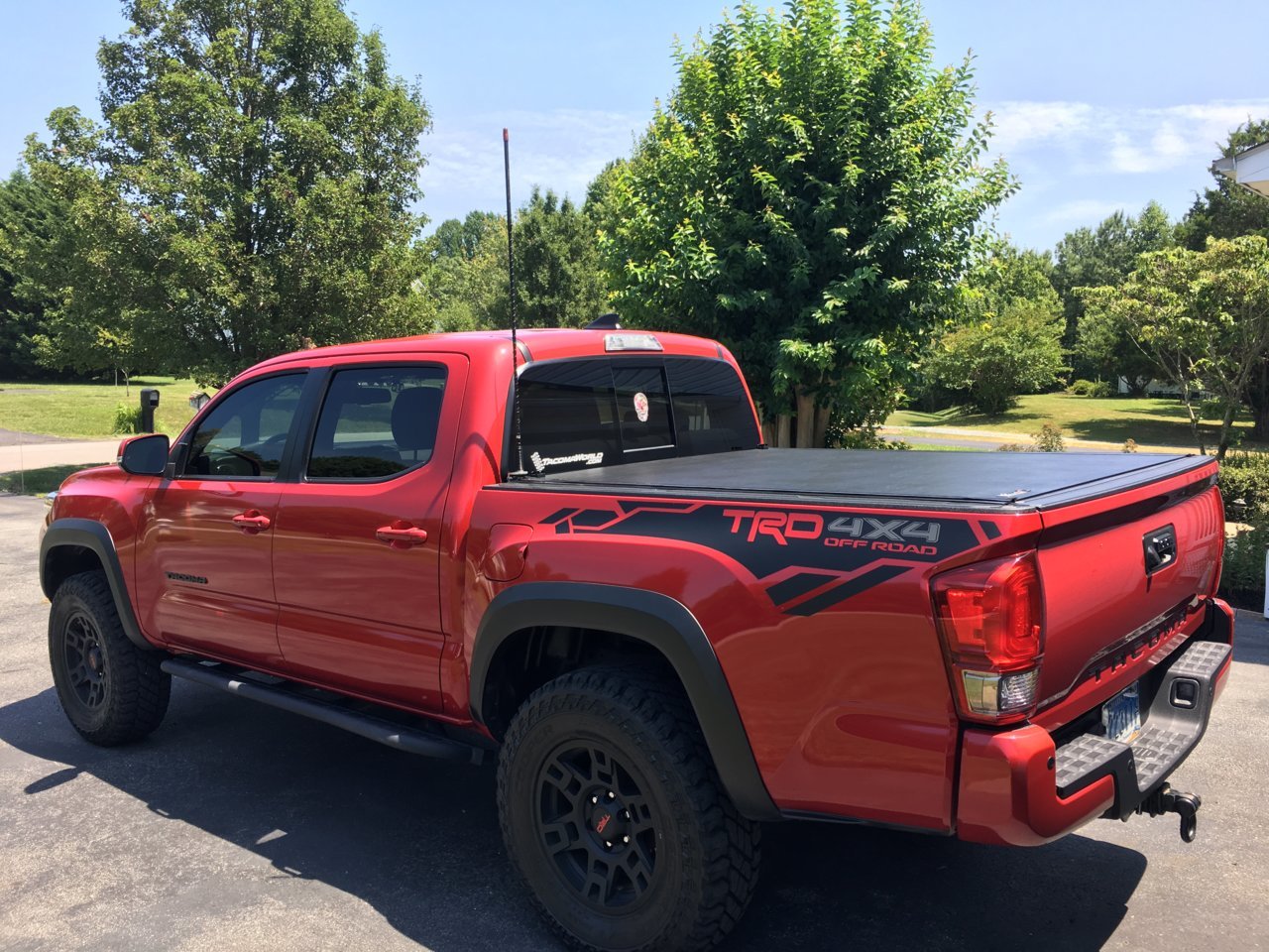

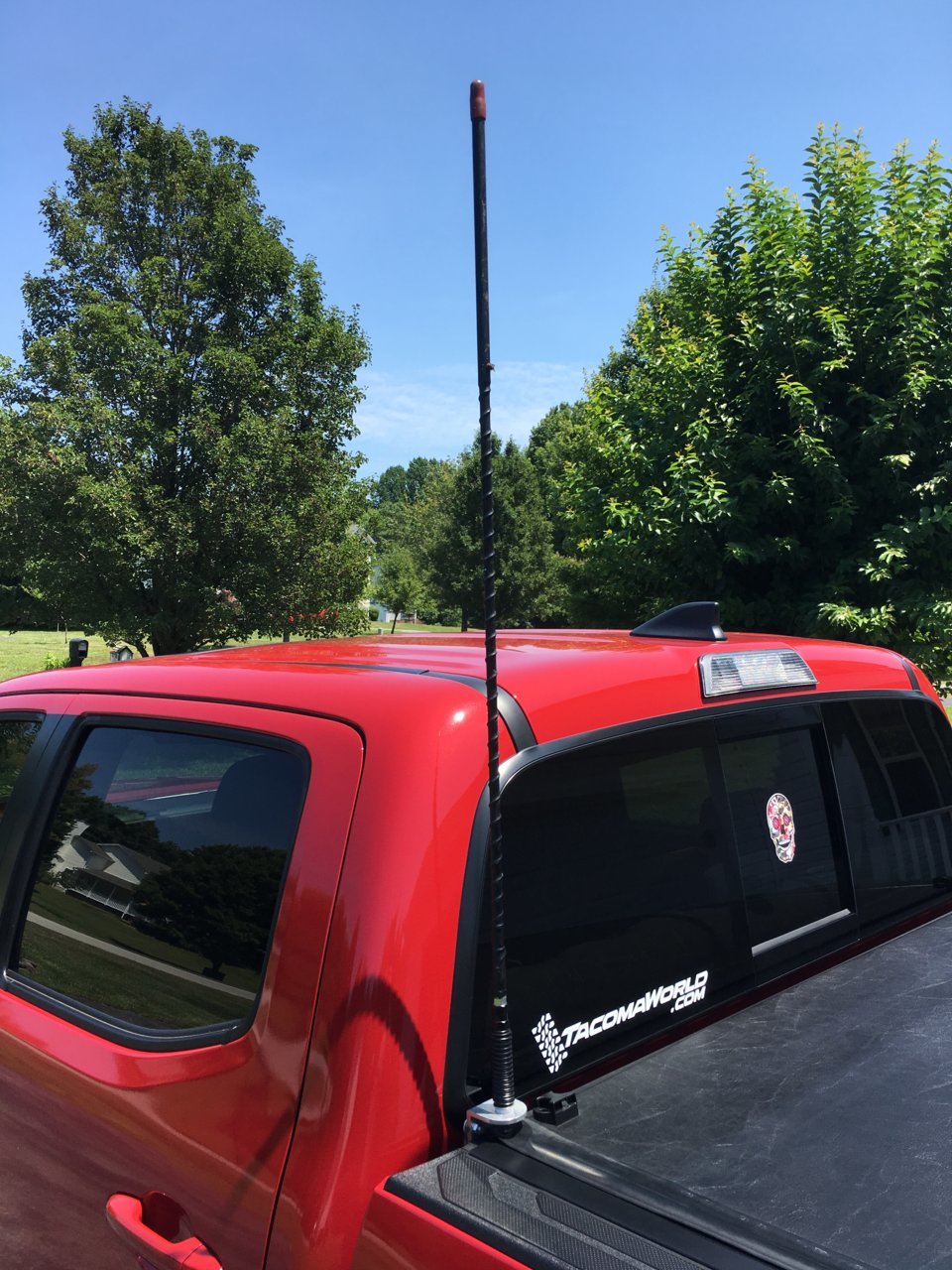

    70D3182C-2288-4320-8F6B-B590AEE701E5.jpg F75E1C9C-99F1-47A9-8C2A-4E5DCAF90F51.jpg AF553A1D-F3DC-4B29-8717-AA1E4659A4E5.jpg

    At some point I am going to paint the mount and the bottom of the antenna black.

    Been doing any serious offroading with it there? I would imagine it hits the truck when your bouncing around good. I know mine moves a good mount.

    You may have said earlier in this thread, but what mount did you use? Really clean install.

    First thing I thought about too. I can see it catching branches and whipping back in the cab. Looks good though.

    An unusually high amount of pinstriping.
    I thought the same thing, although I really like the look of it. It would hurt the look, but one could add a tennis ball to it so that would smack the cab instead of the antenna. Doesn't help the look at all, but I works.

    It has tapped the cab a few times. I have been thinking about just sliding a tennis ball down on it when I am wheeling. As for the mount. I have no clue who makes the mount. I got it for free from a friend that had it, radio and antenna laying around in his garage. I just had to buy the antenna cable. I also bought a new antenna because the free one wasn't tunable.
