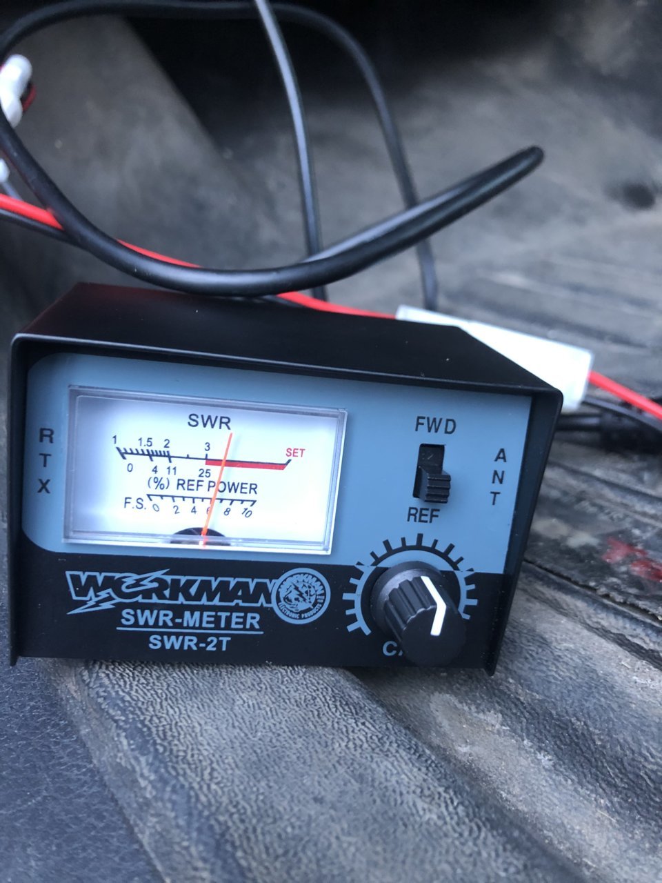

    Installed a uniden cmx760 with a 4ft firestik today but I can’t seem to tune it. I’m getting the same readings on channels 1,20 and 40 after setting the set on fw and switching to ref on the swr meter. Doesn’t matter how much I screw out or in the forestik top piece. Any ideas? I ground off the powder coat on the antenna bracket.

    Try managing your excess cable. If coiled, try making it vertical and not horizontal in its positioning.

    What does your antenna mount look like?

    Perfect, for tuning I’ve been playing with the firestik and right now I have channel 1 not moving from 1 on the meter, 20 the same and 40 at 1.1. Is this good? I feel like it should move a bit for channels 1 & 20.

    I’m using the Rago fab mount, dremeled the powder coat off top and bottom, nylon spacer, washer and lock nut are installed on top in order.

    That is excellent!!! :bowdown: Try X-mitting and get some radio checks now.

    When tuned right, 1 and 40 are close, withe 20 being a little higher. Anything under 1.5 is good. I would leave yours alone.

    You're good.
