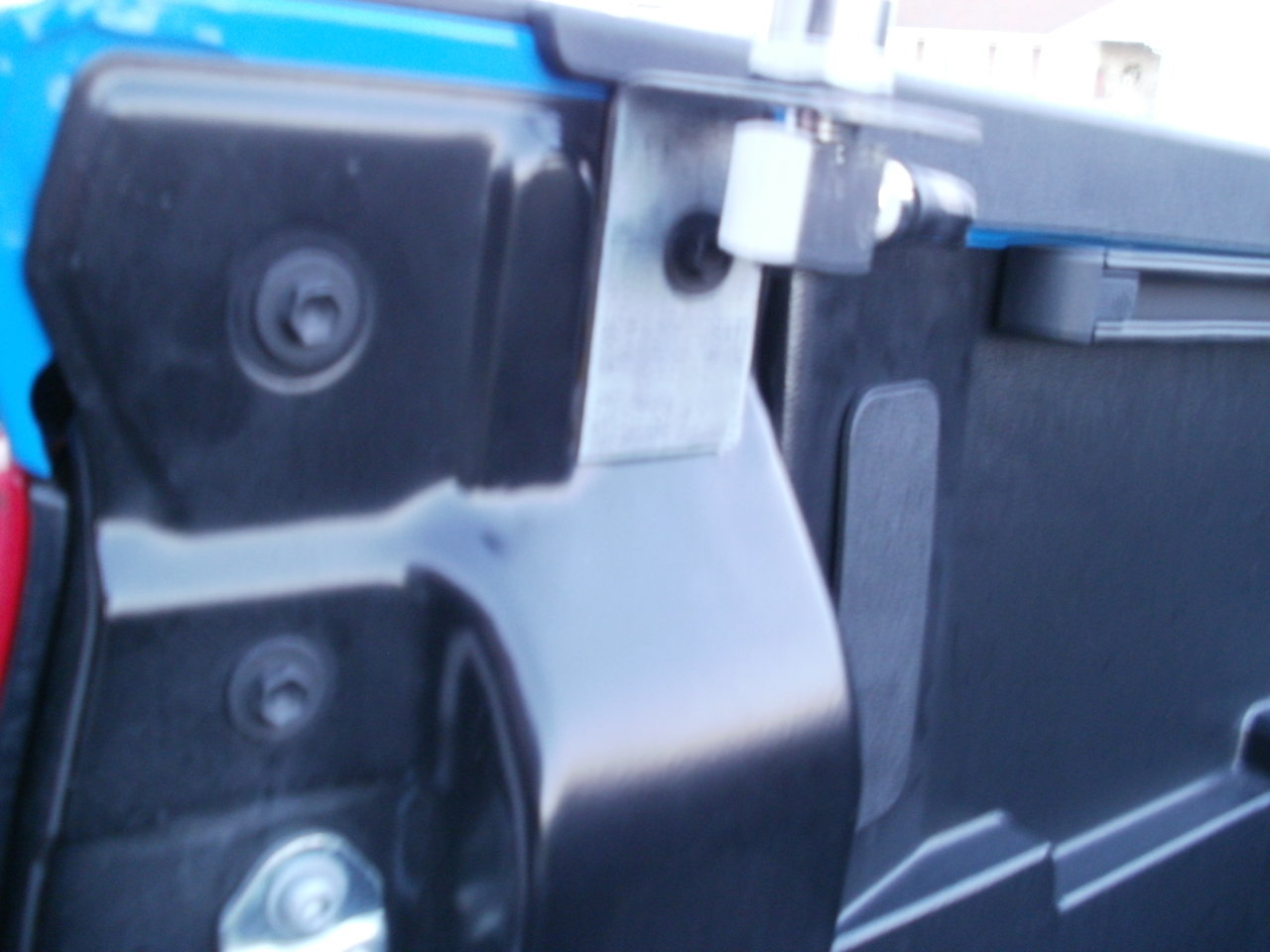

    Hey y'all
    I'm wanting to mount my CB in this location (see pic). Can anybody give solid advice as to where to route the coax cable through to the CB itself?
    I'm skeerd I'm going to muck something up by just drilling a hole where I "Think" its ok.
    Any knowledge is appreciated.

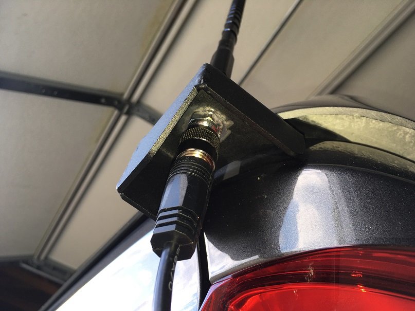

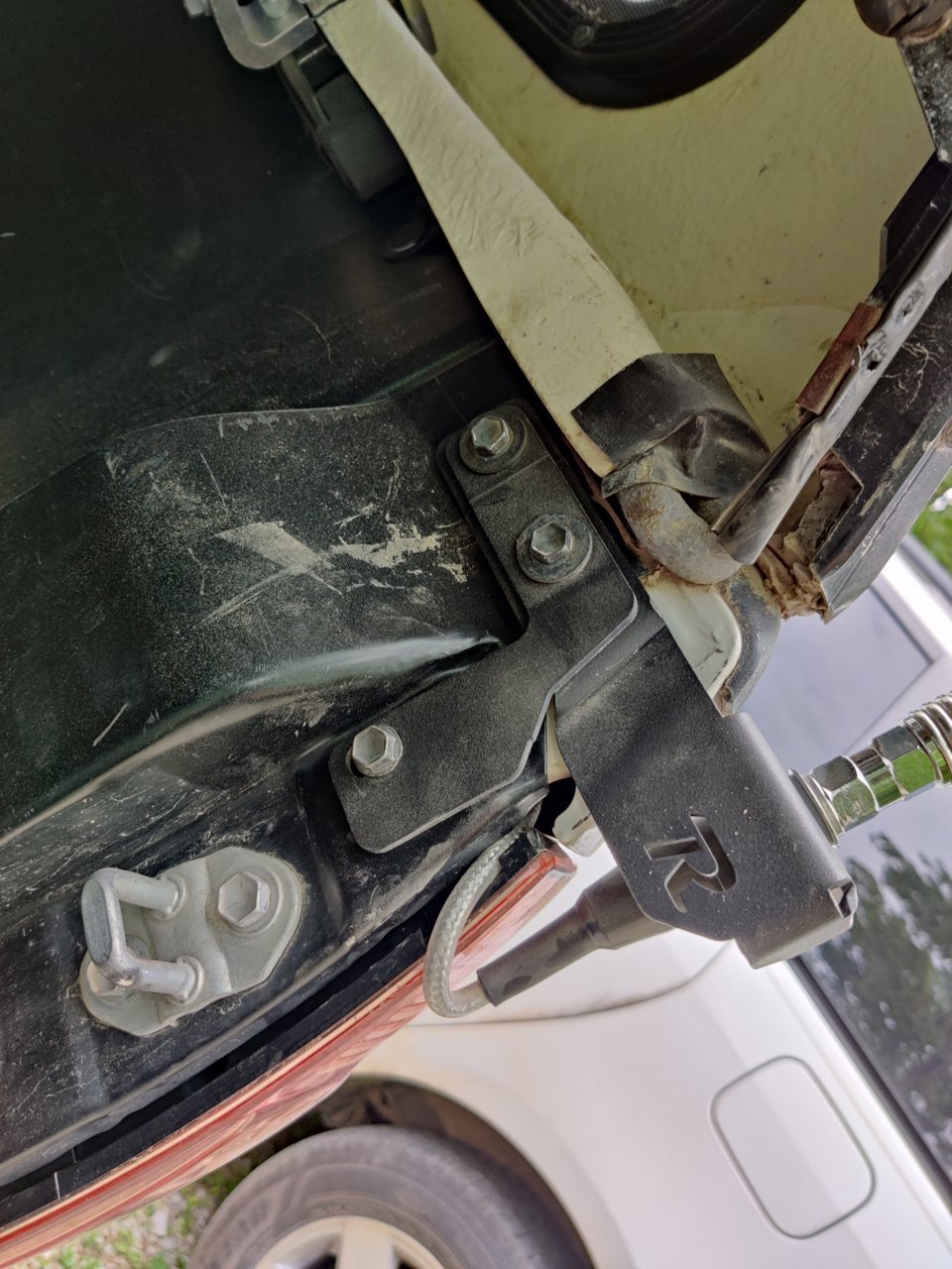

    So I got a bug up my ass to get my CB radio up and running again. I have been having issues with the cold weather cracking my antenna cable and then salt water getting in. After replacing the cable a few times I gave up and tried to figure out a better way to do this.
    So, I got some bulkhead adapters, and I found there is a nice hole on the passenger side. This hole happens to be the same size as the bulkhead adapters! So, now I have my CB cable ran through the truck and into the engine bay where it is hooked up to the bulkhead adapter, I then plug another cable into this adapter in the engine bay and to a antenna. When the outside cable cracks and breaks, its a simple swap out and I dont need to pull up all my carpet to run the new cable.
    Here it is with the waterproof cover over it for when there is no antenna plugged in. I just need to finish up some things and it will be good to go.

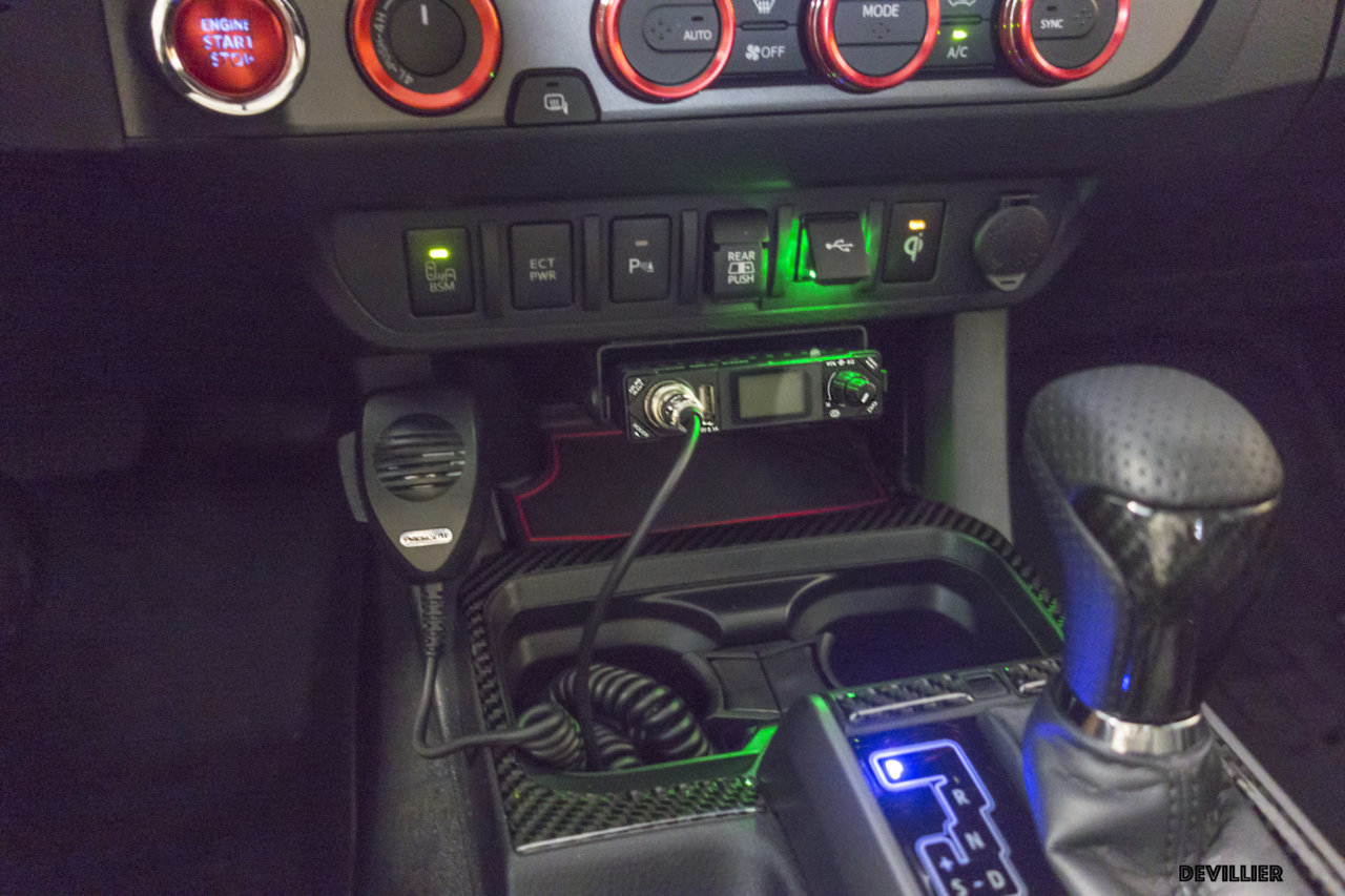

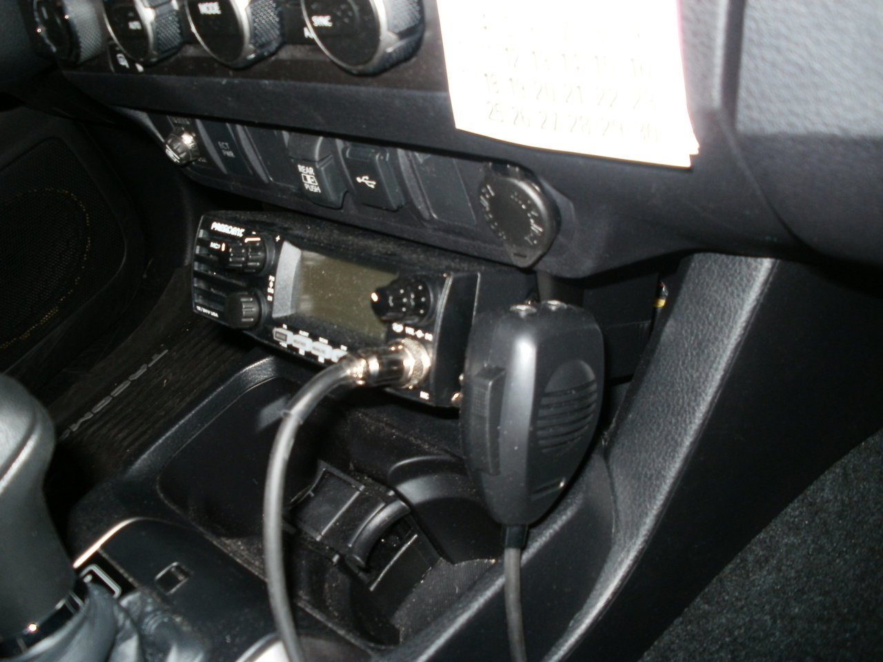

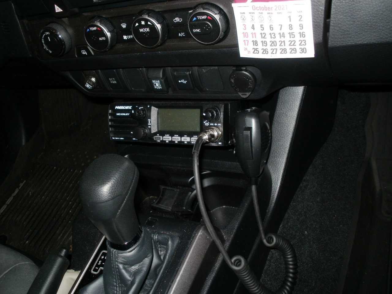

    8
    Finally installed my President McKinley SSB/CB in my 21 Tacoma. Installed in cubby area in front of the front cup holders. Mounted mic holder on right side of radio.
    Mounted a fiberglass antenna inside right rear of bed using a homemade mount using
    ProComm RA930 Right Angle Adaptor With .38 In.x24 Dome Mount
    As installed the internal SWR meter shows 1.4-1.6. When I it warms up and I find an open area I will check with an external SWR meter and try tuning for a lower SWR.
    I have used CB's since mid 70's. I use mainly to monitor highway and road conditions when traveling. This is my first SSB. Not sure needed or will use, but always wanted to try.
    Haven't talked yet but a few days after installing was picking up loud and clear skip transmissions from NWP Nortwest corner of Washington State. I live in Missouri.

    What radio is that? Does it interfere with the cup holders? Looks slick

    President McKinley. An Ozark Trails 32 oz tumbler will fit in left cup holder but leans back a little, will not fit in passenger side cup holder due to mic cord. 16 or 20 oz glasses will fit but, you have to reach around mic cord on passenger side.
