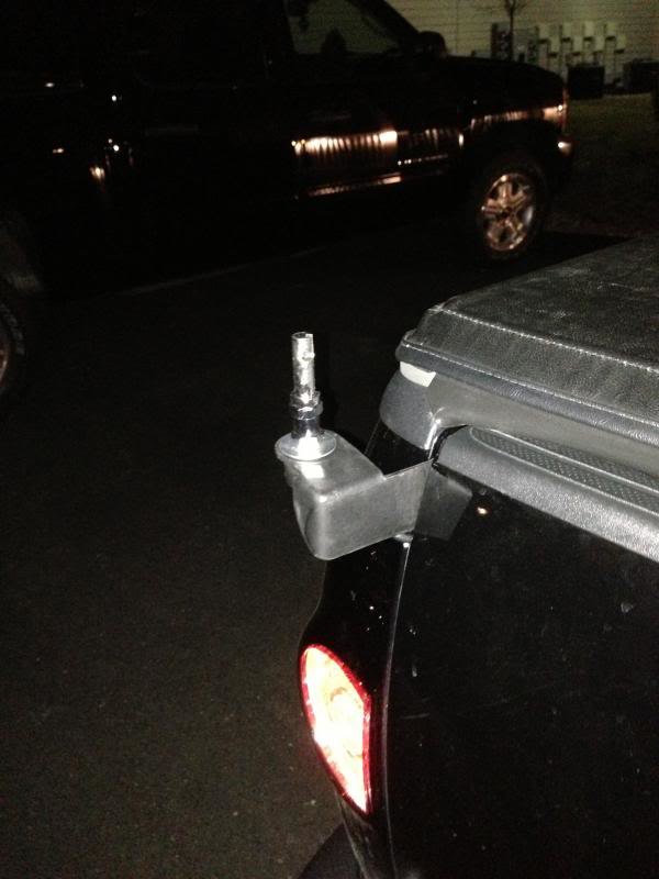

    -Cobra 75 CB
    -4 foot firestik II tuneable antenna
    -Firestik Stainless steel quick release
    -BAMF antenna/flag mount
    -Procomm 18 ft coax with antenna stud.. ring connector.. and removable connector
    all said and done was about $200 for everything shipped
    When im not on a road trip the antenna goes behind the back seats.. and the CB also goes behind the back seats in a storage compartment. I'll get day light pictures next nice day.. also going to tune it tomorrow. havent transmitted yet but reception is fantastic even untuned.

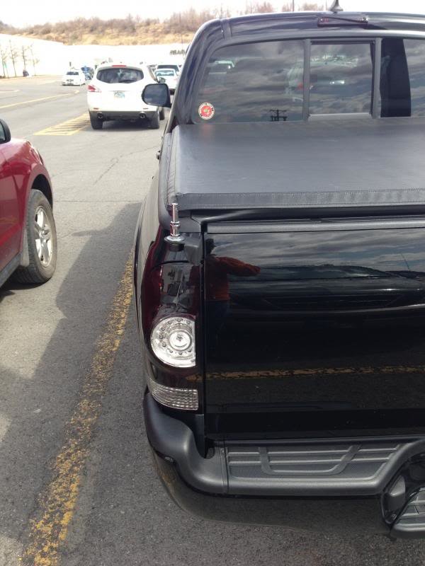

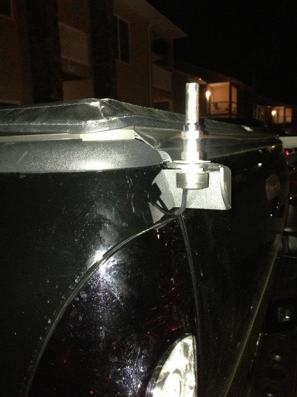

    I got power for the CB from the cig lighter (had to take most the dash apart to get behind that dumb thing).. ran the coax up under the driver seat then under the carpet to the console... took out the seat made it much easier. The BAMF mount hit the gate.. took a lot of heating/beated to get it to fit and clear the bed side and gate while holding the antenna level/straight. wish i didnt pay for the powder coat since i had to repaint it anyway. This set up will also work nice with my bestop supertop on this summer.

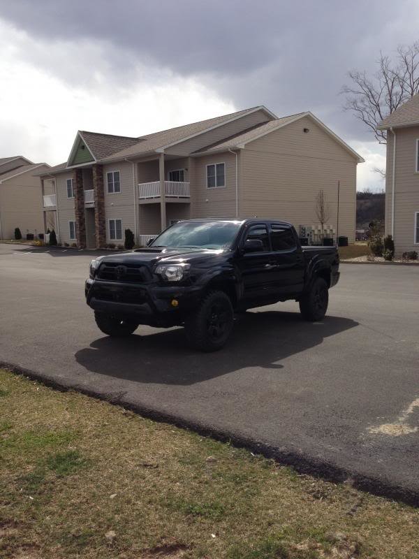

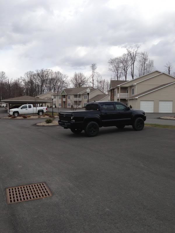

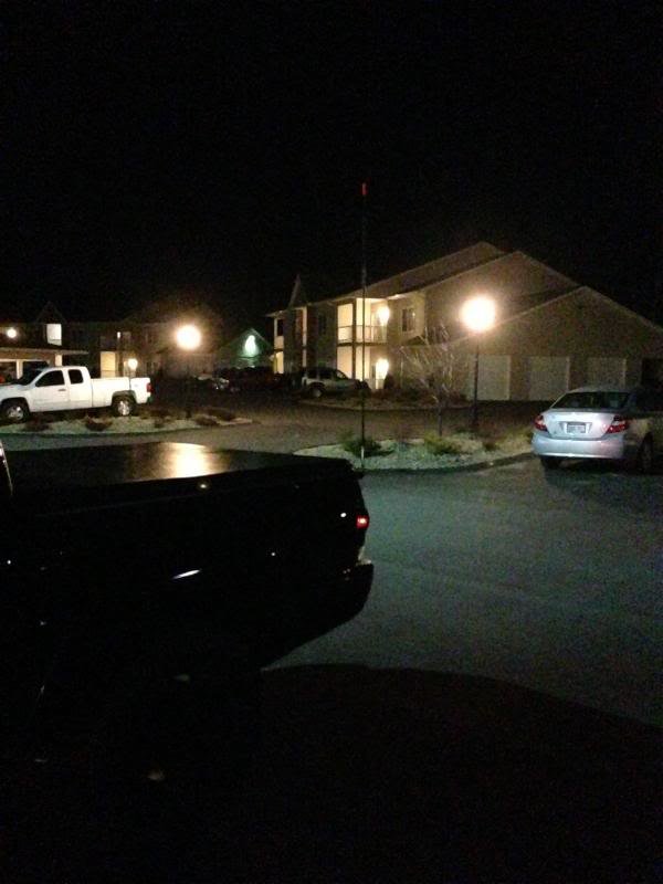

    got it tuned today. didnt mess with the antenna at all.. straight from how it came from firestik we got a 1.1 SWR on chan 1 and 1.2 SWR on chan 40. really happy with the results. transmits crystal clear and receives great.

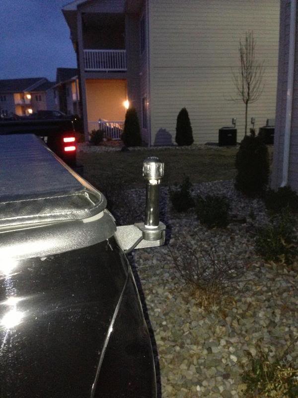

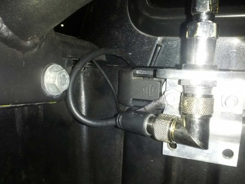

    i also made a cover/cap to go over the quick disconnect when the antenna is off. just used a piece of 5/8 inside diameter clear plastic pipe.. a brass insert into the tube and a plastic cap threaded on that. gave it a light coat of black to blend in. it worked perfectly to go over the 16mm hex at the bottom.
    few daytime pics

    just an update on this CB set up. It worked flawlessly for my 1200 mile road trip. I was able to transmit and receive at least 13 miles away at one point (could've been further didnt try.. that was based on mile markers). Talking over it 13 miles away was crystal clear both transmitting and receiving. couldnt be happier with this set up and i strongly suggest it to anyone looking for a CB

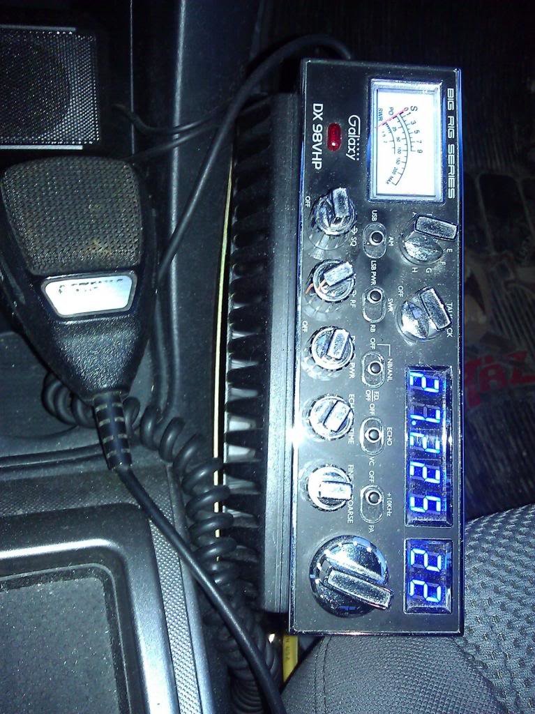

    WP_000066_zps1434d015_a7f7254a7426f9458e2a6fb01622756248578ced.jpgWP_000065_zps6d3514b4_cdfb46349258073665bb8d4b600288e679410f14.jpg[​IMG]WP_000056_zps4ec5b572_e6c2fd8b244a6e774aa4c7cc9e4529516cadde7a.jpg
    Galaxy dx 98vhp with willson 5000 antenna 600 amp battery under the seat for the built in amplifier 4 to 300 watts.

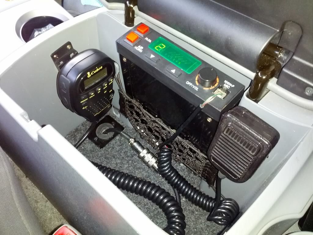

    i got mine put under neath the driver seat it works pretty good

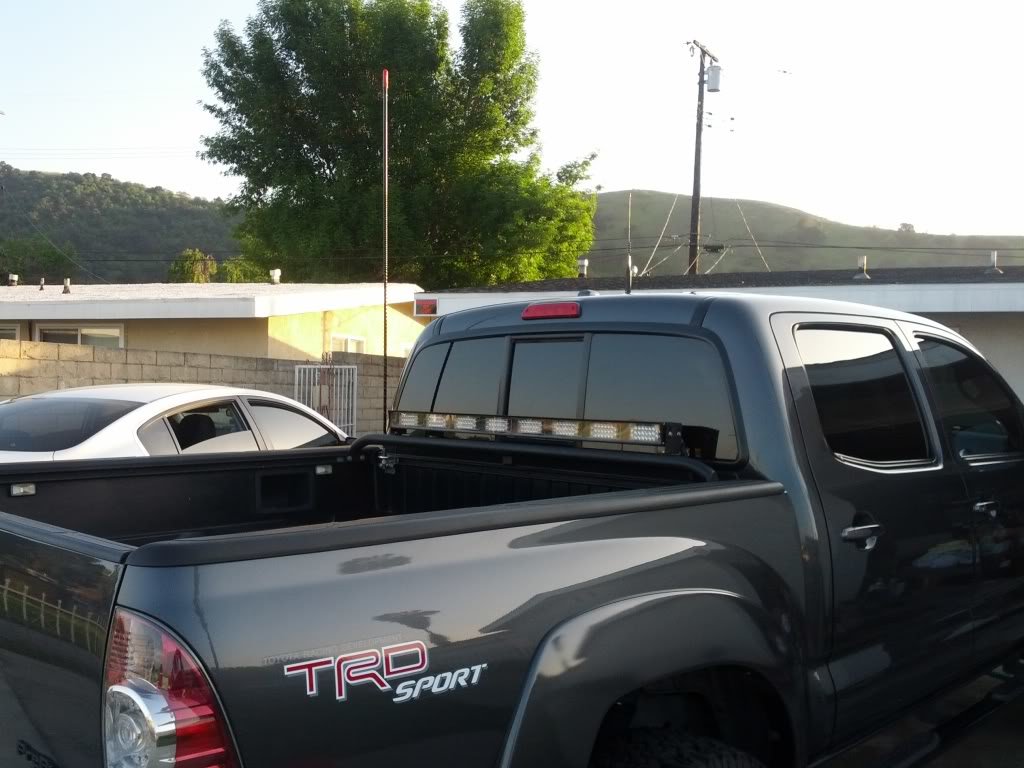

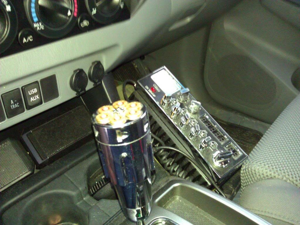

    Did the same but mine is in the center console. With a 4' firestik also but tomorrow I'm installing a 3' instead. My swr with the 4' was 1.2 on 1 and 1.3 on 40 and 1.0 on 19. I'm sure it'll still be below 1.5 with the 3' antenna.

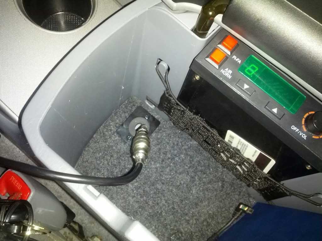

    Bit of a thread revival, but I'm looking to put together a similar setup.
    OP, did the connection in the console there come with the Cobra or was that something extra you had to buy?
