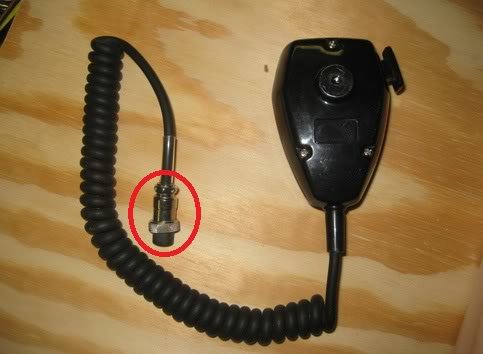

    i had that issue with mine. i had to re-sodder a wire in the handle plug in.

    the mic? that you talk into? because that is already in
    where is the handle plug in?

    im ment to say mic. not handle. sry. handle is slang for something else.... forgot.
    i disassembled the part where i circled in red. there was a blue wire that had come loose. i re-soddered it and fixed it up

    and that made...the internal speaker louder?

    idk what the mic has anything to do with the amount of speaker volume output. but once i fixed that wire the volume was good as new.

    yea. the internal speaker volume with almost absent. it was so quiet i had to lean in all the way up to the unit to hear anything at all.

    ok, great. ill give it a try
    thats exactly the way mine is
